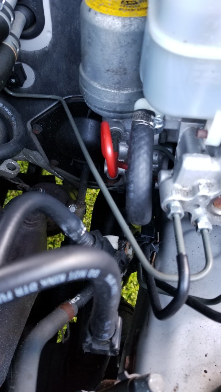

    pic of the hose you are replacing?

  5. Jun 28, 2019 at 5:13 PM
    Corrosionguy
    Corrosionguy [OP] Member
    Jun 27, 2019
    #297678
    8
    Brad
    2009 Tacoma
    This is the hose I put on temporarily(where you see the hose clamps), I put the factory one back on.
