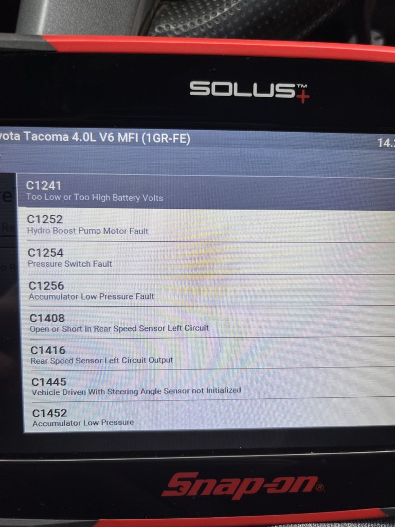

    I finally got my hands in a scanner. Took a picture of the codes. Do all these just mean that it’s the Rear speed sensor on the left? Or is there something else wrong too?

    I have the same. It means the rear speed sensor is not sending signal, or being read properly. Toyota told me the sensor had a short. I replaced the sensor and the wires, but nothing was solved.
    Your ABS and traction control will not function in this condition. I don't really care about either, but the lights do bother me. Not enough to dig deeper though. Its been like this for at least 5 years, maybe 7? Meh

    Looks like a possible power/ground issue to the module or a module failure. Did you clear them and see if they all come back?

    @Dm93 I did and they came back on. I was going to replace the rear sensor tomorrow. How easy is the module to work on?

    I replaced the ABS sensor and unplugged the battery for an hour. Turned it on and the lights are still on. Do I need to clear the codes or is it for sure the module now.

    ABS codes can't be manually cleared, at least not without a special tool. Drive it a bit and see if the lights go out.
