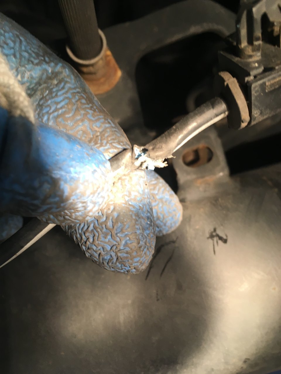

    I fired up Techstream and checked the code in the ABS module, but I have a different code from the one in that thread. I'm getting "C1408 Open or Short in Rear Speed Sensor LH Circuit". Can someone confirm if the same troubleshooting steps apply to this code? :fingerscrossed:

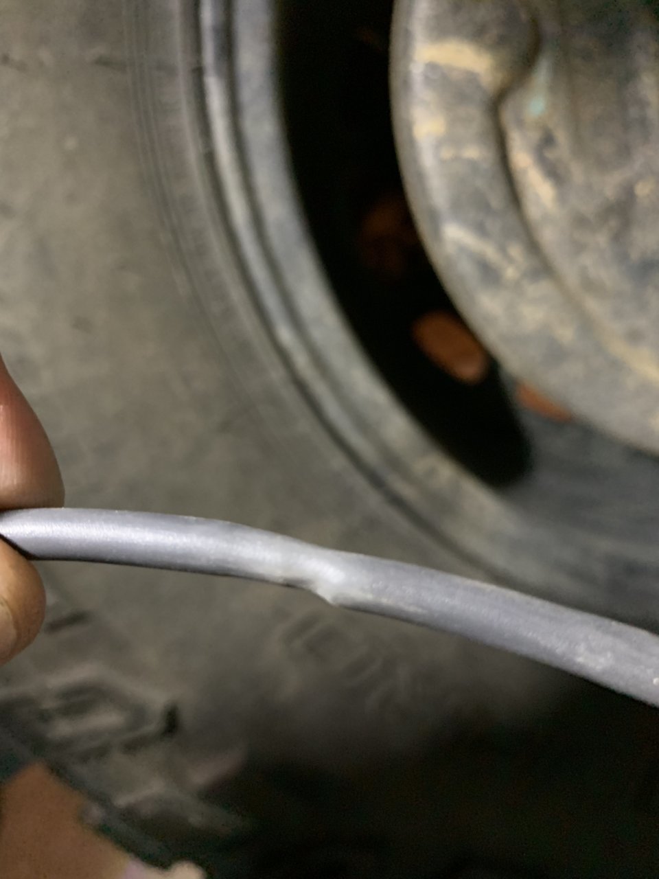

    I had this exact same scenario on my 2015. Same code and everything. tow truck driver damaged the left rear speed sensor wire when he was securing my truck to the flatbed. I crawled under mine and found a section of wire flattened/crushed. i cut out the damaged section and spliced in a temporary patch till my new harness get here. I ordered a new harness from partsgeek.com which was around $70 after shipping. My insurance adjuster is reimbursing me the cost of the harness just because she knows it almost impossible to get the tow company to fess up to stuff like that.

    That’s all it takes to damage that wire and cause those lights to come on.

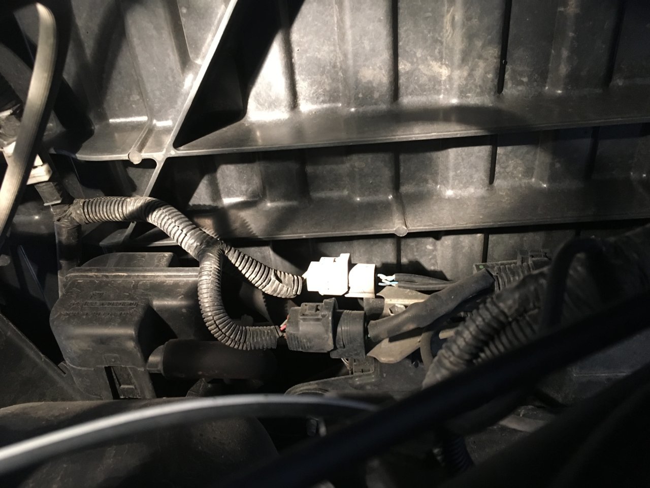

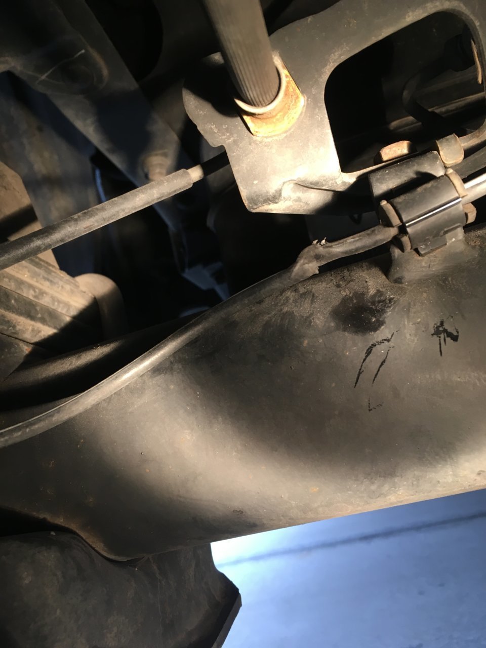

    Good news it I found the problem. Band news is it was likely a flatbed neanderthal. In the third pic, I'm guessing the white plug is where the rear speed sensors plug in? So I'm guessing both sides are part of one harness?

    Yep, just as I suspected. Tell the insurance company and let them deal with it.

    Pics sent to insurance company with the explanation that it looks like it was damaged during towing.

    Yep they are the same harness and that white plug is where the left and right wires come together and attach to the main harness.

    Glad you found my thread on what my issue was. As I was reading your thread I was going to suggest you swap the sensor from one side to the other to see if it throws a different code, but as I kept reading and from seeing your pictures, you found you issue. :fingerscrossed: Insurance doesn't give you any grief as that definitely looks like damage from the tow truck. If not, the replacement of the harness is not too hard. Just time and money with minimal tools. :thumbsup:
