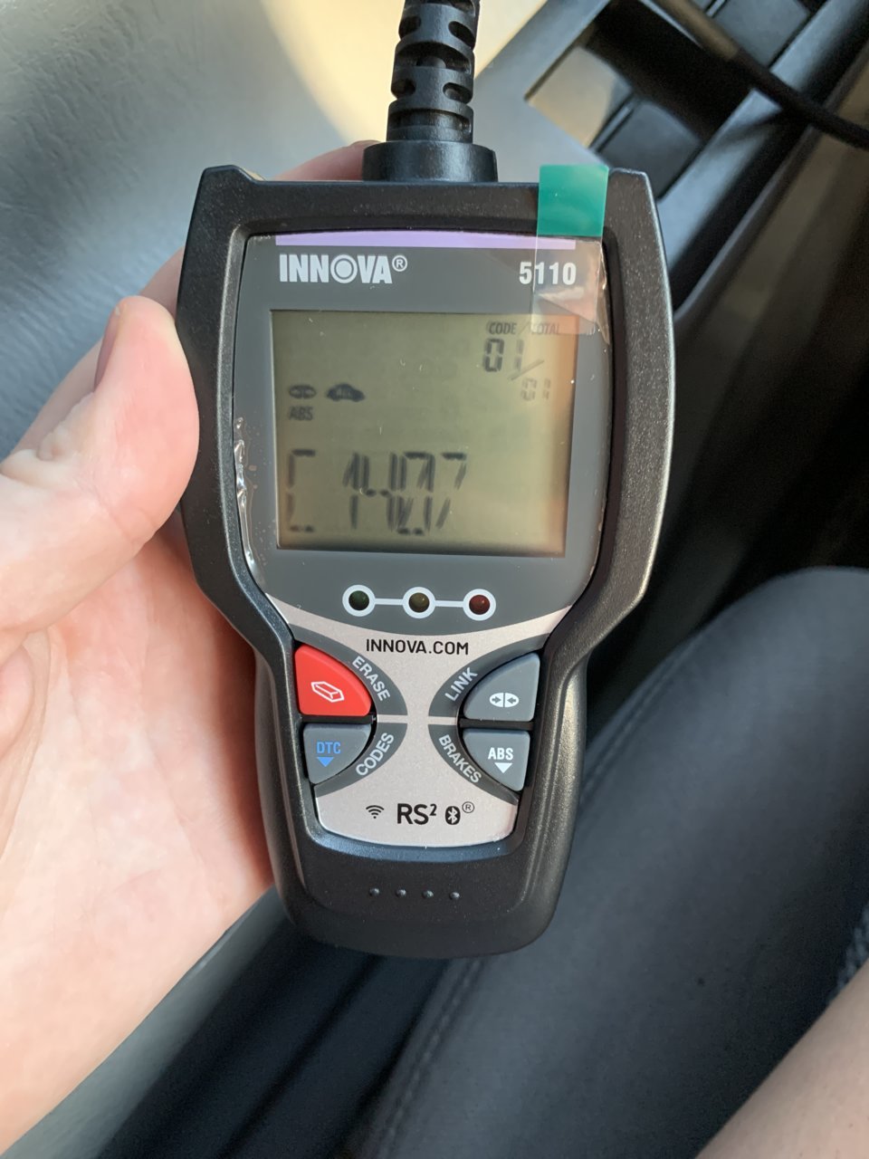

    Not saying this is what it is but it is very easy to stretch the wiring on the sensors.
    FYI, the codes don’t self clear.
    Hard to believe all 4 would go out at once.
    I would copy then clear the codes then read them immediately when the light turns on again.
    Does your speedo still work ?

    Ok, thank you. I’ll try clearing the codes. I agree, how likely is it that they all go back at the same time.
    speedo works. Truck isn’t having any other problems

    Cleared all codes and now only the one shows. I’ll replace that sensor and see if it fixes the problem!

    Well... no luck with changing the sensor for the code it called for. It still calls for the same code. :/ I guess tonight I’ll trace all wires and see if I can find anything

    You didn’t change the wiring?
    We have had issues with the wiring from the sensor to the block above by the canister.
    And there are issues when replacing as it can create a issue at the connector itself.
    So we have been burned a few times so we change the sensor and wiring at the same time.
    I thought I had mentioned it but apparently I didn’t and I apologize.
