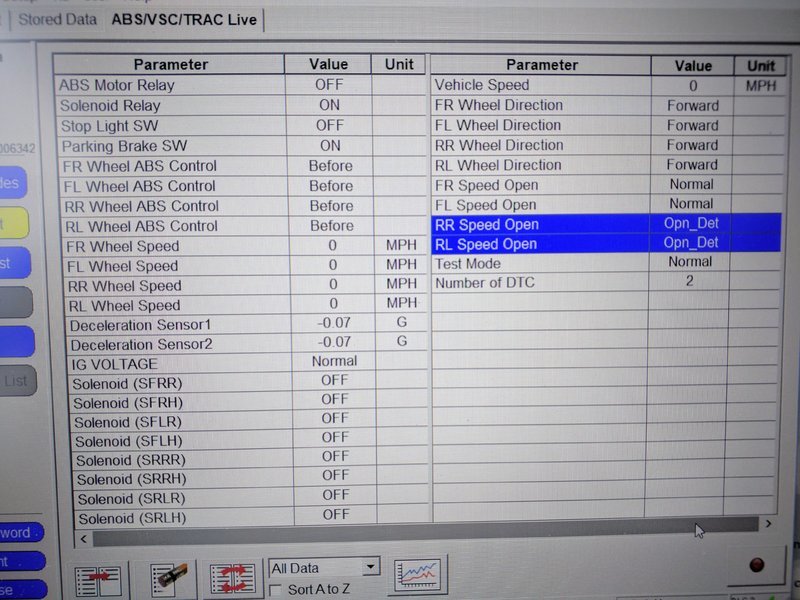

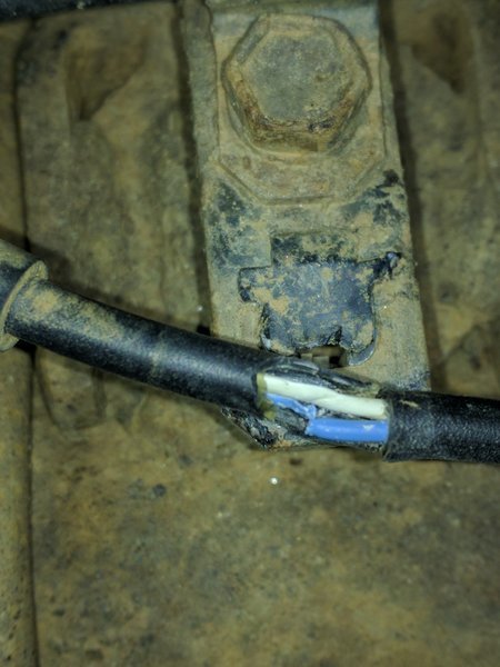

    That's the type of scanner I thought you bought. As you found out it will not read ABS, TPMS, and Airbag computers. As mentioned other high dollar scanners will but so will an Amazon/Ebay option if you are a little bit computer savvy, Toyota TIS Techstream knockoff. It is widely available with an OBD-usb cable and a disc with the software. Here's a shot of it, I was just checking my ABS code. A branch or something jumped up and caught my RR line and broke the plastic clip that held it to the axle. In doing so it tore the wires inside. The outer insulation is pretty much cut proof, but it does stretch a lot, the wires inside not so much.
    This is the live ABS data view

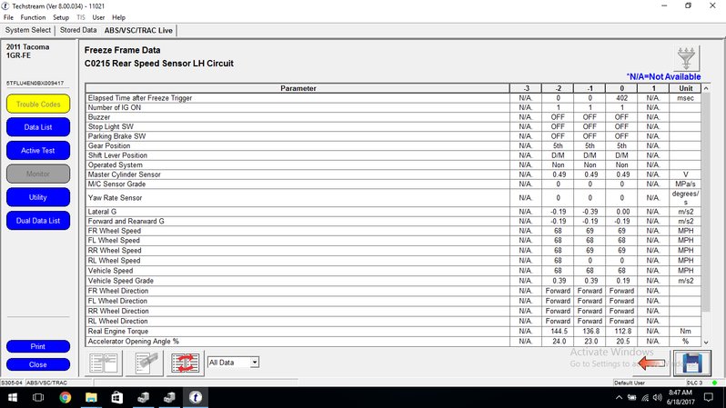

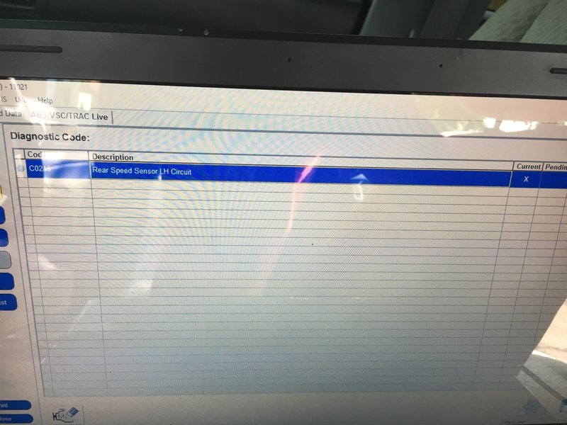

    Alright, looks like I found my wheel speed sensor that is bad.
    I've attached a picture I took from my phone of the laptop screen via TechStream. Below is what it stated on screen if it's hard to read:
    Code: C0215
    Description: Rear Speed Sensor LH Circuit
    Apologize for this next question but when it states LH, is that my rear wheel speed sensor on my passenger side? Or is it viewed from the drivers seat so "driver's side" rear wheel speed sensor?

    Took another screen shot actually from the laptop this time and it appears its the Rear Left wheel speed sensor. The Values RL Wheel Speed are reading 0 for two blocks compared to the other 3 Wheel Speed sensors that are showing a value of 68 or 69.

    Awesome, glad you got it up and running. It's as you sit in the driver's seat.
