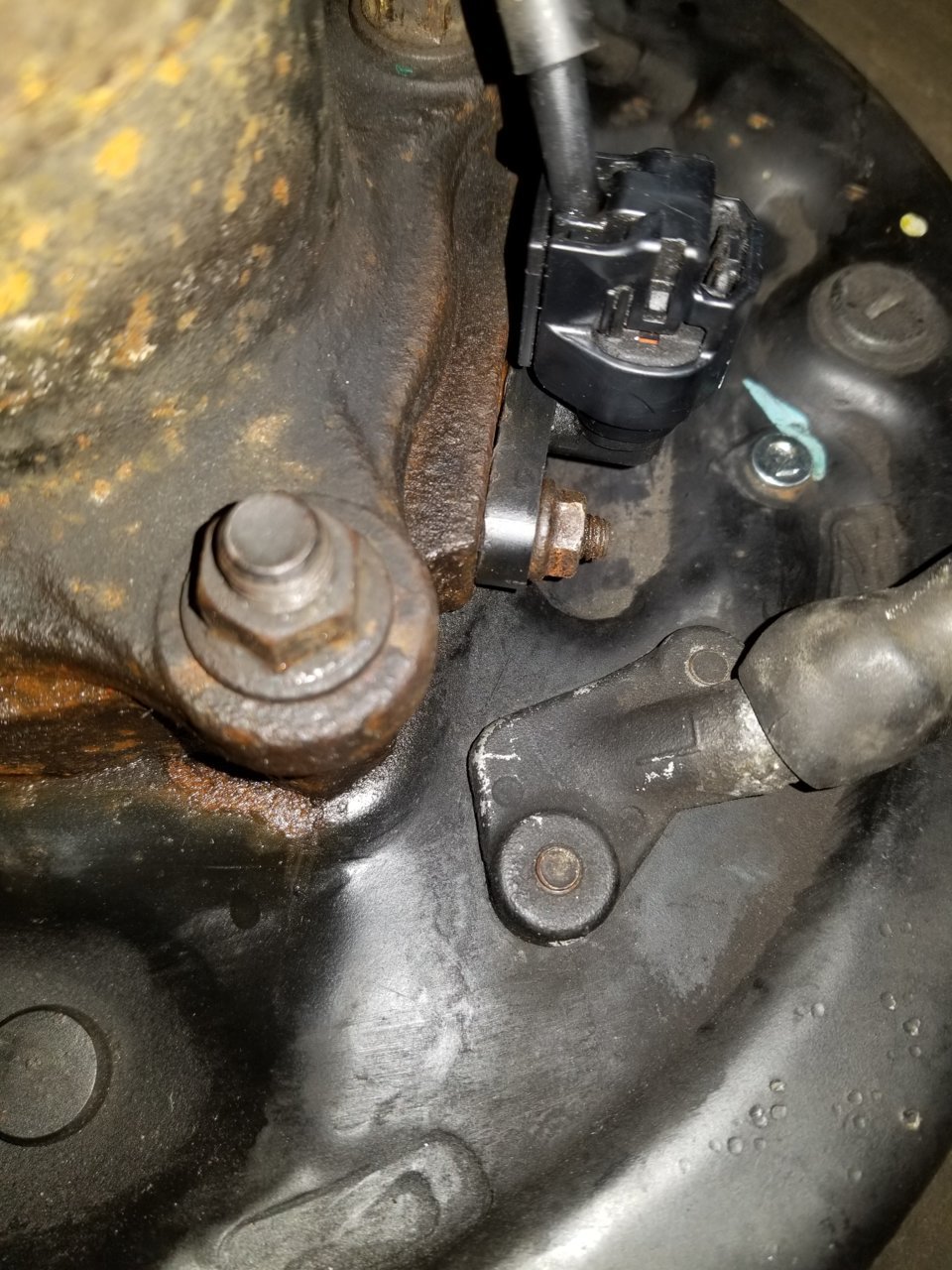

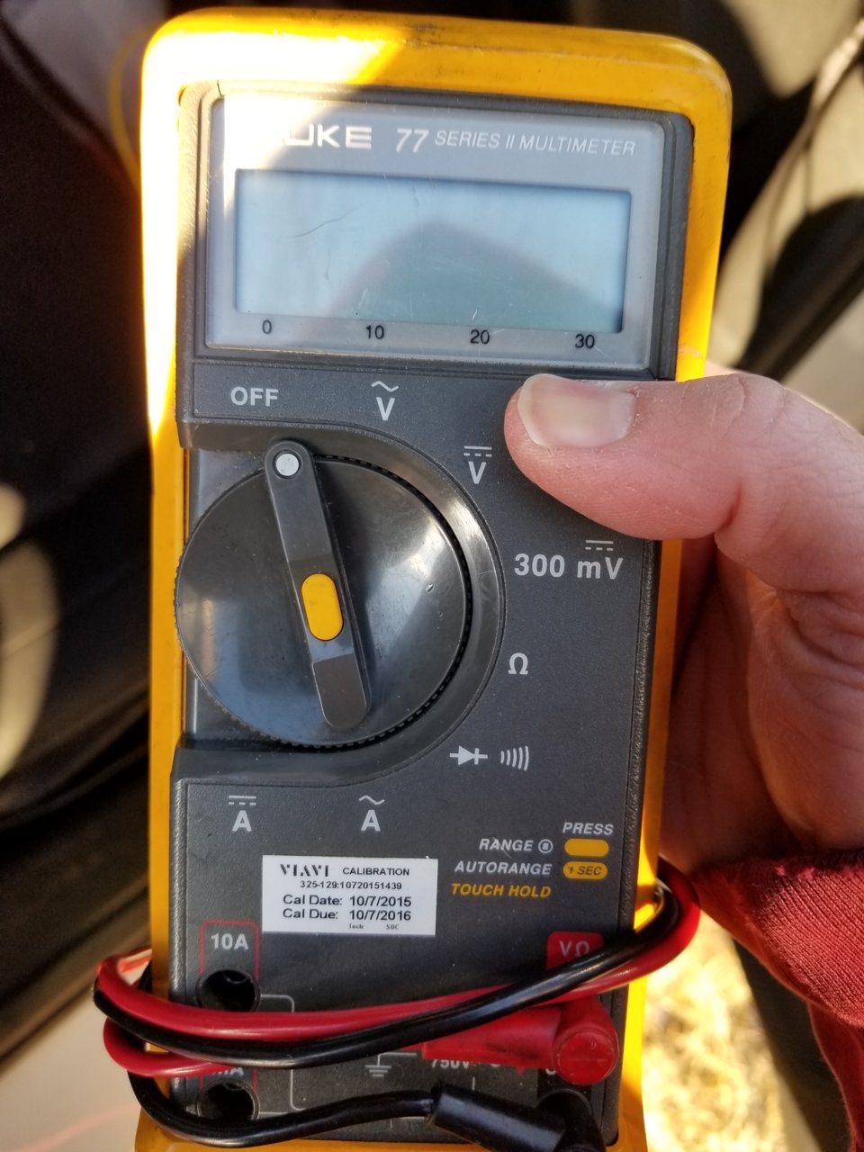

    Hey all.. im having the same problem. Getting a 39 code showing rear driver sensor issue. I removed and cleaned the sensor but when reinstalling it doesnt go flush? Also could anyone please tell this fool how to set this multimeter to check voltage at the connector for the rear sensor? Thank you for your help. Im hoping this isnt a nightmare fix.20190226_163712.jpg

    V with the straight line above it is for DC voltage. Did you tighten the sensor down or just try to press it in flush? Make sure the o-ring didn’t hang up.

    Thank you. I tightened it down but there is still a space. I couldnt get a reading from the harness that plugs into the sensor itself with the ignition on. Does the truck need to be running?20190226_175354.jpg

    I don't remember if the truck had to be running or not, sorry. It certainly wouldn't hurt to have it running and check again. You should be reading around 10-11 VDC. Not sure if you sprayed PB Blaster or something similar to remove the bolts on the sensor, but it does look like you have some seepage on the backplate at the hub, that might be an indicator of a leaking seal. The bearing was shot on my truck and the seal was leaking just enough that it created this black graphite looking grease that was all over the sensor. I ended up having the bearings/seals replaced on both sides.

    Yeah, I had a leaking axle seal that we just fixed on Saturday. Immediately after putting everything back together and driving a few hundred feet, all of the brake lights came on. I'm wondering if goop washed into where the sensor reads from, or if the harness that plugs into the sensor was damaged...

    If you have any crap in the tone ring it could interrupt the signal to the sensor which would throw the code. Did you check again to see if you're getting voltage at the connector, if not that's probably where your problem is. Did you overextend/stretch that cable?

    I didnt get a chance to get back out tonight. Ill check the connector again tomorrow, this time trying with a probe in each of the connector holes, last time i tried using the body to ground. I do not think the connector was stretched but the tab was broken upon removal so something definitely could have been jarred loose. However the 39 code points to debris on the sensor, which seems strange to me if the connector wire was busted. I can also try cleaning the tone ring somehow..
