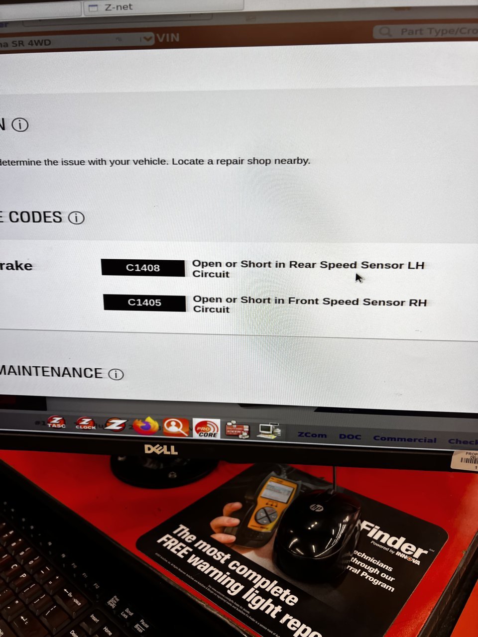

    Was wondering if you guys could help me out.
    Today while driving home (it was raining) I got the check anti-lock brake system, check brake system and abs warning lights.
    Took it to autozone to get it scanned and I got this codes86CB2FD4-7D92-4050-ACDF-FC327838FC03.jpg
    What I found weird is that I got the codes at the same time and as you can see they are on opposite sides.
    Any help will be greatly appreciated.
    If it makes any difference it’s a 3rd gen Tacoma, I did a visual inspection and the cables seem to be okay.

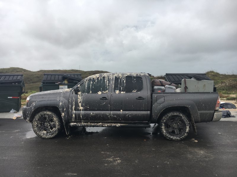

    That truck looks like it was stuck on Midway Island and all the seagulls thought your truck was public enemy #1.
