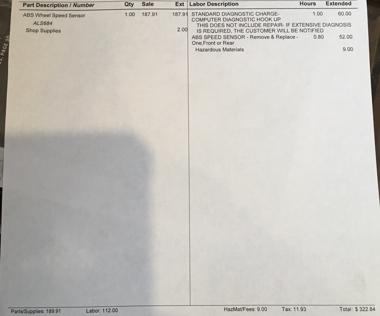

    Finally, gave up and took my taco to the shop today. They say it is the rear right abs speed sensor that shorted out. How the hell could it shorted out? I asked if it was corroded. He said it wasnt. Estimate for parts and labor is $322. Hopefully everything will be fine after this.

    If you haven't done this already and have time I can get this part for around $50. Just might take a week or more to get it to you.
