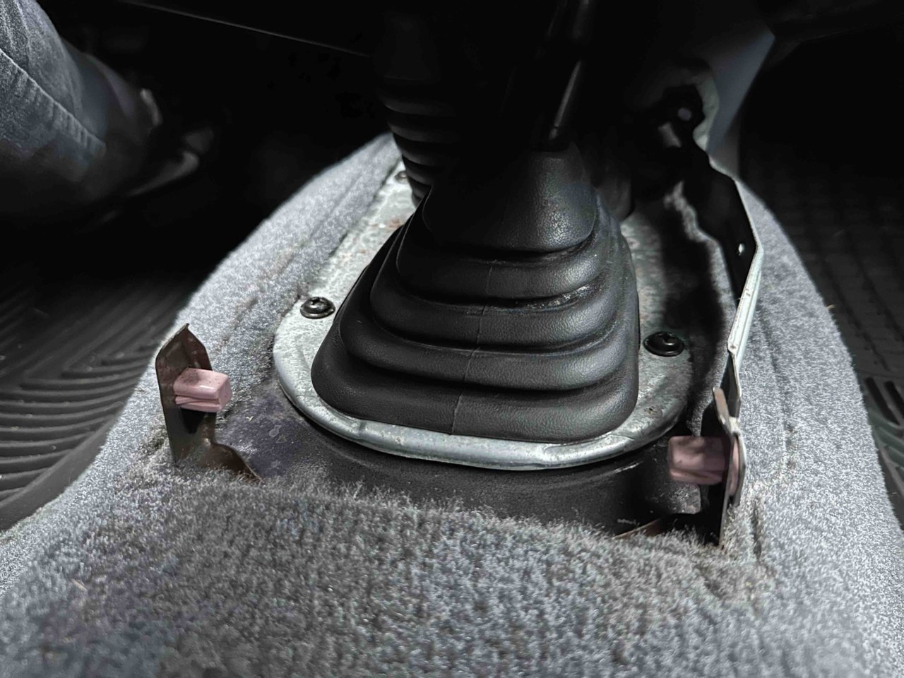

    It’s under the center console next to the shifter.
    See here - https://www.tacomaworld.com/threads/1st-gen-deceleration-sensor-location.178644/#post-24901947

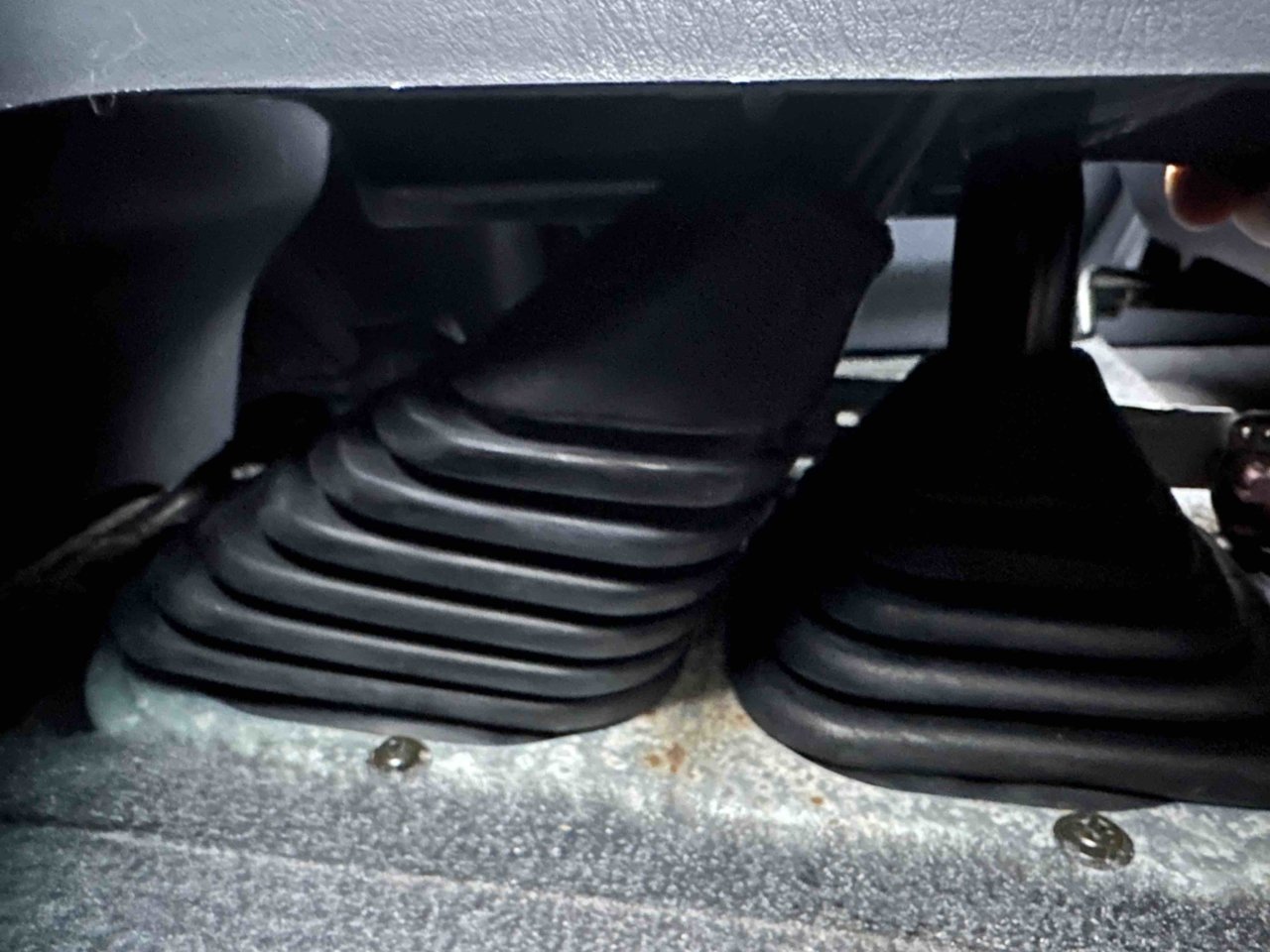

    I found the sensor. It is right next to the brake pedal shaft going into the booster. It just didn't look like any of the images I saw online. Trying to find the testing procedure for it now. If anyone is able to locate how to test the sensor in a FSM that would be amazing if you could share.

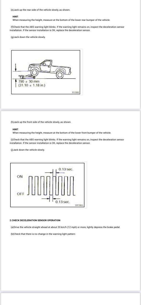

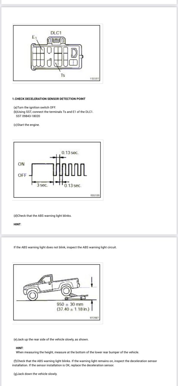

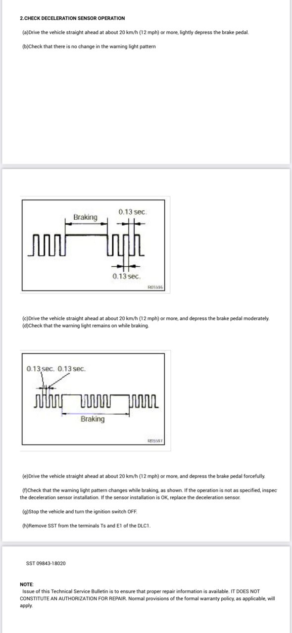

    Updating the thread. It seems that the sensor is working OK at least on the bench test. Here is what I have done so far.
    1. Completed the continuity test of the sensor at the specified angles (per the service manual) and the sensor passed all bench tests. This means that it is turning on/off when it should at the appropriate angles.
    2. Found a TSB from Canada (CAN-TSB0661) which gives you instructions to put the car in diagnostic mode then you are supposed to tilt the car forward and backward and the sensor is supposed to turn off the blinking ABS light which mine did not. So it failed this test. This tells me that the ABS ECU is not reading the voltage that is coming from the sensor.
    3. I checked the actual plug that goes into the ABS sensor and it had voltage supplied at the plug at both power inputs. So the sensor is getting power and the ground wire is connected also.
    4. Once I discovered this I jumped one of the power wires to the ground which should shut the ABS light off (per the TSB) since this would create the same condition as tilting the car up but nothing happened.
    I am starting to think that the most likely thing that is wrong is the ABS ECU. I just had it rebuilt by module masters so I wouldn't think that would be the issue but all the testing makes it seem like that is the case.

    The ABS was fine for about 2 weeks then this code popped on. I would go to the speed sensors but since the deceleration sensor doesn’t pass the TSB testing to me it’s pretty much gotta be the sensor or ECU. See the attached TSB. When I do the speed test (applying the brakes at different forces) it does not behave how the TSB outlines. There is no change in the blinking ABS light.

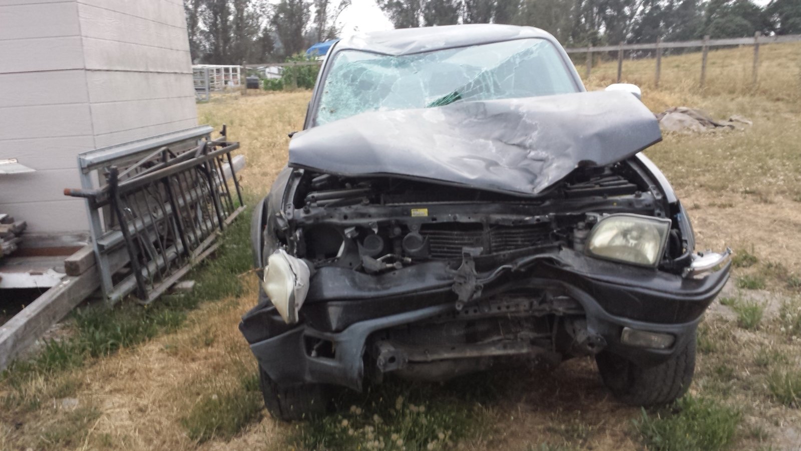

    This is how mine came to me so it has plenty reason for Decel sensor fail, but it's been 10000 miles across the country since repair code free.
