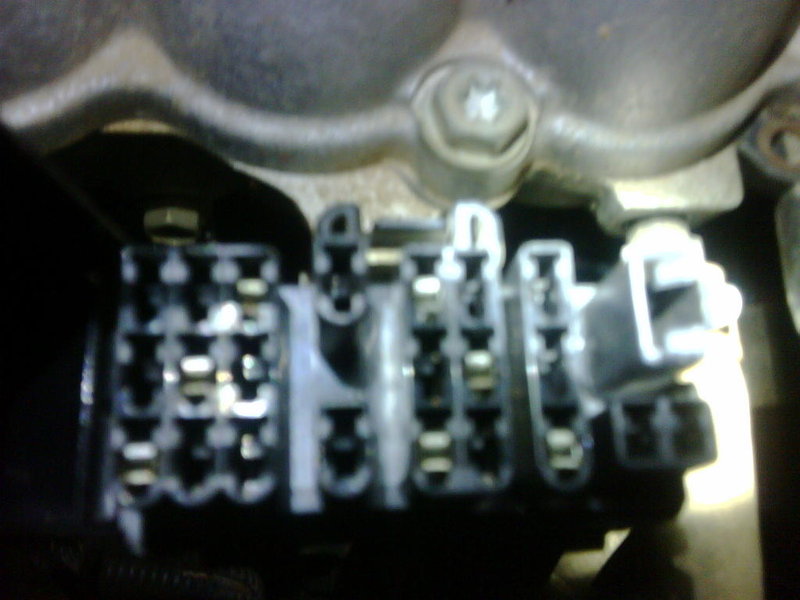

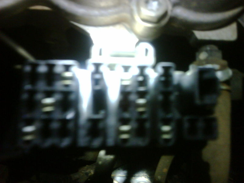

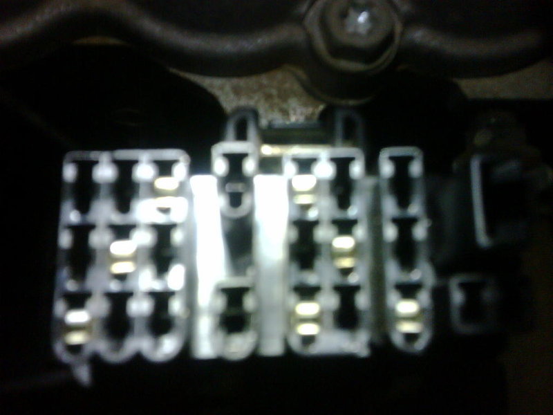

    Sorry for the picture quality on these pictures, it was night time and all I had was my camera phone.
    Would you mind looking and seeing if I have that short pin you are talking about?

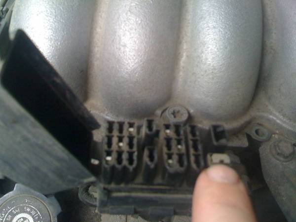

    here is where mine is if you dont have one you may have to go to the dealer and have them clear it.
    [/url][/IMG]

    Big Dog, I appreciate you showing me that picture. Is your Tacoma a 1996? Is that pin just a metal pin?
    I wonder if there is a difference between the 1996 & 1998 in regards to clearing out the ABS codes?
  15. Jul 8, 2010 at 5:45 PM
    biggdog747
    biggdog747 Well-Known Member
    Mar 7, 2010
    #32729
    57
    MI
    taco
    yes mine is a 96 and yes it is a metal pin. no there not a difference i worked on toyotas for 6 year and still have access to TIS which is what the dealer uses. if you cant clear it the way i posted and cant clear it with you scanner then youll have to go to the dealer.
