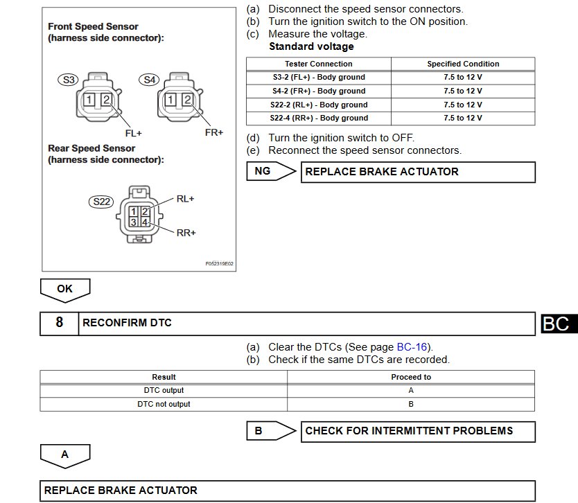

    Check the harness from the ABS Skid Control ECU;
