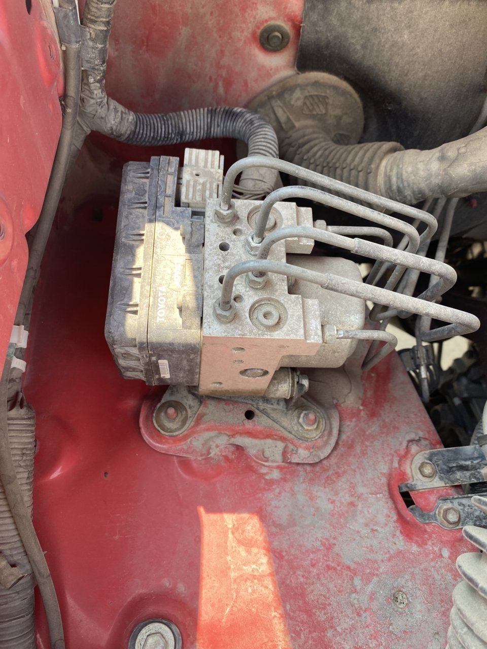

    Yep, I cleared them and they came back. Where is the ABS module? Is it underneath the car or in the engine bay?

    It's in the engine bay on the right fender, has a bunch of brake lines and an electrical connector.

    Looks like this
