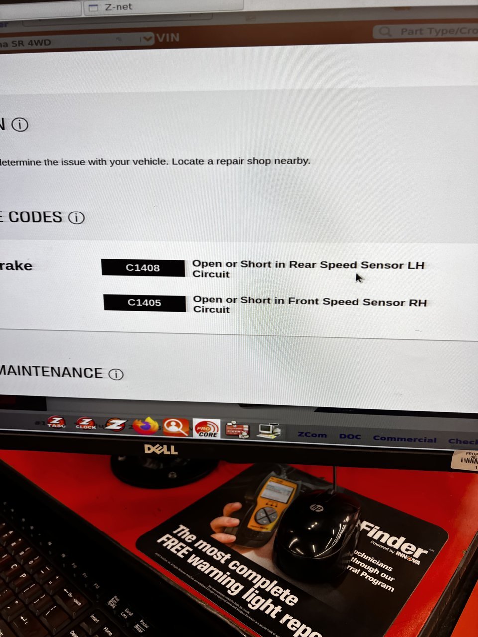

    We’re you able to fix this issue?
    Today while driving home (it was raining) I got the warnings lights.
    Took it to autozone to get it scanned and I got this codes

    main wiring harness loom was damaged due to rocks getting caught near them while offroading and rubbed through the wiring harness and created a short.

    Lets say "debris". Rocks and a stick.
