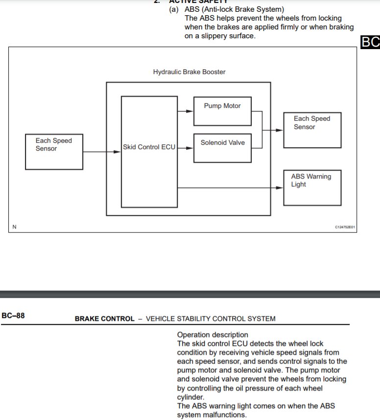

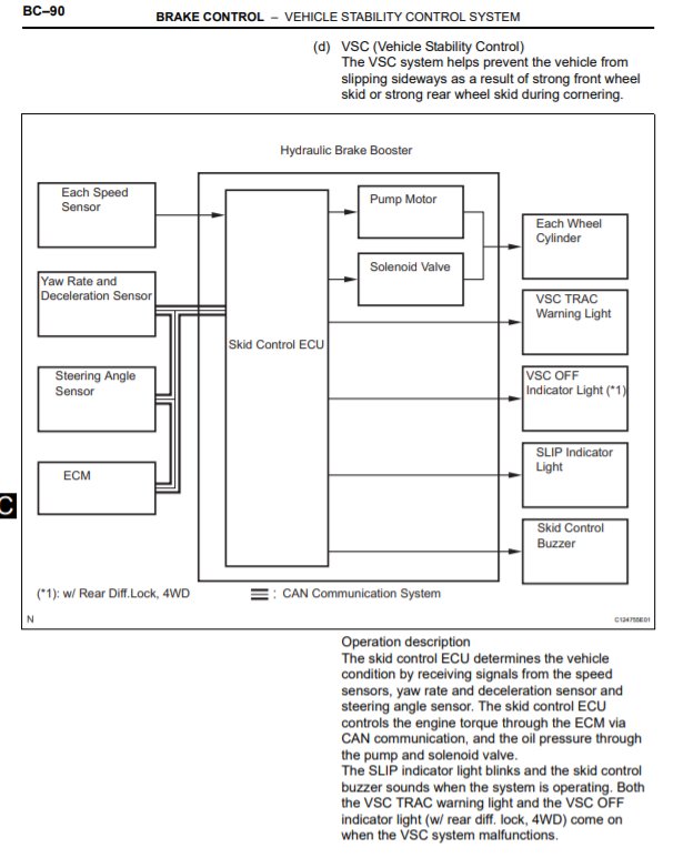

    Here have you, from the FSM and the different codes
    TnShooter and nd4spdbh[QUOTED] like this.

    That is not entirely true. The commonality between the ABS and VSC is the speed sensors and skid control ECU, since both systems use it. Not having ABS will not prevent the use of VSC, unless the reason that not having ABS is due to say a failed speed sensor. The systems are independent but share some of the same components. VSC also uses additional sensors such as yaw rate, steering angle, and deceleration sensors. If one of those were to fail you would still have ABS but not VSC.
