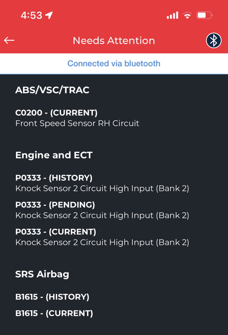

  14. Feb 17, 2022 at 10:02 AM
    Bono
    Bono [OP] Member
    Apr 21, 2018
    #251264
    10
    NW Ind
    2007 Tacoma SRD LB
    6” ProComp
    Okay I think I got one of the issues solved, the brake light on my dash is off now, but the abs is still light. Per the code checker only right side is bad c0200. I guess I need a new harness. He shows wear on the insulation so probably broke thru the wire from rubbing against the CV axle.
