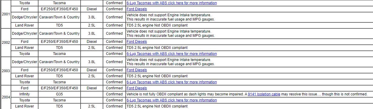

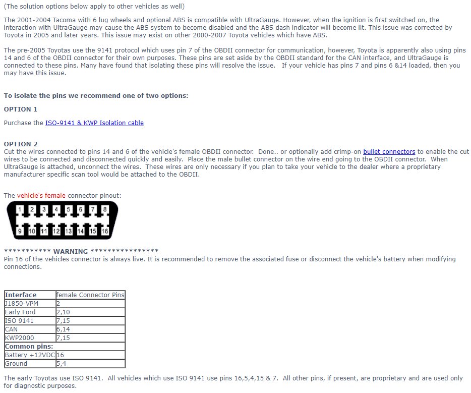

    When I purchased the UltraGauge for my '03, I had to purchase an "isolation cable" because of the same issue you are having.
    If you look below, you may be able to do option 2 to correct the problem. Not sure.

    I had an OBDII plug in that would set of my ABS light if I took the plug in out while the truck was running, it was weird. I had to shut the truck off in order to remove the plug-in to avoid the light.
    Never had that issue with my Scangauge though
