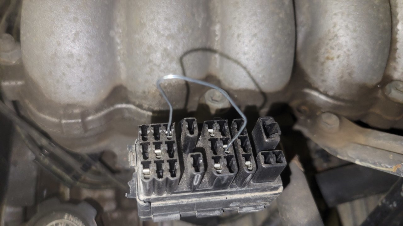

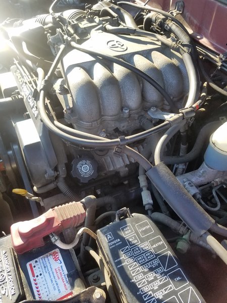

  12. Jul 8, 2023 at 3:00 PM
    1blink
    1blink Well-Known Member
    Jul 5, 2023
    #428330
    143
    Storm Mtn, CO
    2000 3.4 manual SR5
    I'm troubleshooting a 2000 3.4L tacoma with ABS and rear diff lock lights on. Trying to jumper to read the ABS codes. I've jumpered pins Tc and E1 on the diagnostic port, and turned the ignition to on. The ABS light stays illuminated solid... no flashing codes. The airbag and seatbelt lights do flash. Anyone have ideas about what I'm missing here to read the codes? Thanks!
