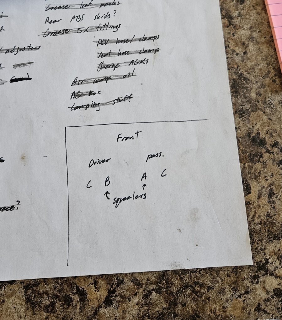

    If you look carefully there are letters cast into the ear of the pads. A B and C
    Surprisingly there's not a lot of info about it, but this is how I oriented mine when I did them this summer:
    As for the ABS light, you might have bumped / damaged one of the wheel speed sensor wires. Should get the codes read

    I'm not 100% sure on Tacoma's since they have the dual calipers but on conventional calipers you typically put them to the inside as the inside pads typically wear slighty faster than the outside.
    There's nothing to do with changing brake pads that should trigger an ABS issue unless you damaged a wire or wheel speed sensor.

    Yup squealers inside and down as I recall. Hence the difference between A and B pads
