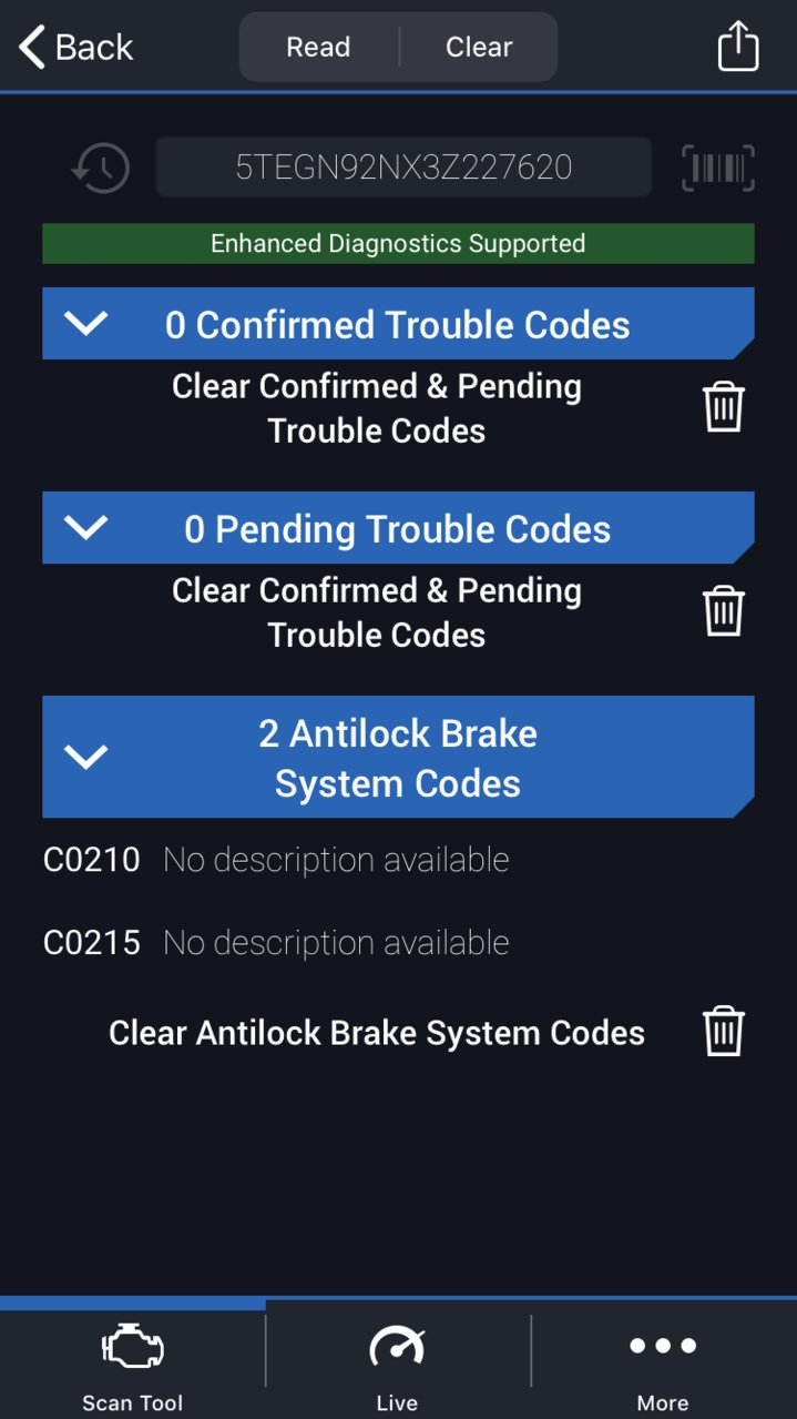

    I ran a diagnostic for the engine and abs system. Came back with the two codes below which is for the left rear and right rear sensors. So, using the "Clear Antilock Brake System Codes" I cleared them just to see if they would immediately come back on and they didn't. Shut the truck off and now when you move the ignition to on, the ABS light comes on for the normal 3 seconds and goes off.
    So, I'm hoping it was just a fluke from having the rear diff moved around....fingers crossed!!

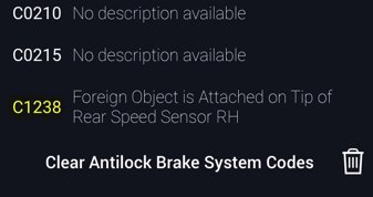

    The past Saturday I cleared the codes again before running an errand. ABS light came on in nearly the exact same place of the trip. But, this time there was an additional code which may support the seal being bad.
    New Code: C1238 FOREIGN OBJECT IS ATTACHED ON TIP OF REAR SPEED SENSOR RH.

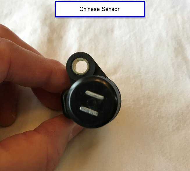

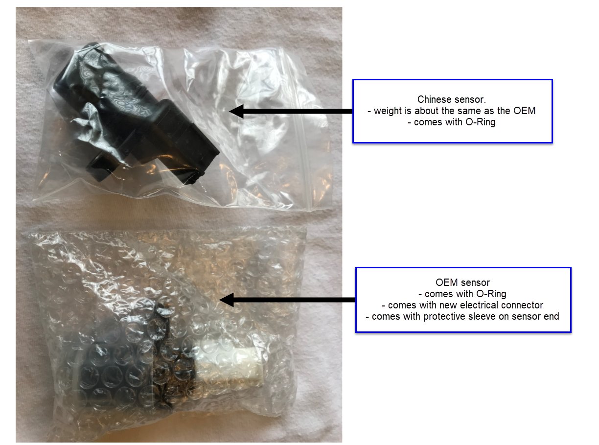

    Okay guys. The $14 Ebay sensors arrived yesterday. Haven't installed yet. Wanted to post some pictures of them in case someone considers ordering these. Again, I know these are Chinese knock offs. It clearly states in the pics below......"Made in China". This is to rule out or confirm that it's actually a sensor. Also, the "Made in China" sensors have no markings or numbers on them. I have the new oem sensor but I'm not opening the sealed package unless I have to. Just wanted to show the visible differences between the OEM one and the cheaper alternative.

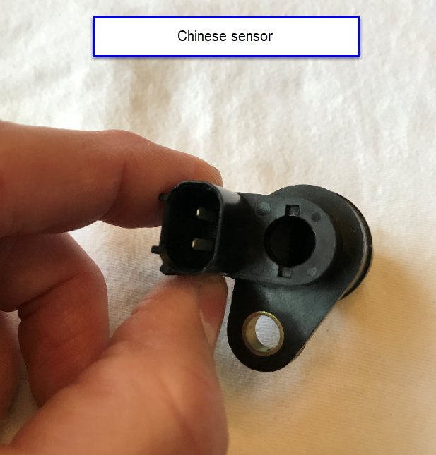

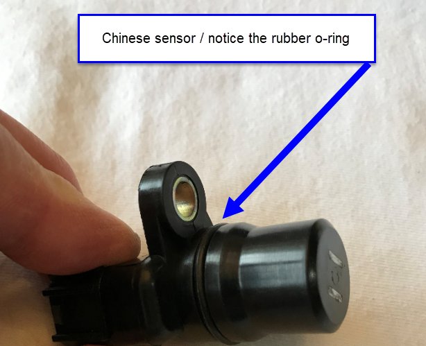

    Well, I shouldn’t be surprised...the $14 Chinese sensors didn’t fit. It’s like a millimeter to big. Would have taken a hammer to drive it in.

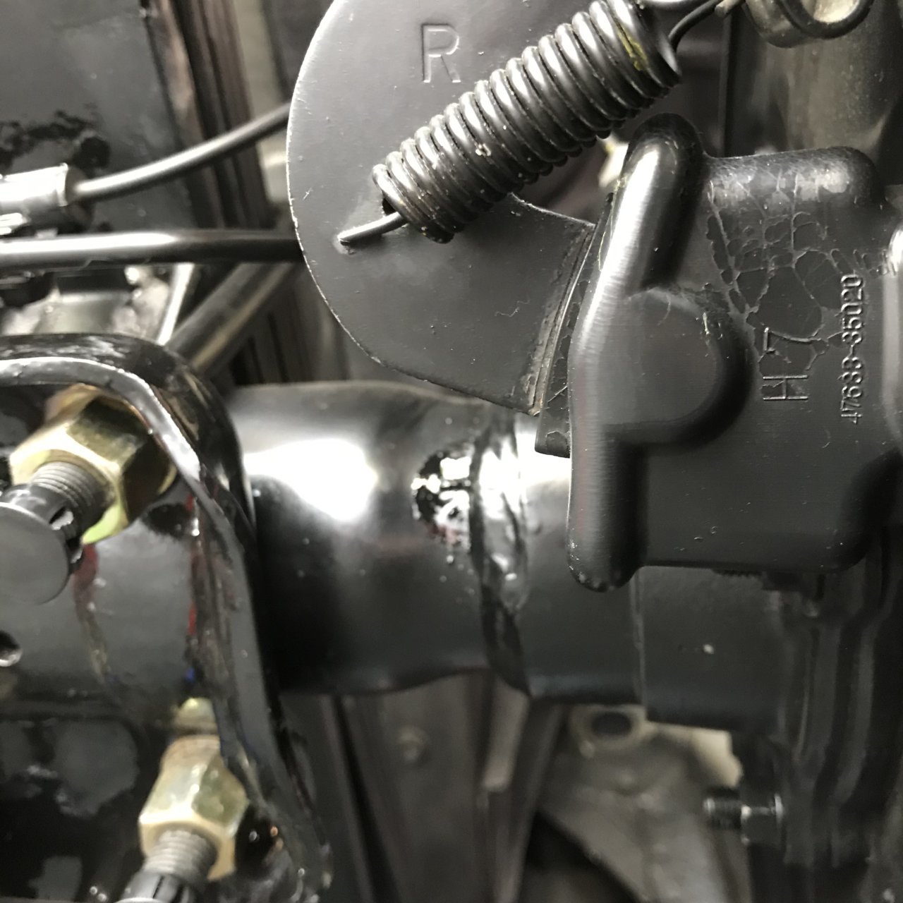

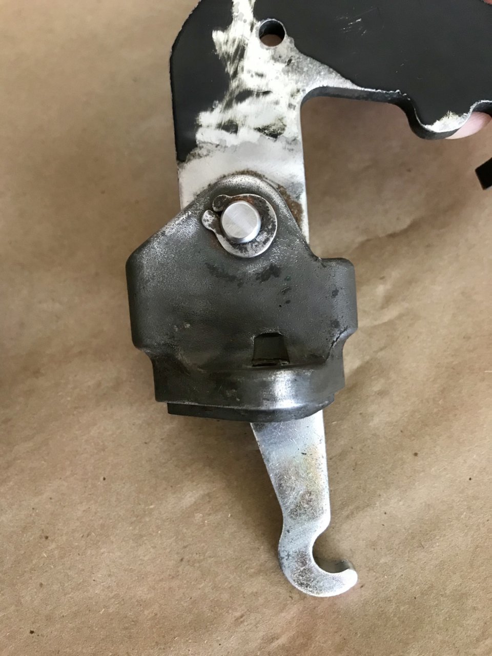

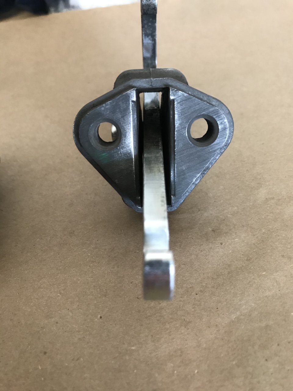

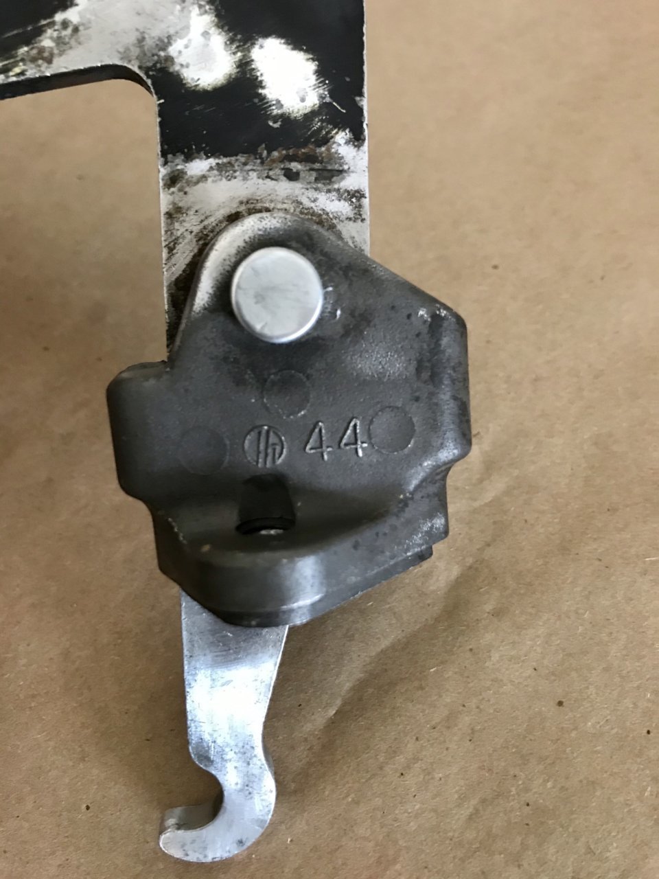

    I did go ahead and pull the passenger side drum in preparation to replace the axle seal. Got the parking brake undone but I’ve got to go in the morning to pick up an assortment of vacuum plugs for when I remove the brake line.
    There was no gear oil inside the drums.
    Since I’m not replacing the brake shoes, I’m going to leave everything in place when removing the axle. Hardest part was removing the bottom 12mm bolt that secures the parking brake mechanism. No room with the brake shoe attached.
    pic of the parking brake with rubber boot being removed. I’m going to get it cleaned up while I got it off.
