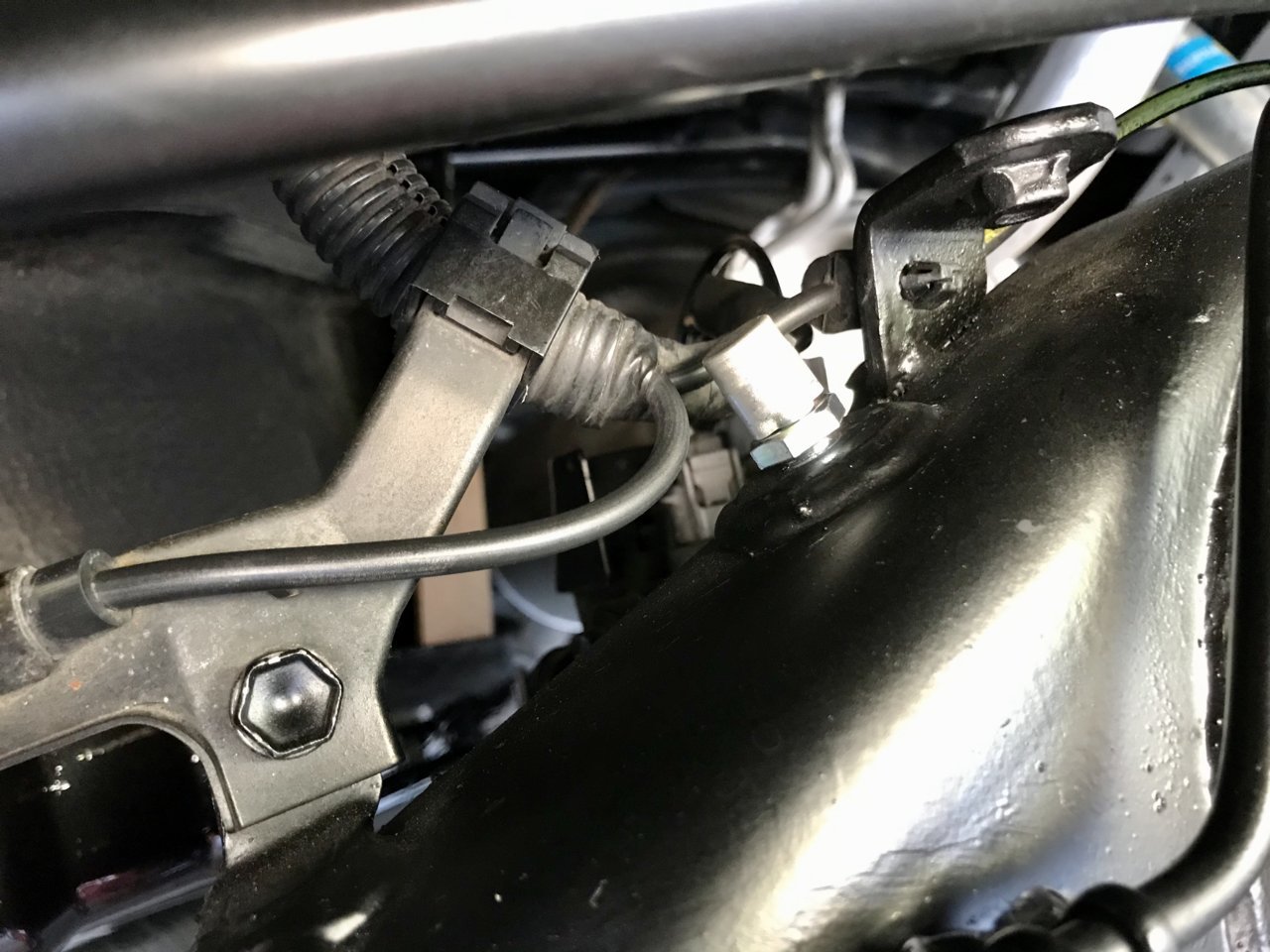

    I’ve done a little research on this but no, I haven’t checked them. Good idea though. Looks like you have to rotate the tire (abs ring) while having the ohms meter attached to determine if it’s good/bad.

    That will give you an a/c voltage pulse. But they should have a resistance you can check on the ohm setting. By checking a the connector under the seat you're checking the wires to the sensors also. I'm thinking the wire got pinched and severed by accident when working on the spings.

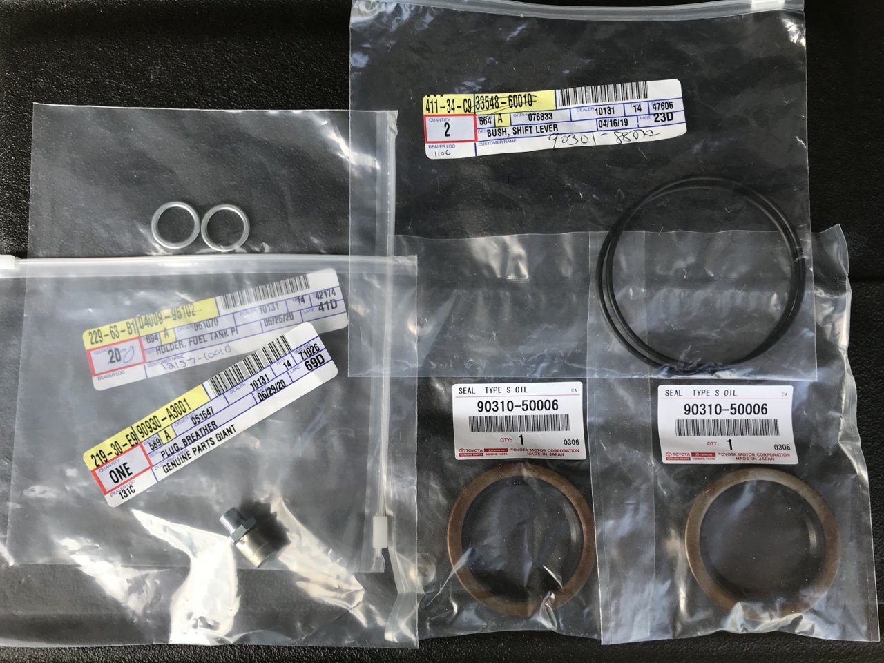

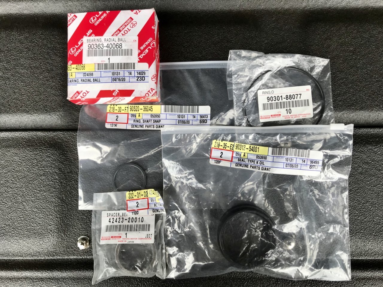

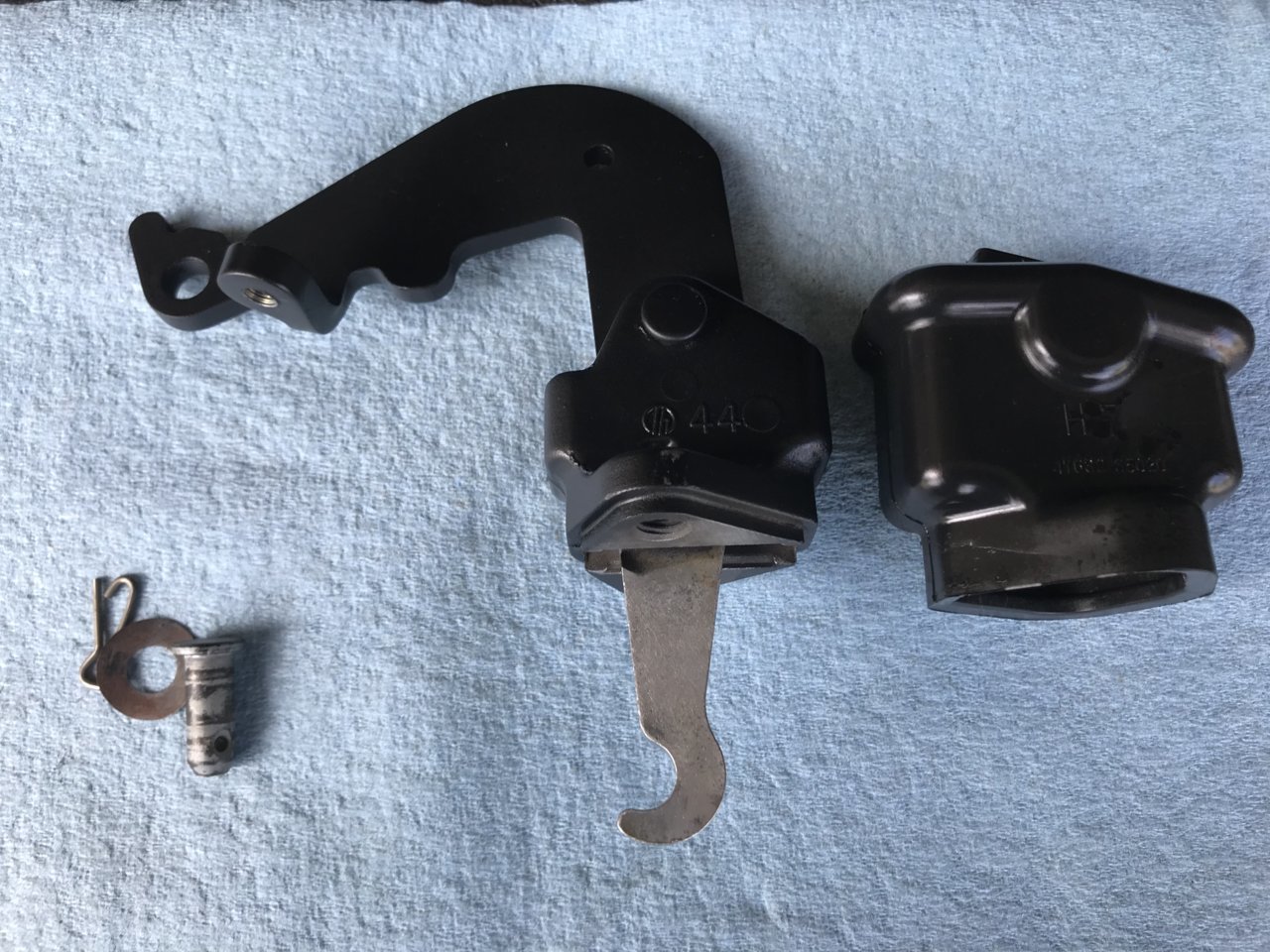

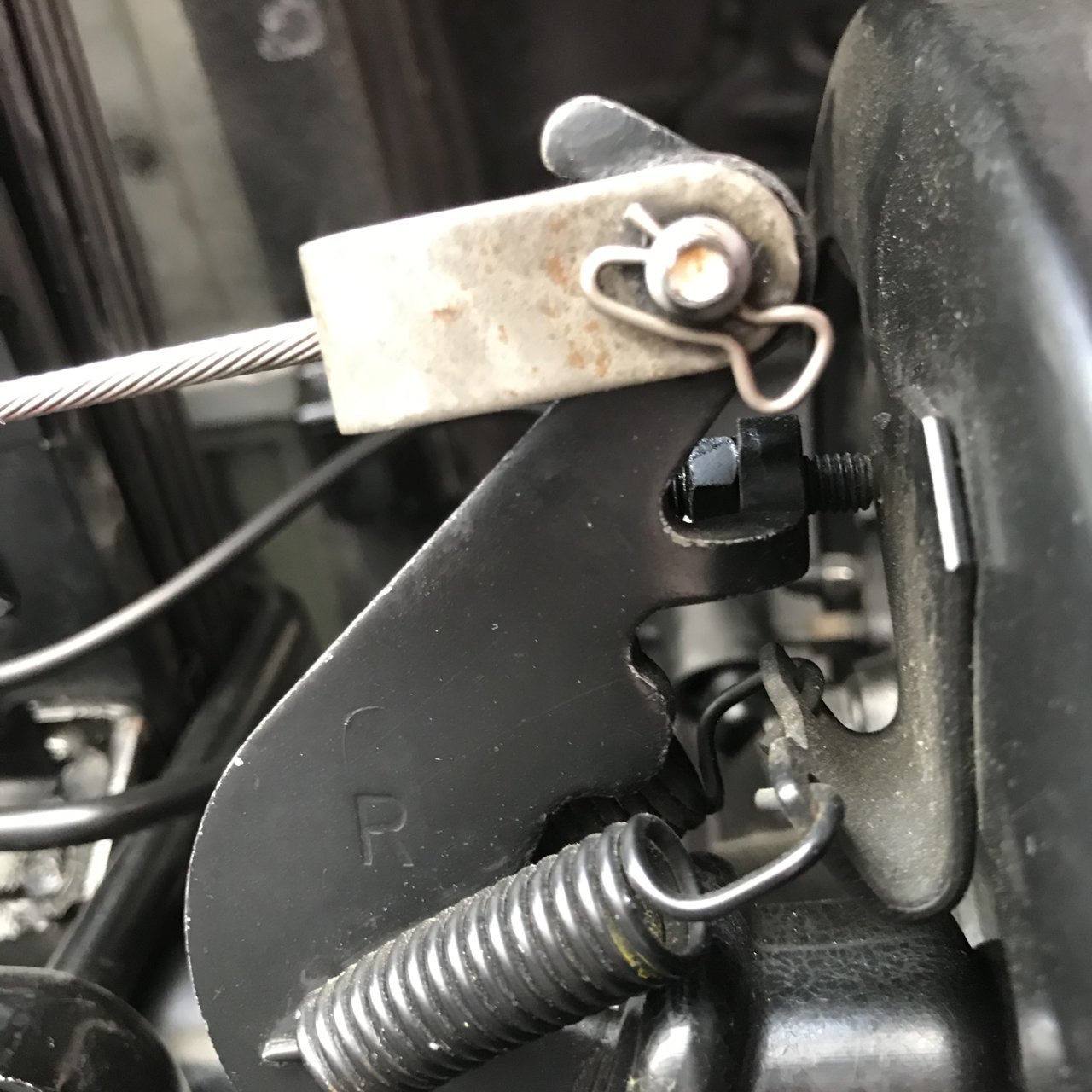

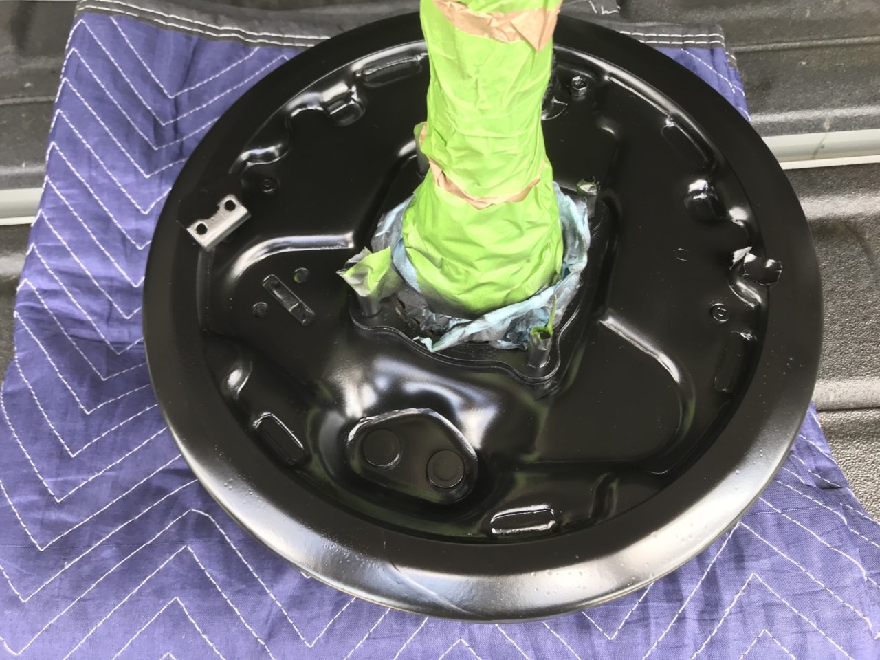

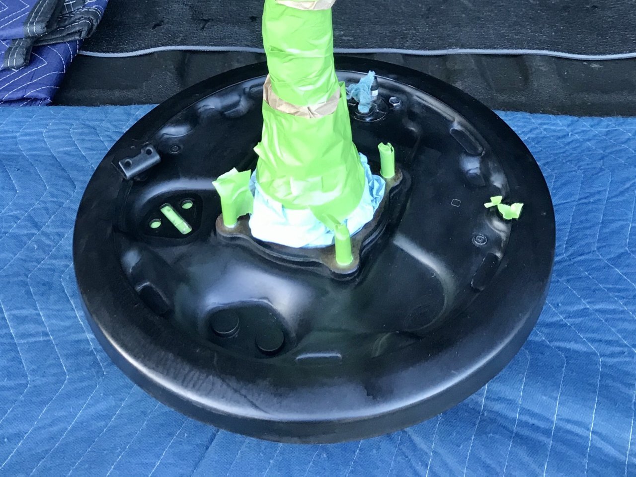

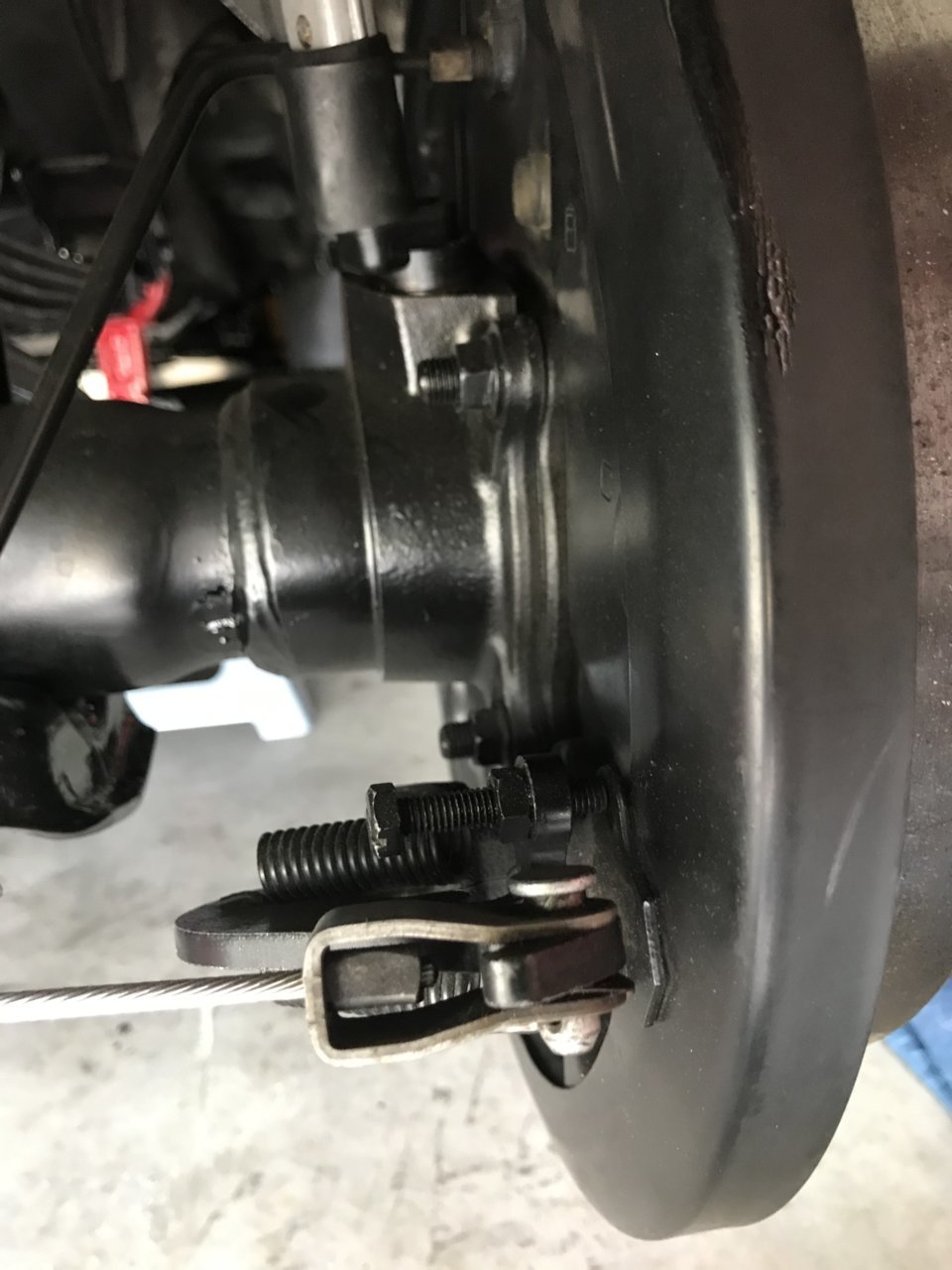

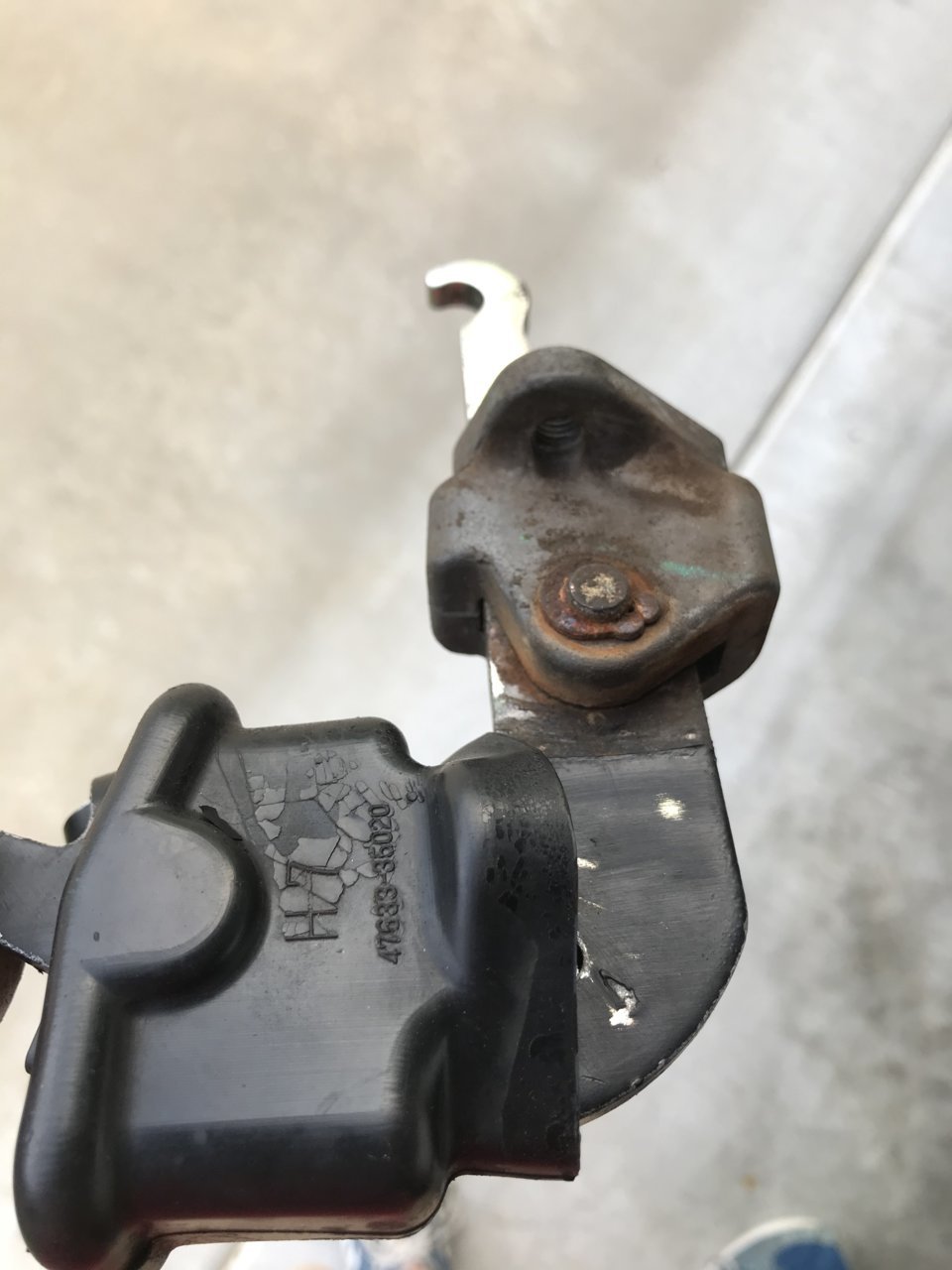

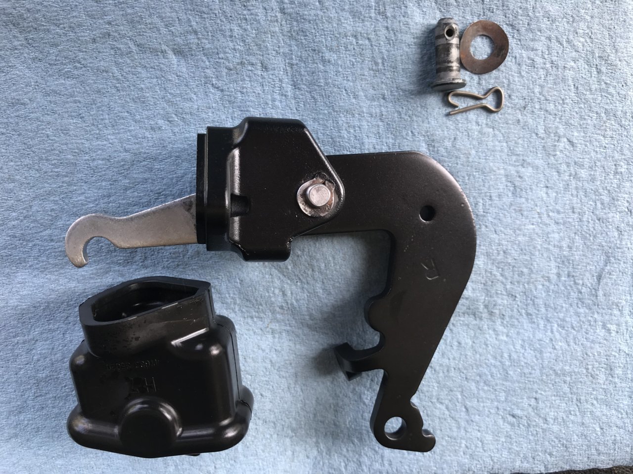

    Parts came in today, and repainted the parking brake mechanism.

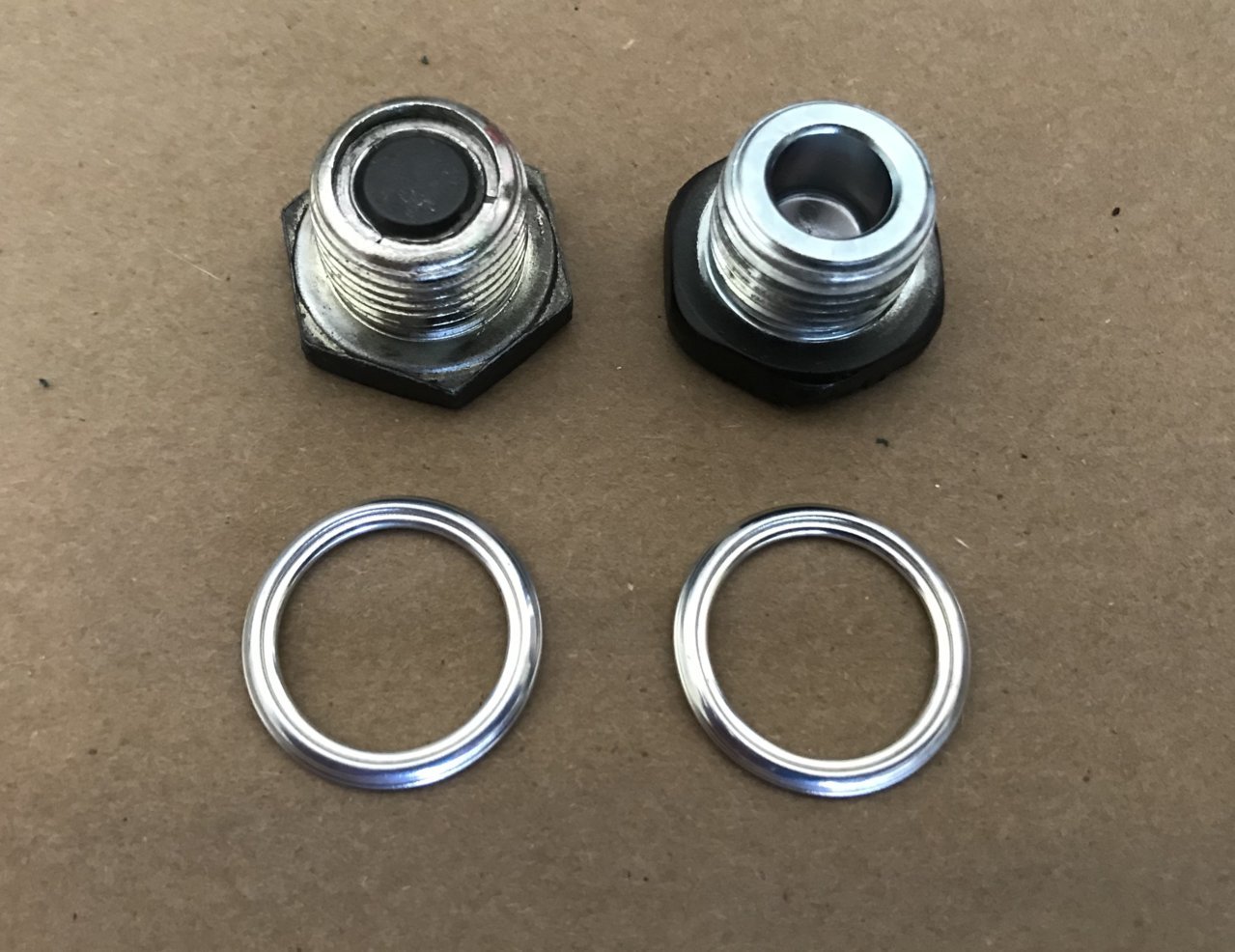

    Parts #’s for the axle dust seals and rear end drain plug gaskets don’t match what’s on the bag...

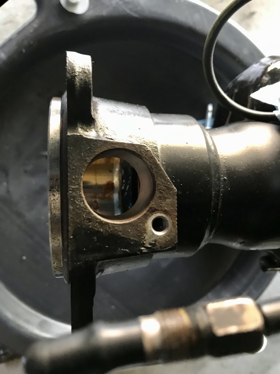

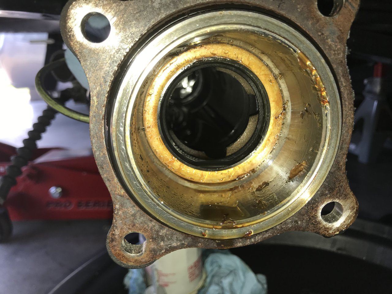

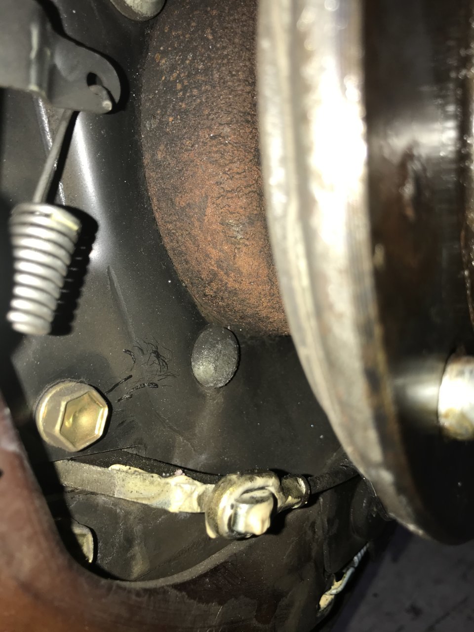

    Busy day guys, and hotter than four hundred hells in the garage!

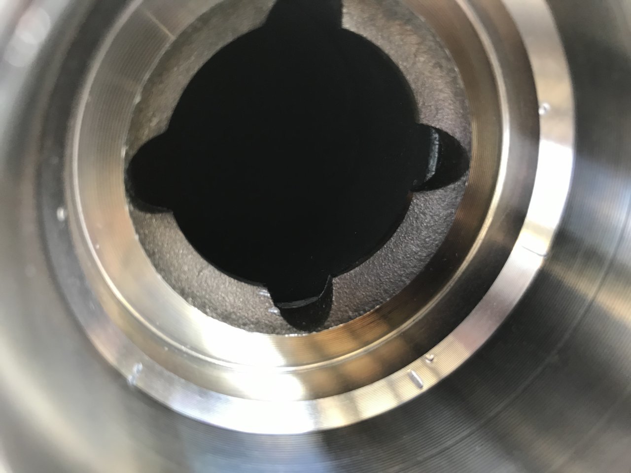

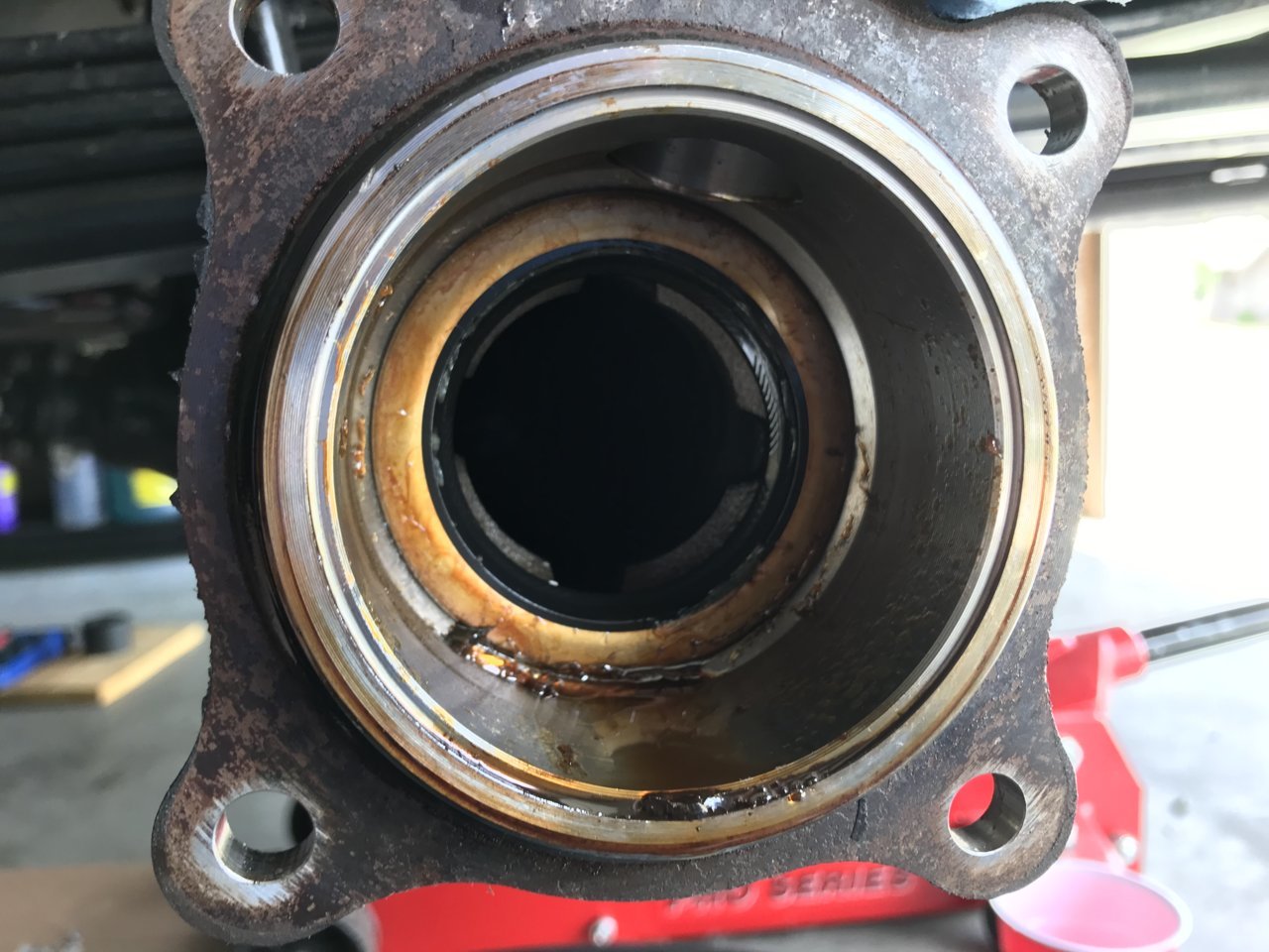

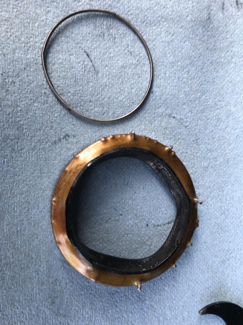

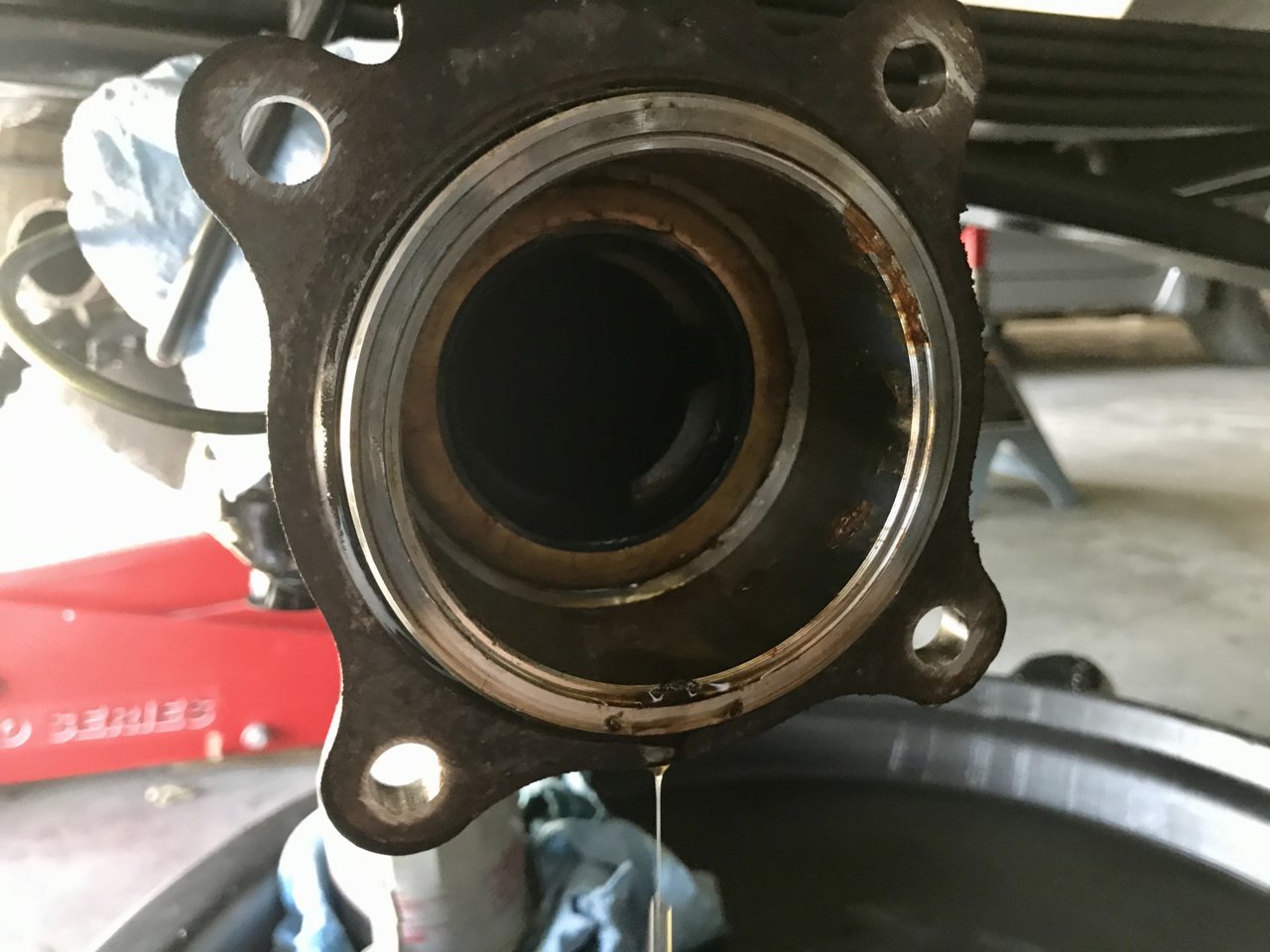

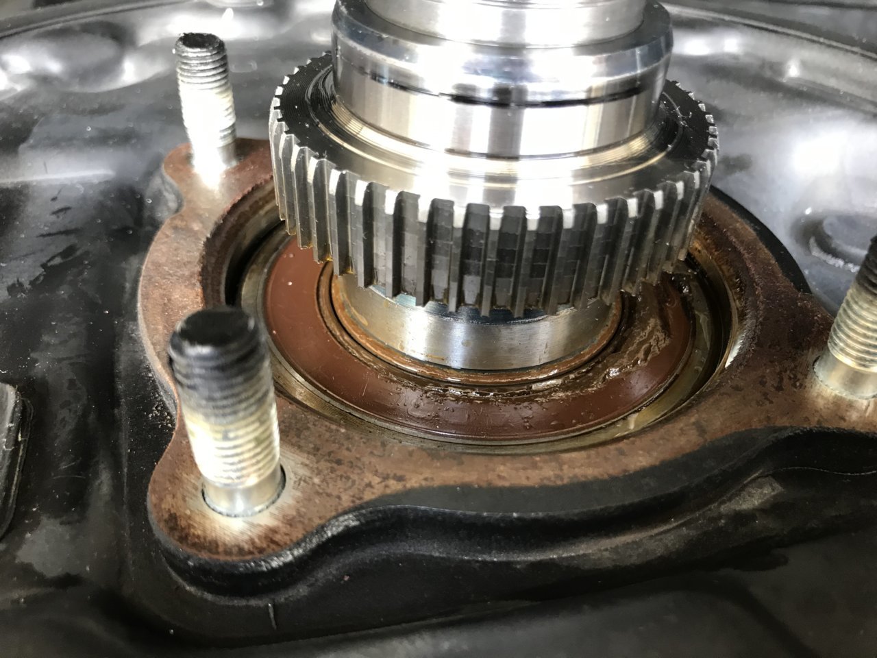

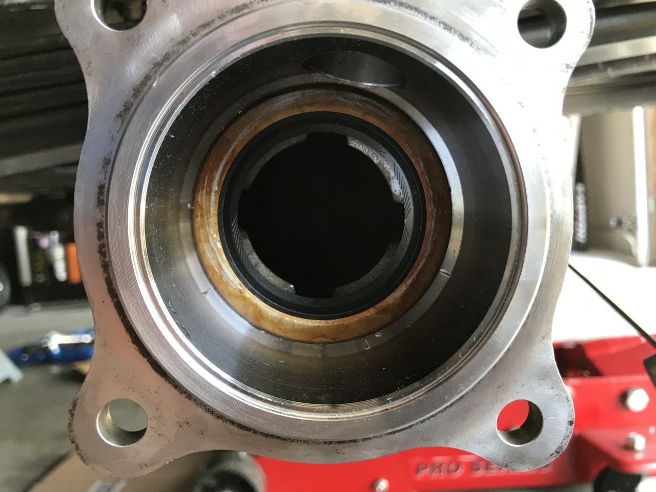

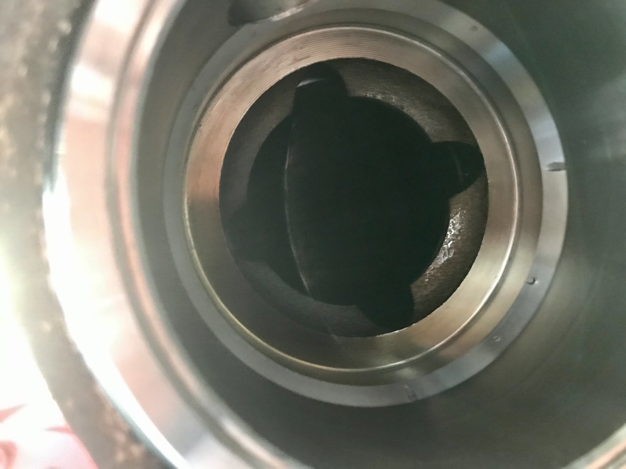

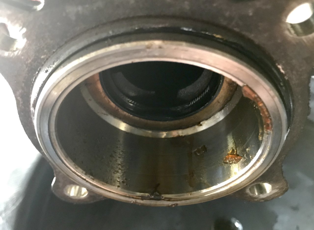

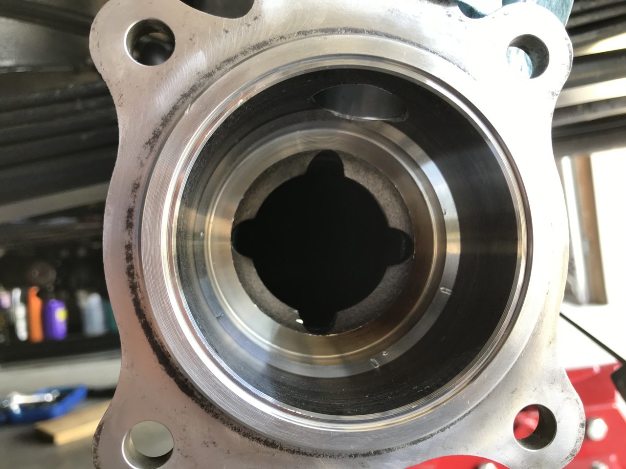

    Need some help. Got the passenger side axle removed. There was about a teaspoon of gear oil that came out that was past the seal.
    Question is should there be that much play? No roughness felt and spins freely.
    I’ll post more later tonight.
    https://youtu.be/GNKZSSP6AHQ
    https://youtu.be/XOmcxNqYT5o

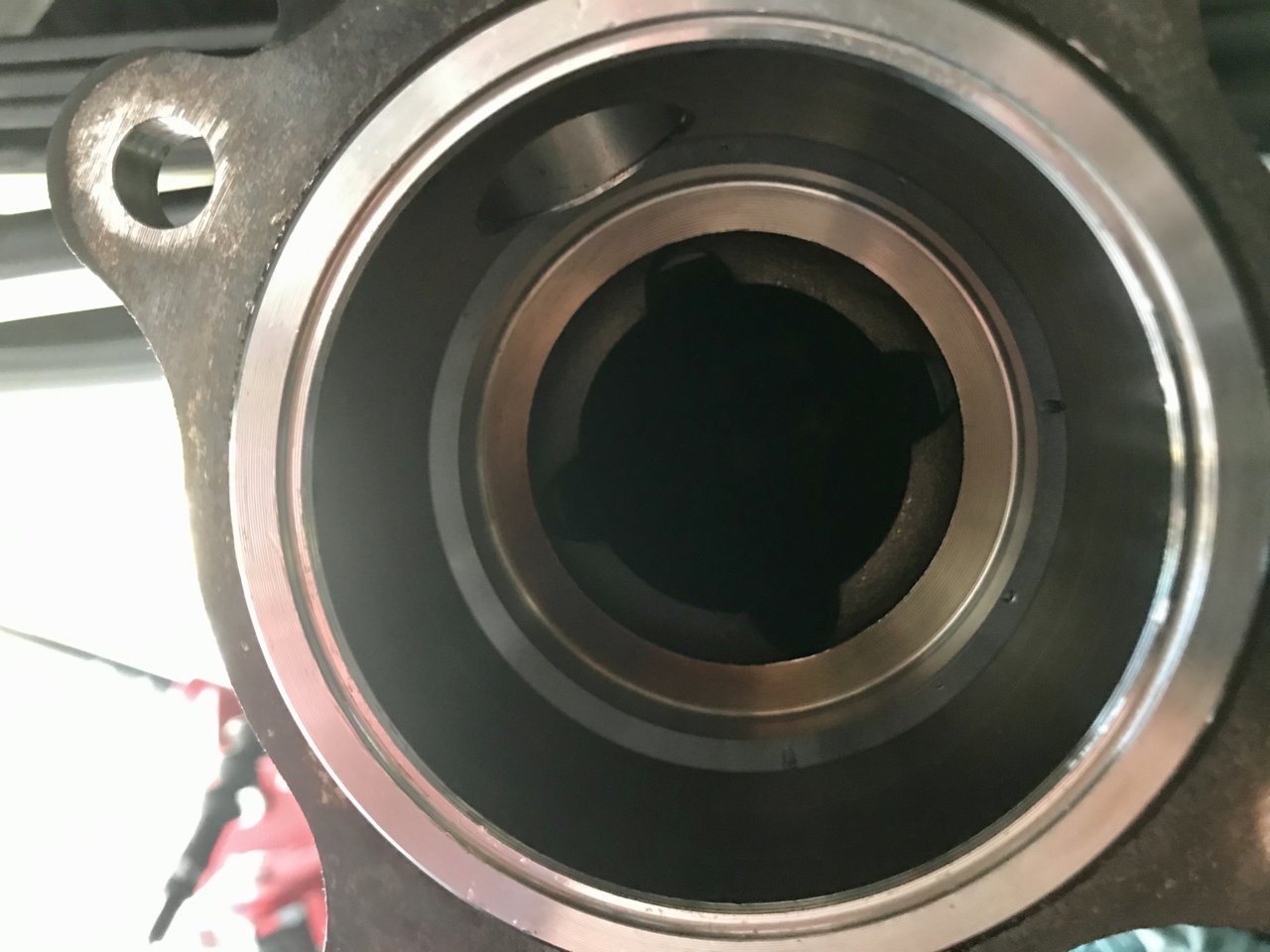

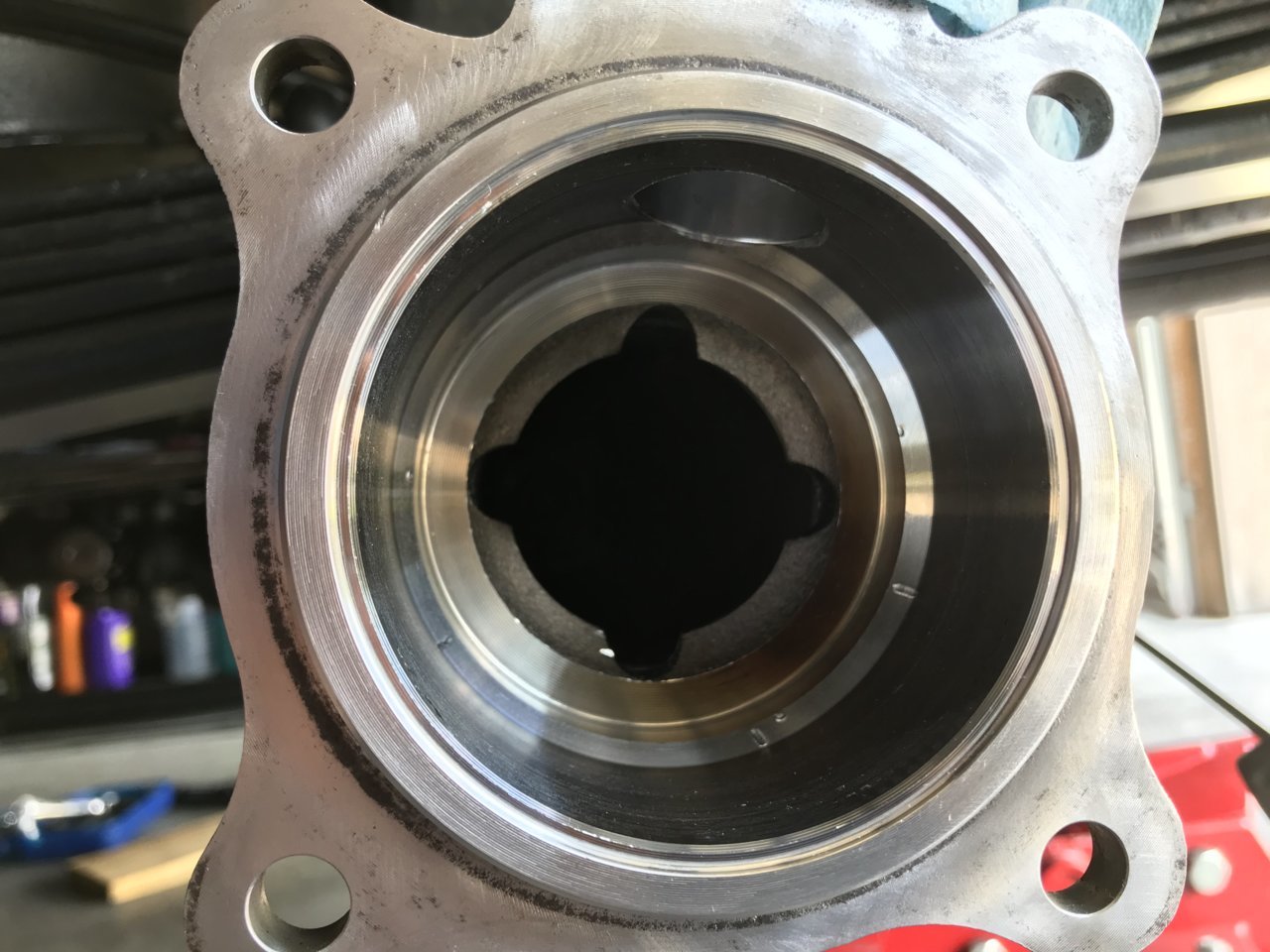

    Pic taken right after removing axle. Again, about a little over a teaspoon of gear oil came out.

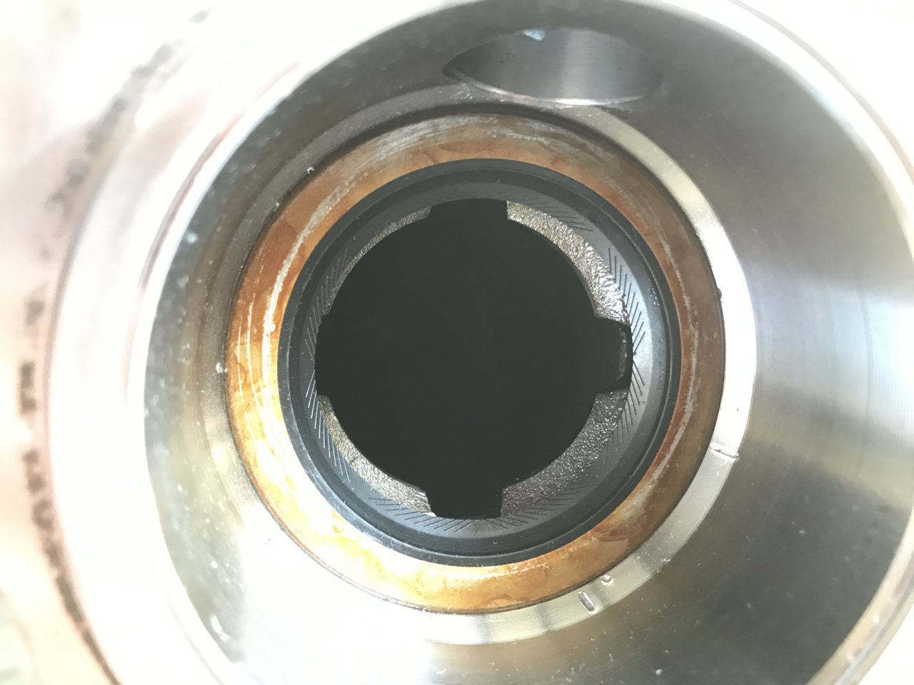

    Pics after the seal was removed

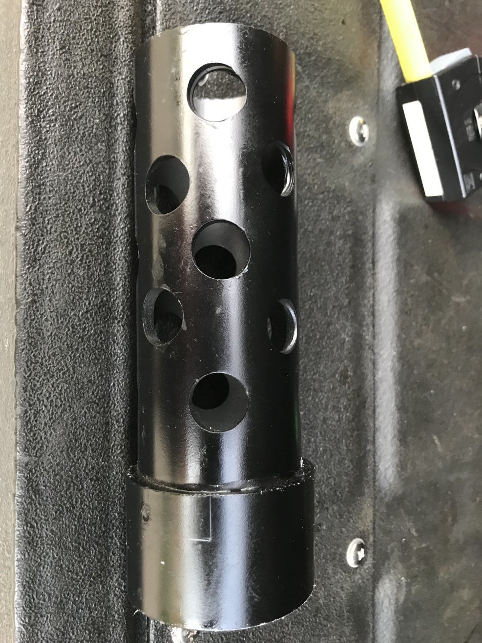

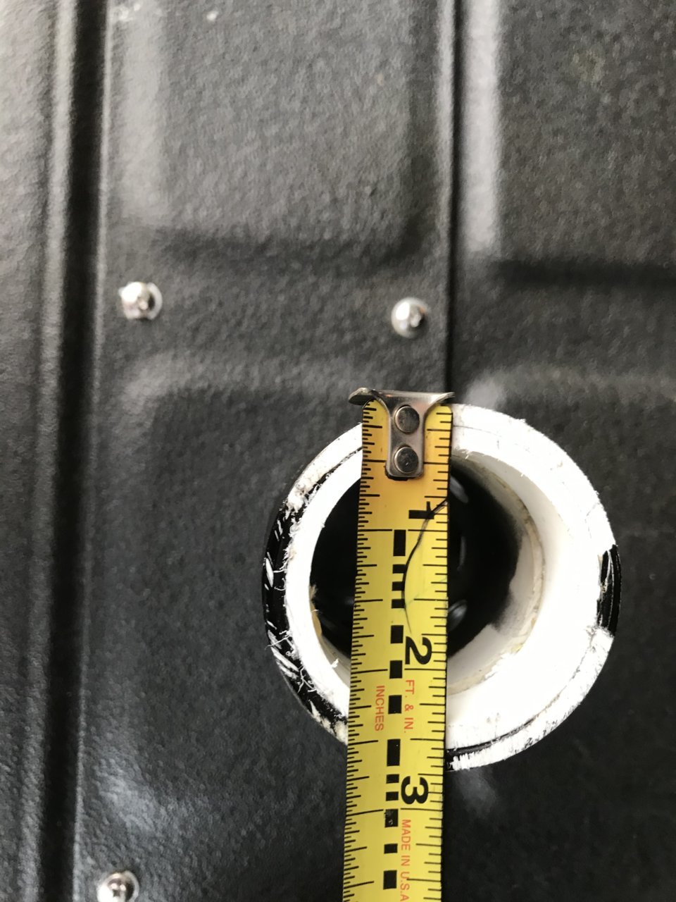

    To get the new seal in I used a leftover part of pvc pipe from a potato gun I made a few years back. You can see in the 2nd pic I had drilled out some holes to make the end of the potato gun look like a WW2 machine gun barrel.

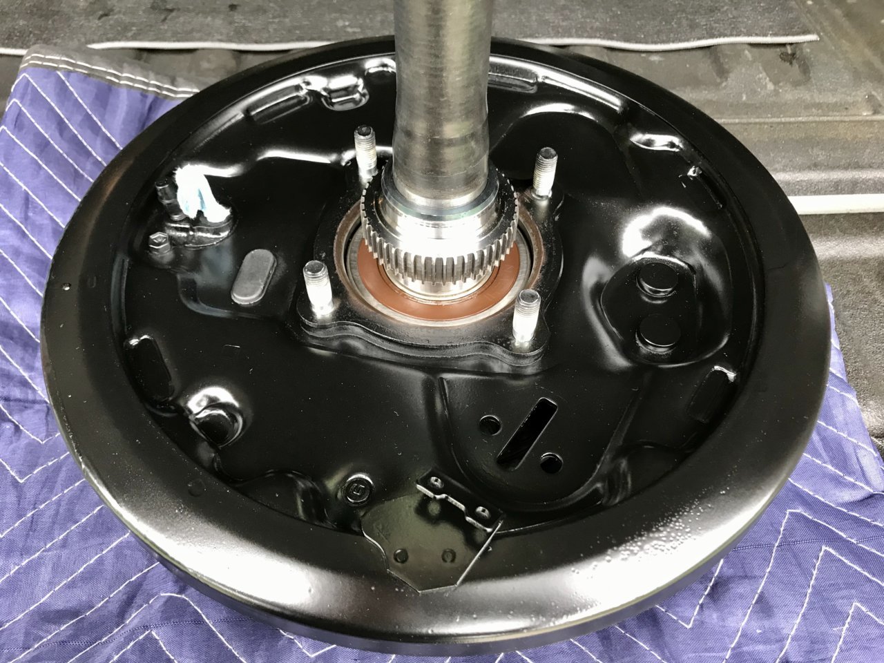

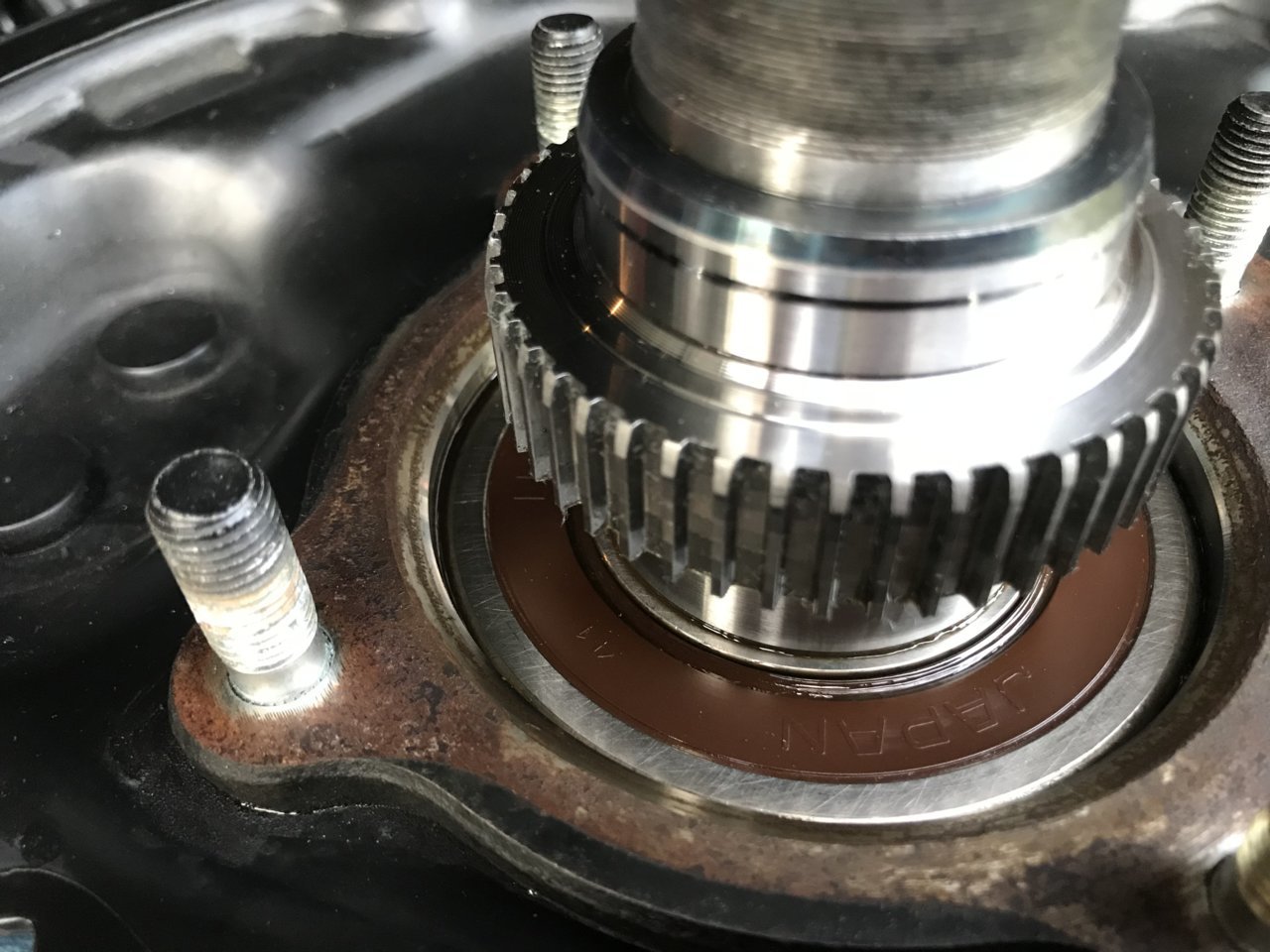

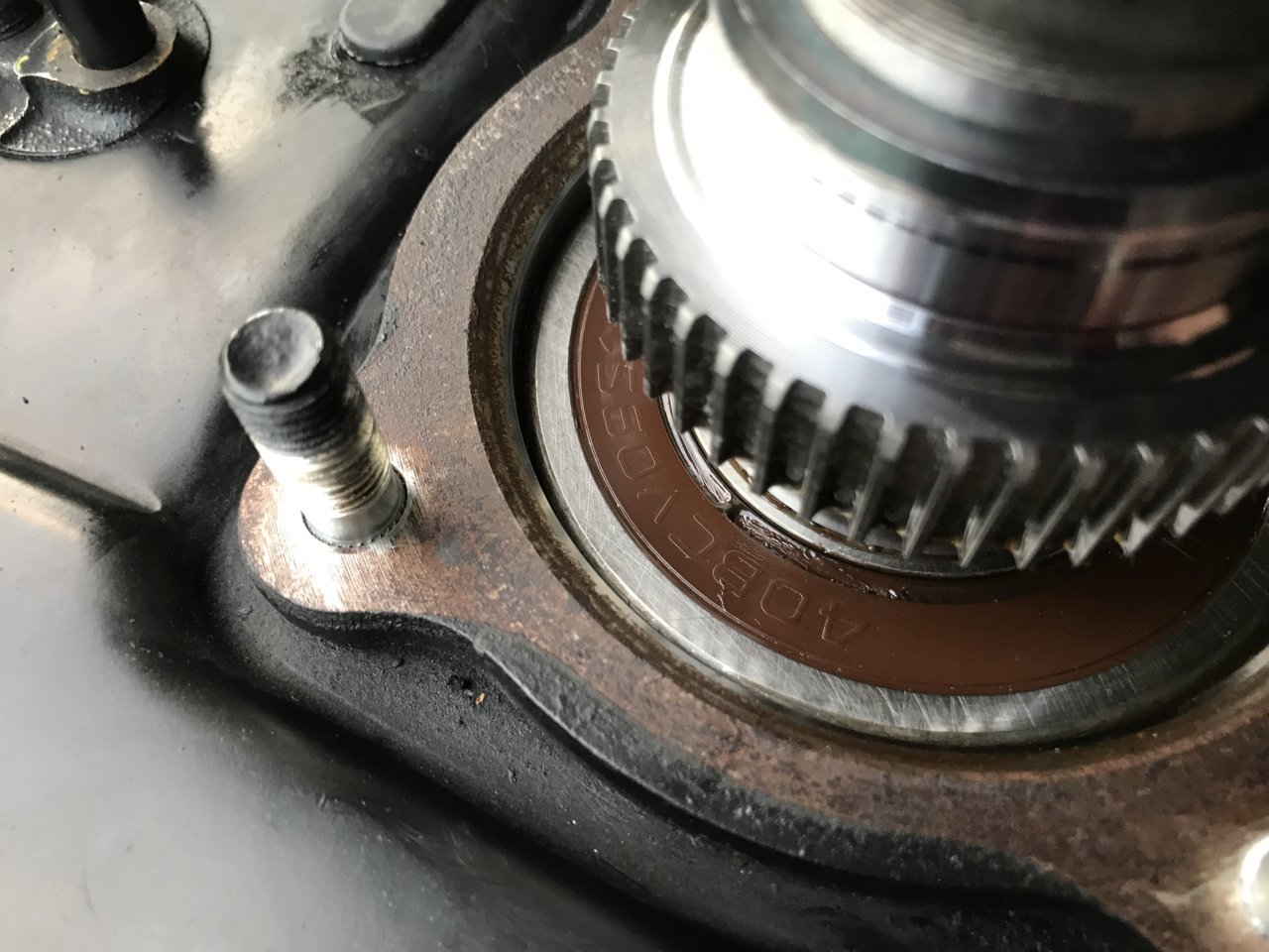

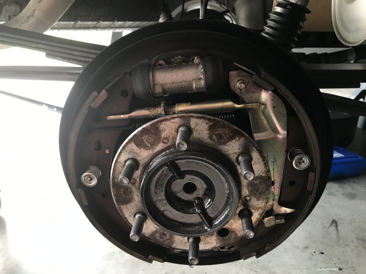

    07.03

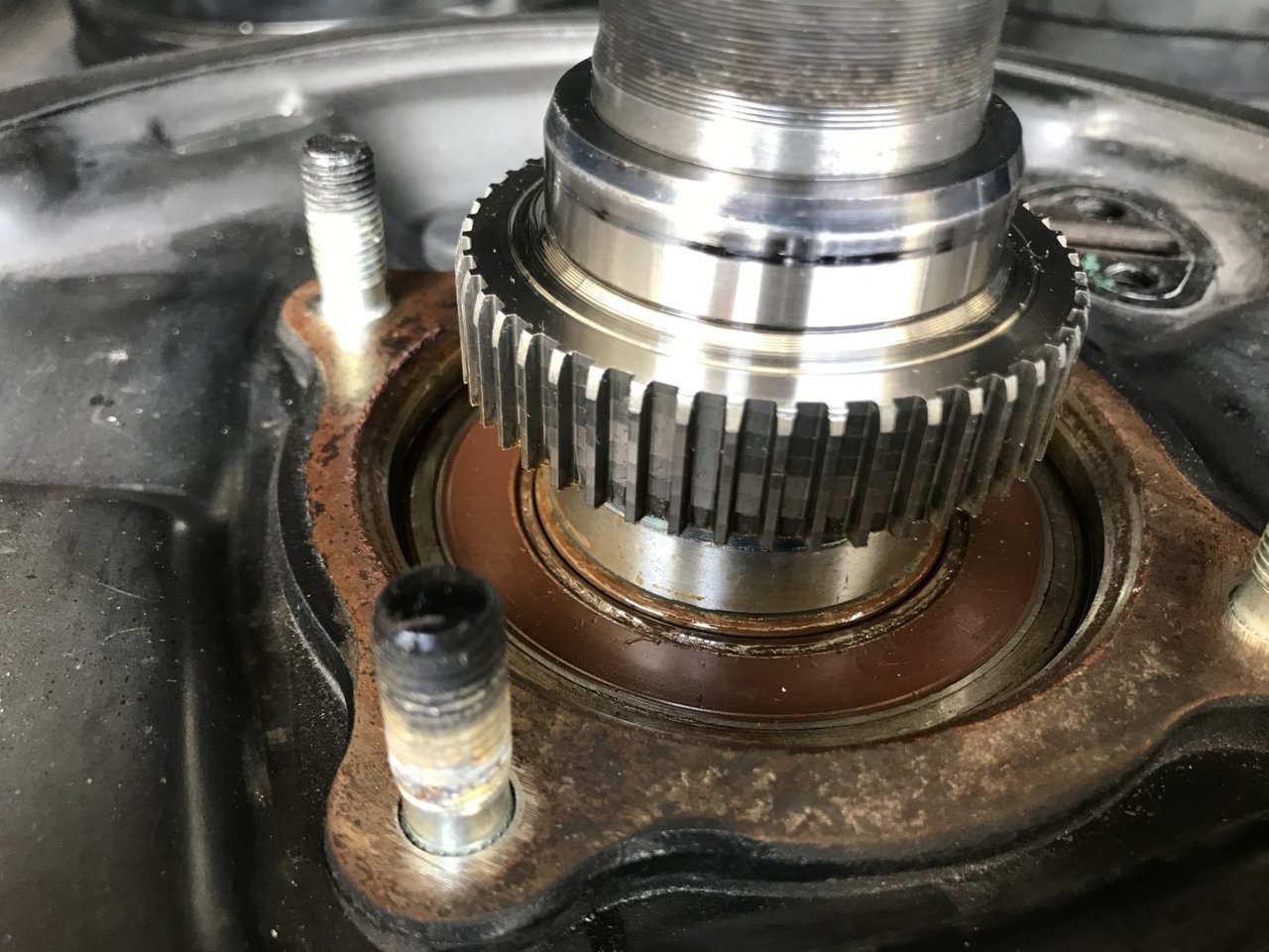

    Got the drivers side axle pulled.
    drivers side bearing

    I haven't replaced the wheel bearings on these tacos before, but I have replaced a few wheel bearings over the years. I'm inclined to think that play is not supposed to be there when grabbing the drum and moving it as you were able to do in those videos.
    I just rewatched again to make sure I was seeing and hearing it right. The sound really helps in this case. You don't see much play watching the vid but the sound helps, at least it helps watching the vid on a phone and with Android air buds:D

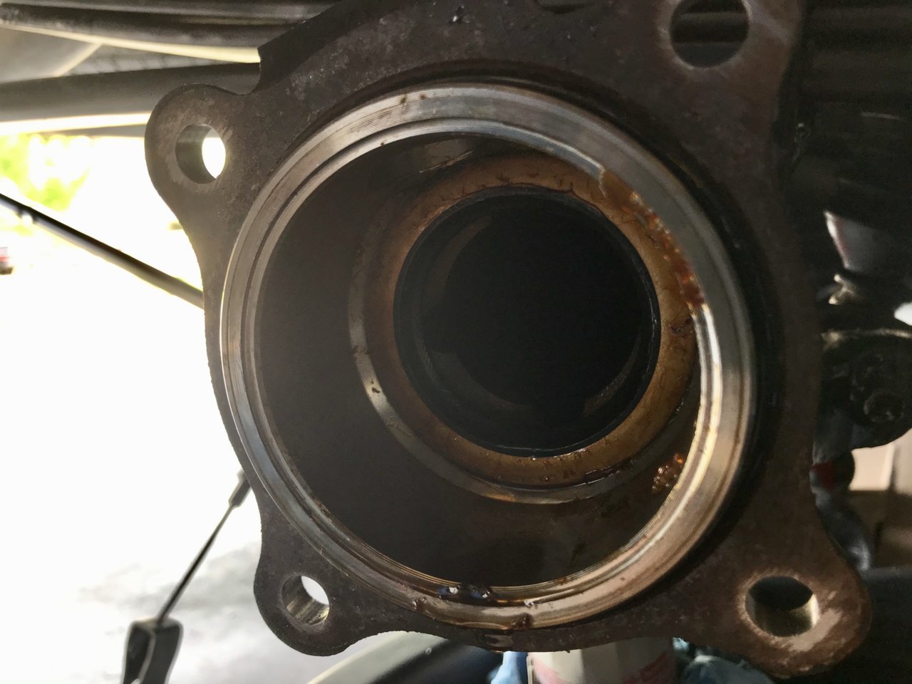

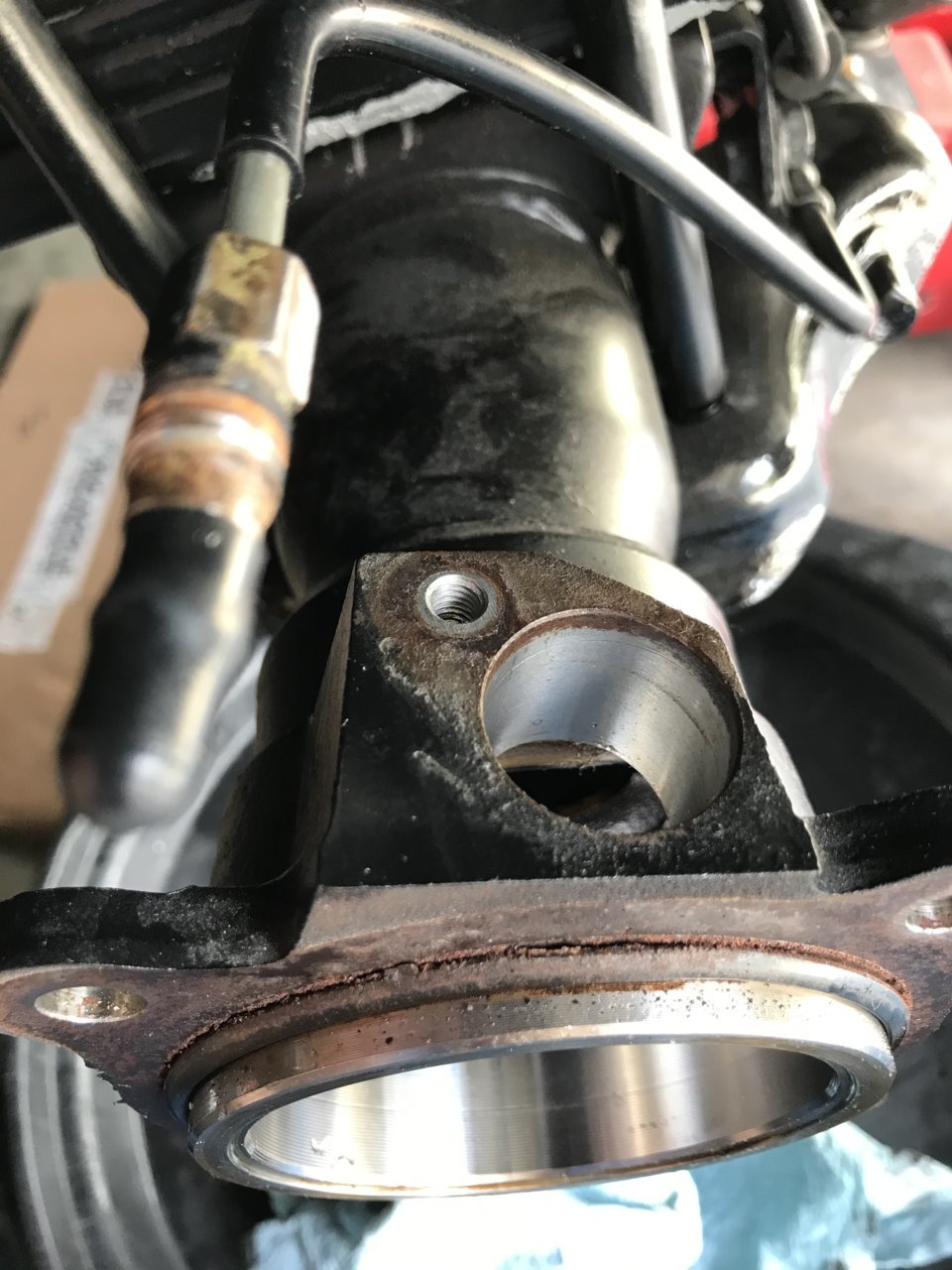

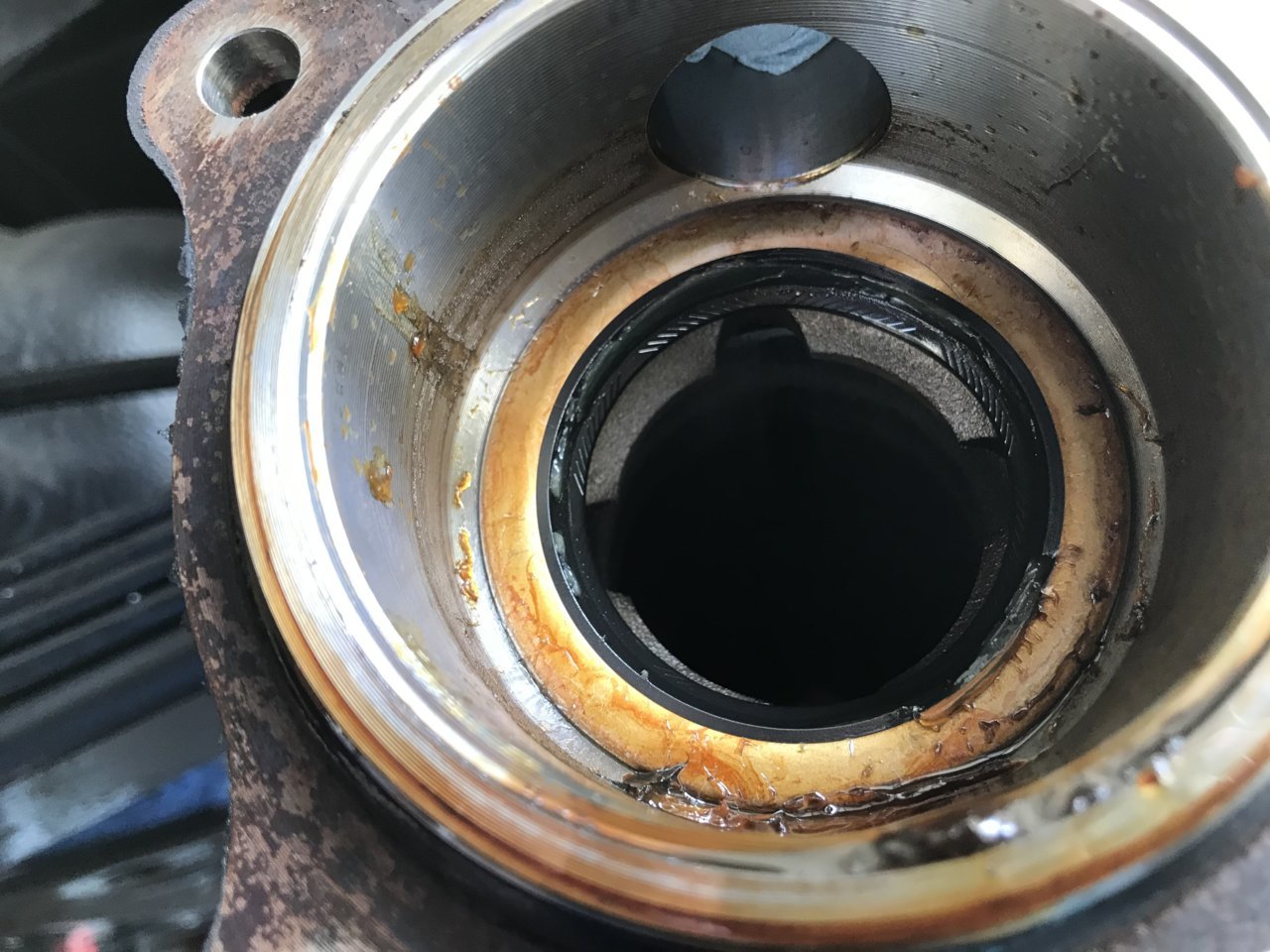

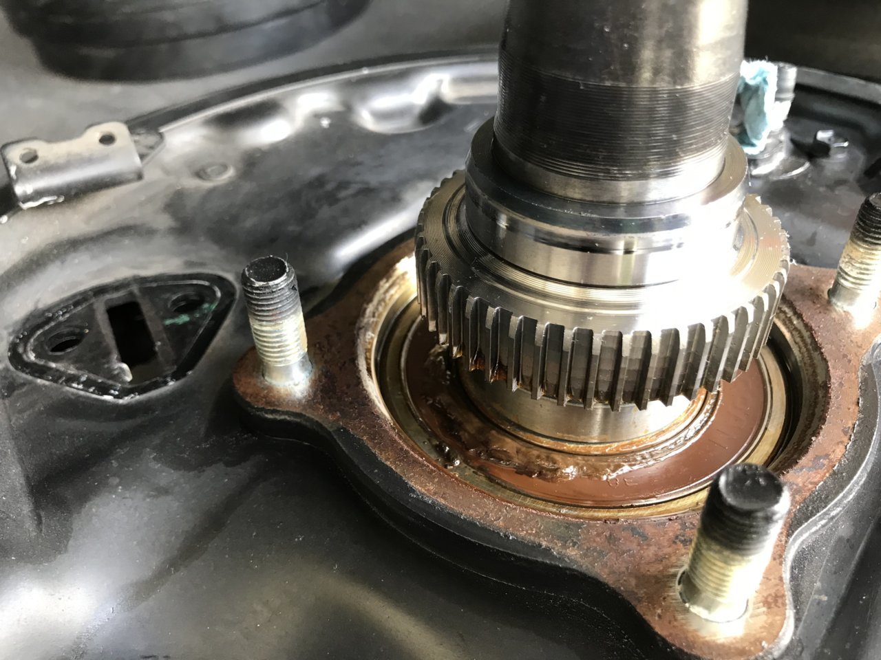

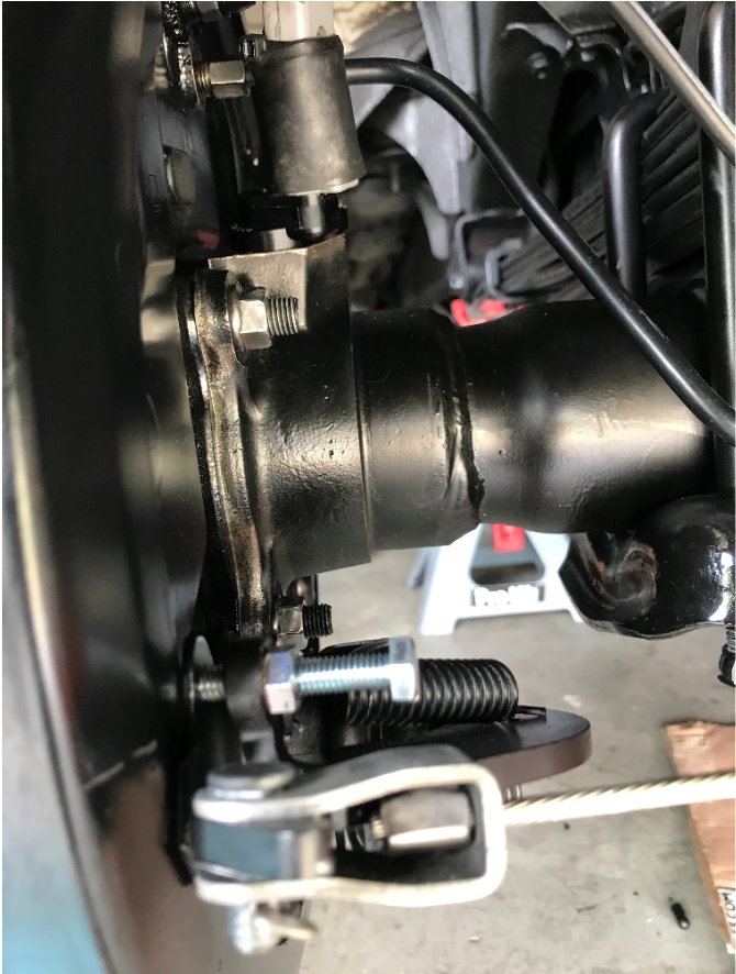

    Got the drivers side axle seal replaced, cleaned up around where the large dust seal inserts around the axle tube.
    Now just waiting for the axle bearing parts to arrive later this week. I’m replacing the passengers side, but not the drivers side. The drivers side axle didn’t have near the amount of play the passengers side had.
    Drivers side axle seal removed
    new seal installed
    Also installed the new diff breather and put on the new washers for the drain/fill plugs.

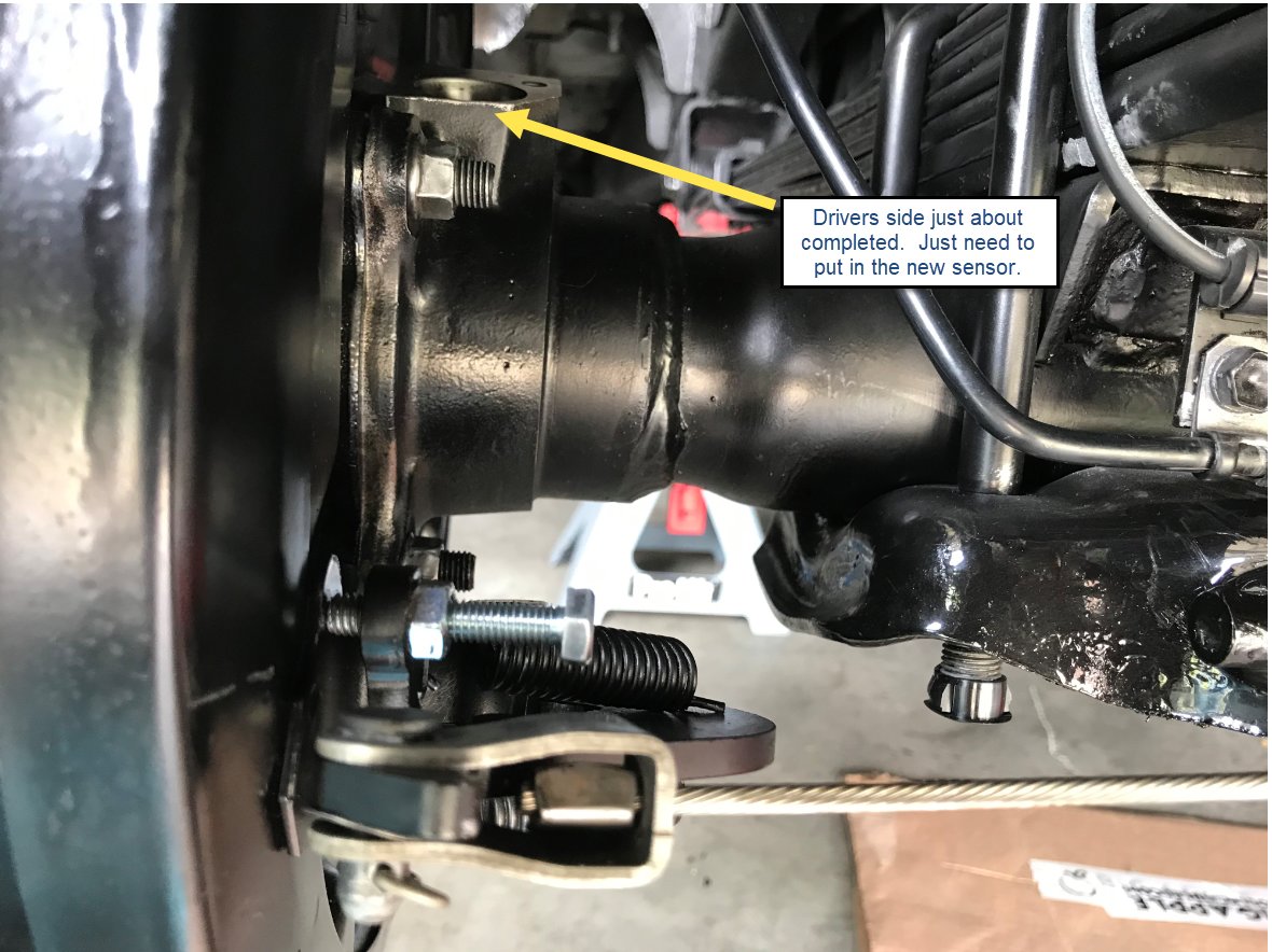

    Got the LH rear axle secured, and the 4 14mm bolts torqued to 50ft lbs. Also, installed the NEW Toyota LH ABS Sensor. Checked the tracking on the RH bearing, seals, etc., and they should arrive tomorrow or Monday.
    Drivers side complete!!

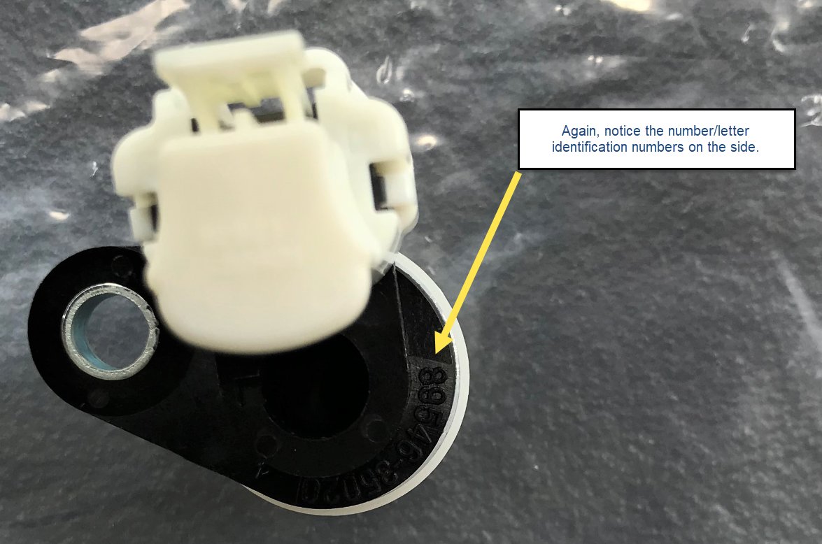

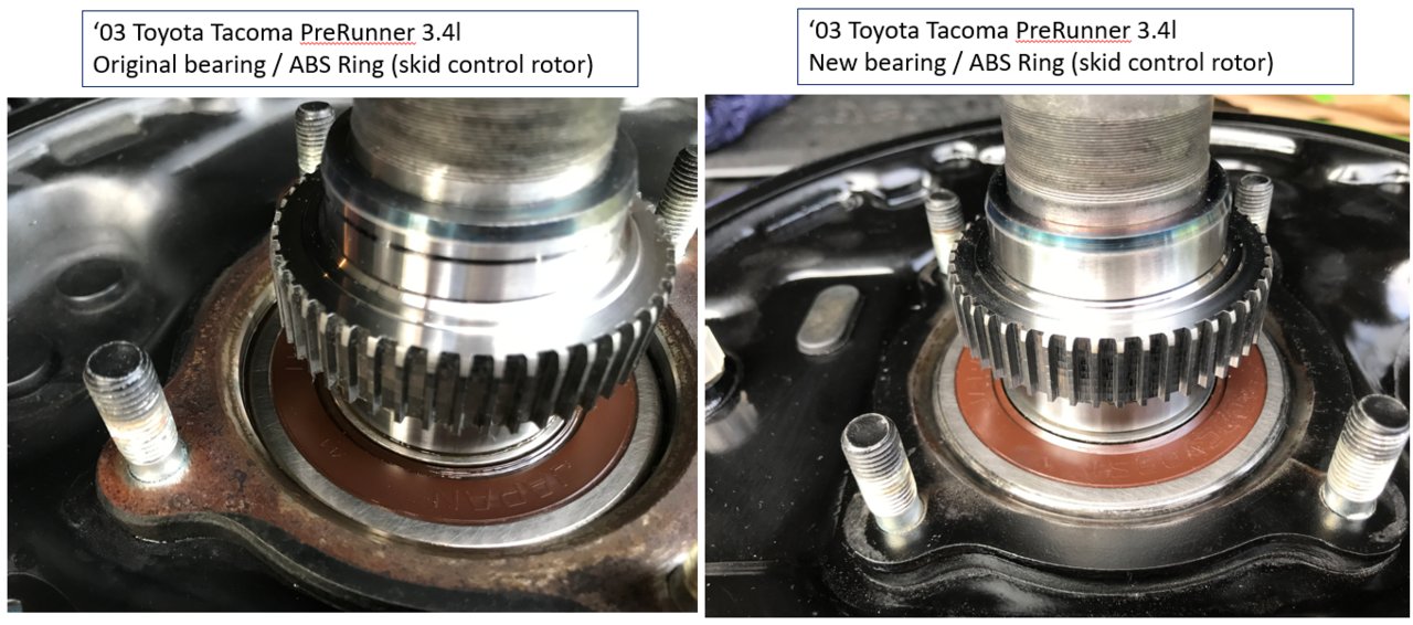

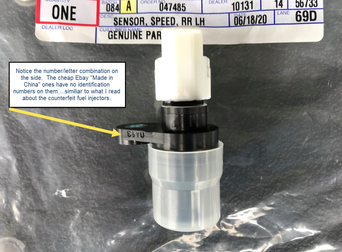

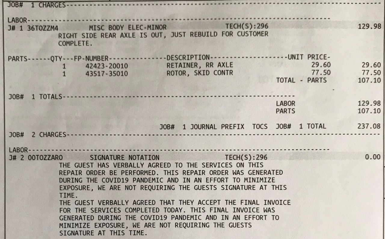

    Picked up the passenger side rear axle with shiny new parts...expensive shiny new parts....and expensive labor.
    Not really much to see by looking at the difference, but there is a considerable amount of difference in the play. Much tighter.
    I included a pic of the invoice to give others an idea of how much they'll be charged. Keep in mind I took the axle in, so they didn't have to remove it. Guy that wrote up my ticket said that would have easily added another hour of labor or $100.
    Also remember, that they had to cut the abs ring off, so on top of the parts I had already ordered, they charged for that and another retainer seal (my fault...left it at home).
    This afternoon I hope to get the axle back in, torque the 4 14mm bolts to 50 ft lbs, replace with new gear oil, and bleed the brakes.
