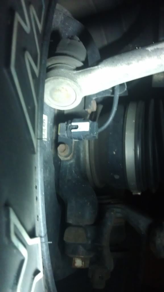

    Mine did this after I installed my front 5100s. Apparently, I stretched the ABS sensor wire enough to break a wire inside. Every once in a while it would lose its connection and the light would come on and then it would go off. I ended up having to rebuild the sensor wire by splicing in new wire. Cleaning your sensor might fix it, but it might be the wire.

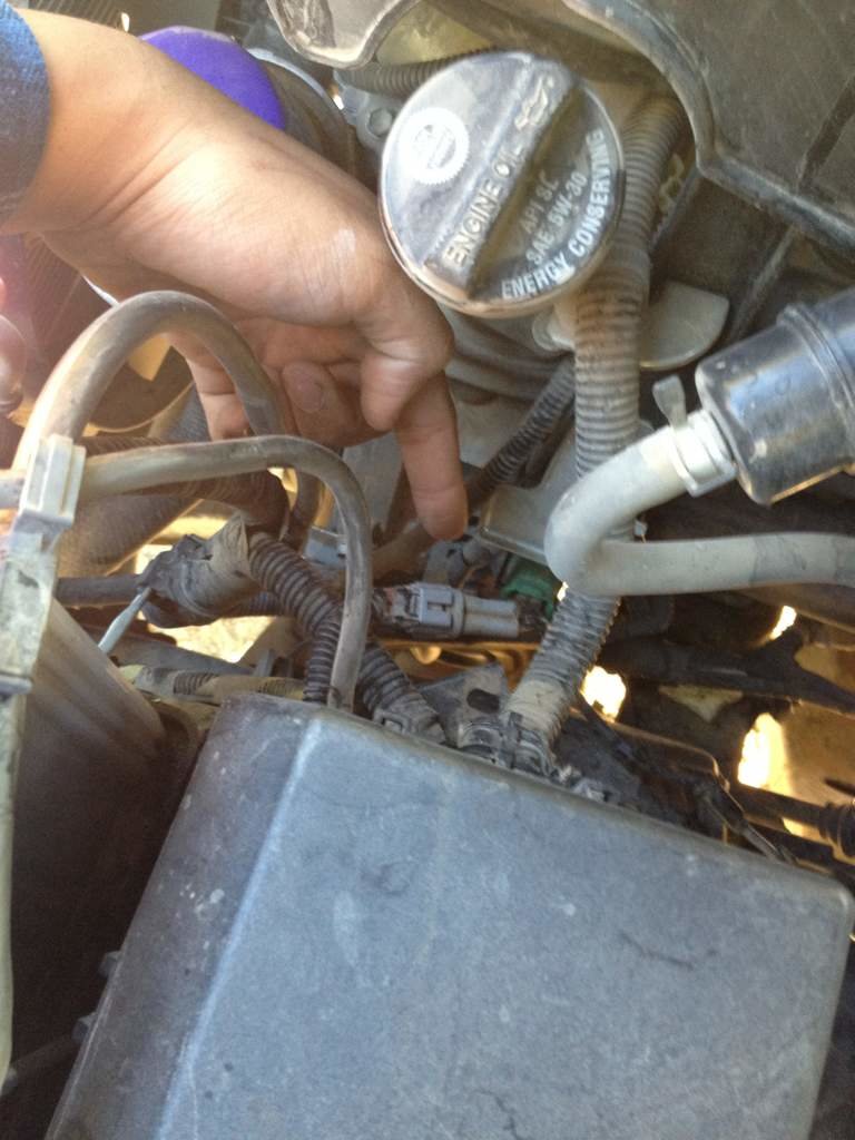

    In the front there two more connectors on little bit below The fuse block and the other below the intake and for me the one right below the fuse. Block was the culprit I take a pic right now.
  10. May 14, 2012 at 7:13 AM

    first pic below intake tube a6935813-12ab-6622_8cedffa996e72ebdcf7bee4fb606093fb7dab76f.jpg
    Second pic this one you can see I had to take it off the mount it was on so I could let it stretch or you can Bend it but this one was the one I had probs witha6935813-12b7-fe8c_28988d0db20eaf385b12a163124afa6592106173.jpg
