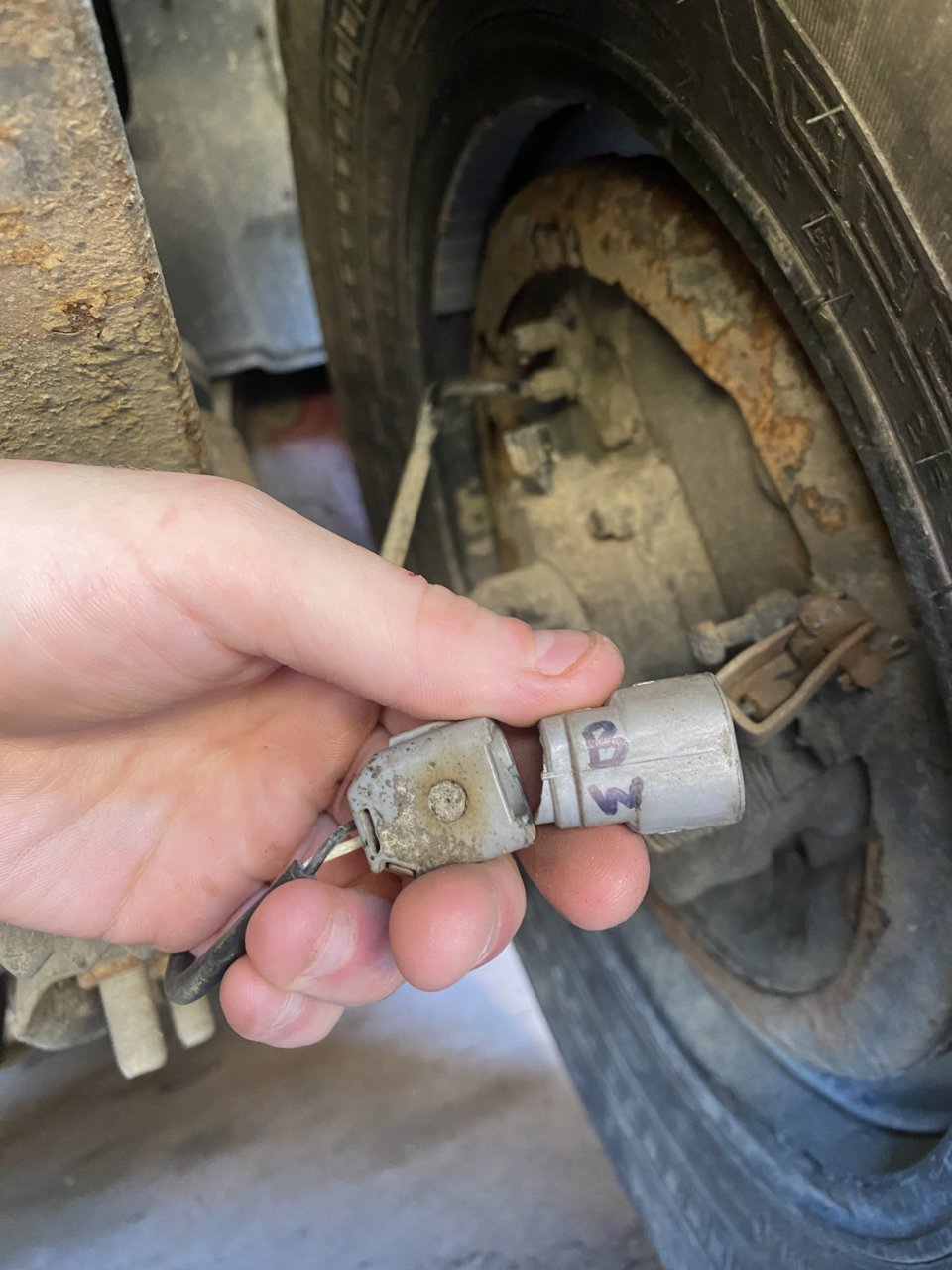

    Hello folks,

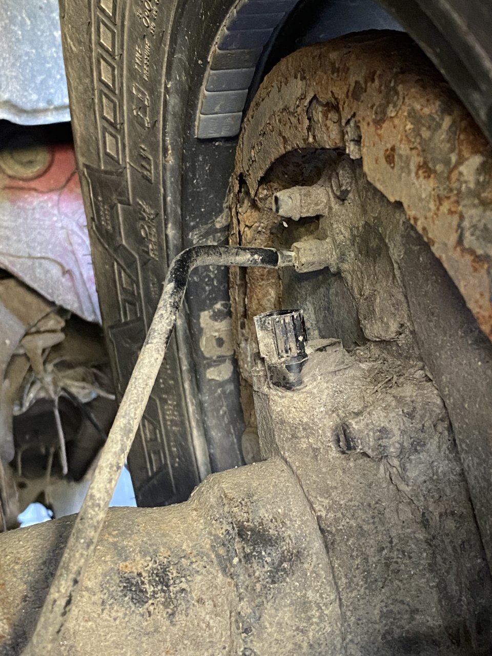

    I ran over a branch in the road yesterday and it caused my Abs light to turn on. Looked under the truck and found the ABS wiring on the rear passenger side of the truck was cracked and pulled out of the plastic clip that connects to the sensor.
    Can someone help me find the PN for the clip that inserts into the sensor? or what is that clip called?
    I used a marker to identify the Black and White wires for when I have the parts to put it back together.

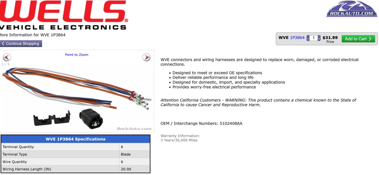

    With some more time between finding the issue under my truck and looking for intel online. I think I may have found the part I need from rock auto.
    Does anyone have experience with this repair? Looks like I can just cut the old wires and replace with this part. I however don't know why the park comes with 6 wires. In my image above you can see it only has two. So two per side but why do they supply 6?
