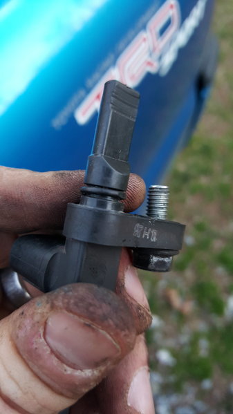

    Ok guys gotta another issue I'm working on. The other day for the first time the abs light came on my 07 Tacoma. When it happened i was making a left turn and felt a slight vibration under the brake pedal as I was slowing down. We'll I jumped the OBD port and got a 32 code. So I reset and it went off. The next time out I made another kinda sharp left turn and it came on again. Then a little ways down the road it went off again and then eventually back on. So next I pulled the front left abs sensor and it had quite a bit of grease on the tip of it and the end seemed to be wore a bit ( as u can see in the picture). So I'm guessing I'll need a sensor but what would be causing this wear. I'd like to figure this out before buying a new one and have the same done to it. U guys ever faced anything like this?

    It looks like the sensor is making contact with the tone ring inside of the hub. Have you checked the wheel bearings. Worn wheel bearings will cause the tone ring to wobble inside the hub, it could also have metal pieces inside from a bad bearing.

    JimmyH I haven't yet checked my wheel bearing. No vibration at all while driving nor can i feel any play with the front end jacked up. Guess I'd better though after seeing this. May not be something that can be felt i suppose

    I would check wheel bearing also can you swap drivers abs sensor with the passengers side sensor?? But heavy side loads will make the bearing show its weakness.Double check wiring for the hell of it.My 2 cents.

    Failing wheel bearing would also explain why it is getting covered with grease.

    I just figured if it was the wheel bearing there would be a vibration or you could feel play in the wheel hub.????

    Sometimes yes most time not.The aglinment between sensor and reluctor ring inside hub is very very close sometimes to close.Tripping the abs on the obd 2.

    Ok. We'll guess I'll be jerking that hub assembly out and see what's going on in there. Don't really know of anything else to check at this point
