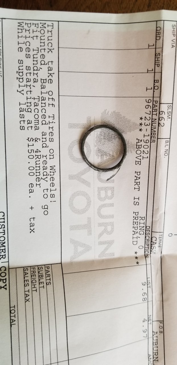

    Follow up to my problem. Thanks to Andy01 for posting that video, it showed me how a simple jumper could be used to read ABS codes.
    I found 2 codes, 32 for LF speed sensor and 44 for deceleration sensor. A little googling told me that if you can get the wheel sensor code fixed most likely the deceleration code will clear as well.
    So having a place to start I first looked at LF wheel sensor, all wiring looked fine and went to remove sensor. It didnt want to come out easy but finally got it. There was a fair amount of rust around sensor and down on the tip. Cleaned everything up and noticed the O ring was damaged, hence letting moisture in there. I or the previous owner had never removed the sensor but a year ago I had a shop install some new SPC uppers and for what ever reason they probably removed sensor and buggered up the O ring.
    Had to order a new O ring from dealer but I've been driving around without it for 3 days and ABS light has yet to return.
    Pretty sure the problem is fixed now.
    Edit: disregard that part number for the O ring I ordered. It turned out to be an O ring for rear wheel sensor and was a different size. Parts dept. couldn't find a replacement O ring for front sensor, so it's off to the hardware store I go.
