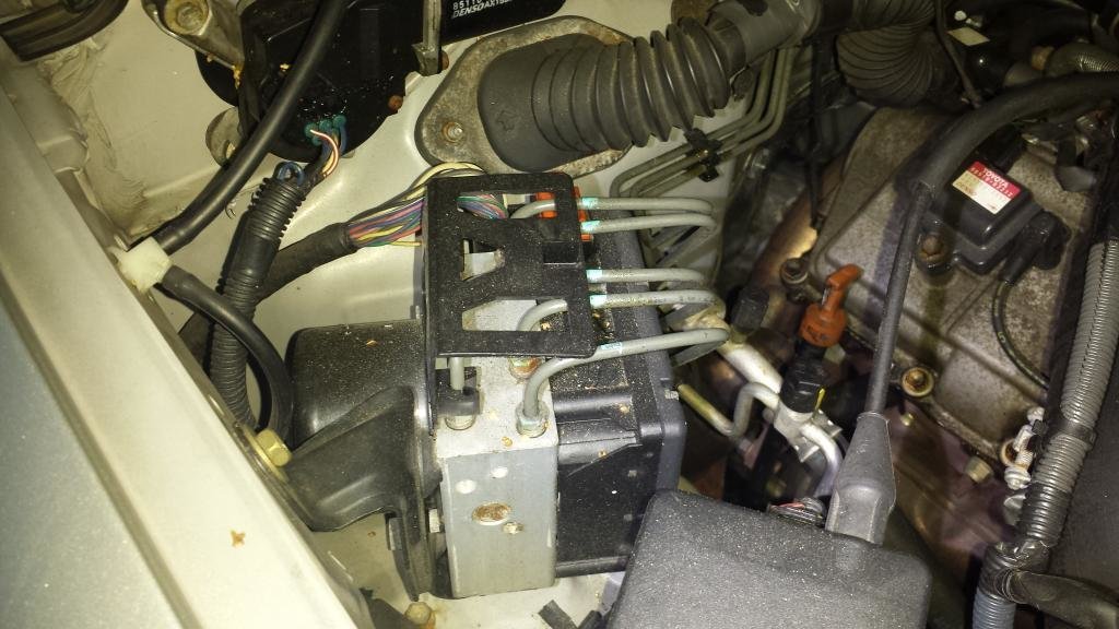

    Mine was fried from a friend welding a bolt to my front diff drain bolt when it was rounded out from the previous owner (dealer). I bought a used replacement unit (just the box/ECU itself) for $100, unscrewed all the hard lines, unplugged the electrical harness and then connected the replacement. I then fully bled the brake system and replaced the fuse and haven't had issues since.

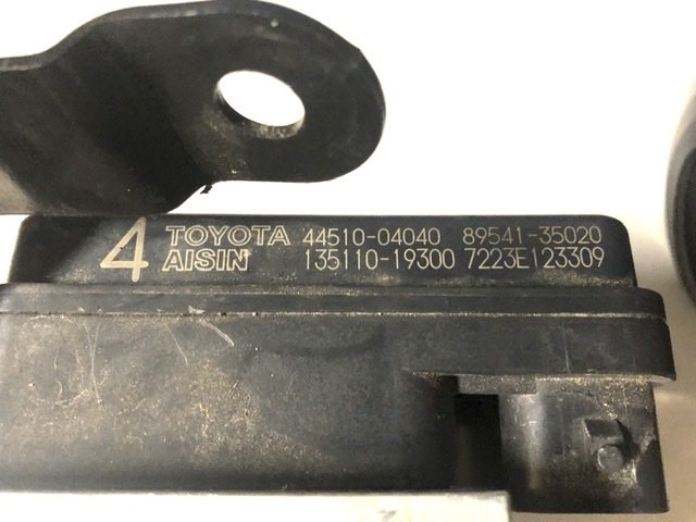

    I’ve got one I’d sell to you if the part numbers match. Here’s mine, it’s already removed from my truck.

    bought from another member on here that was parting out a truck. Get the one above from @DJB1 . Run the part number to double check compatibility with your truck.

    The numbers I got on mine are 89541-04010
    25.0946-01193
    84440-2310
