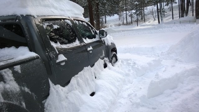

    I know it has been said on here many times, but tires make a huge difference for ABS. My stock tires and ABS were a joke in the winter; my studded snow tires changed everything.
    I lived at the end of an isolated 10 mile road at 3200 feet in the WA Cascades that was always covered in ice in the winter. Needless to say I have driven in some interesting winter conditions :) 6sz9xe_ab675556a5e20ea282235ede542afbab66dc4037.jpg[/IMG]

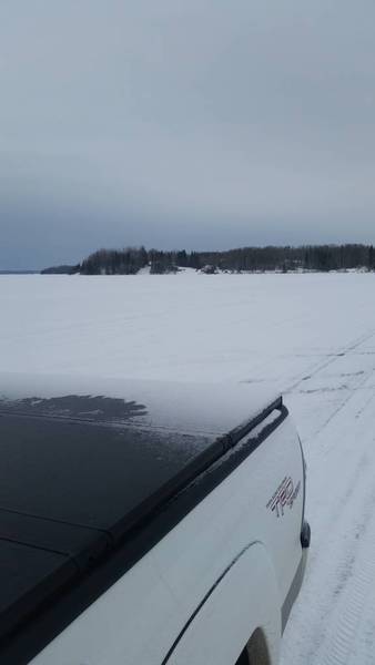

    Here is a pic of a set of winter studded tires I have used for 2 years now .
    No issues braking , no issues with traction or cornering . I just took these pictures driving over a frozen lake .
    Studs make the tire work well .Notice how the tread is directional and not as luggy as the older winter tires , Technology has come a long way . Here is the review I have no issues going through deep snow with some extra weight in the box of the truck .
    Driving on a frozen lake

    My bad . The reviews I did are 2 years old now .
    At the time , the Utra Ice grips were at or near the top .
    I went with those because they were the only tires available in my area .
    Just wanted to stress how important it is to use a tire that works with your climate . In my case , 9 months of snow and ice make a winter tire a necessity .
    I will post pics when I have to chain up:D
