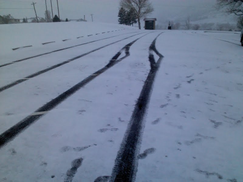

    I did this test 4/9/2013. On the left is ABS enabled, on the right is with the ABS fuse pulled. With ABS enabled I came to a stop right about where I'm taking the pic. By the lines painted in the parking lot you can see it took a lot longer to stop with ABS, but a nice straight line.
    ABS fuse pulled, I had to pump the brakes once to keep the truck from diving further downhill, but came to a stop in less distance. I was in neutral with/without ABS.
    Myself, I learned where the threshold is for ABS to kick in and tried to not stomp on the brakes to GET TO that threshold. Also, I pop any vehicle into neutral (or clutch disengaged) before trying to brake on snow.
