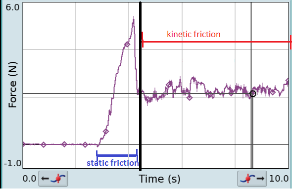

    Just to clarify, a tire that is not sliding but applying braking has a higher coefficeint of friciton than one that is sliding. An ABS system should reduce stopping distances on any surface that does not pile, regardless of the physical properties of the surface the friction of two surfaces in constant contact (static friction) is greater than two sliding against each other (kinetic friction). It's physics. Surfaces that pile include Snow and Sand. Ice and dry pavement do not pile, and thus a properly functioning ABS system will stop you faster on these surfaces than hammering the brakes without ABS will.
    However, if the ABS isn't functioning properly then it is possible sliding will stop faster than ABS. That's the issue here. My Tacoma's ABS works fine. That doesn't mean there aren't places where it would fail or other Tacoma's that had there ABS modules programmed on a Friday that are just plain failures overall.

    Rotating tires have a static contact point with the road and sliding tires don't :rolleyes:. Once your truck is sliding it's easier to move than it was when you first tried to get it to move if you locked the brakes. Try pushing a heavy box on a concrete surface and you'll have this epiphany.

    A moving tire has a static contact patch with the road. This is because the part of tire in contact with the road and the road are moving at exactly the same speed in opposite directions. This gives a net velocity between the contact patch of the tire and the road a value of zero, hence static friction applies. When you slide the tires contact patch stops moving but the road does not, and the difference in velocity means that kinetic friction applies. The coefficient of friction for a static surface contact is always higher than that of a kinetic surface contact.
    Since ABS keeps the contact patch at relatively the same speed as the road, ABS can take advantage of the higher static coefficient of friction versus a sliding tires kinetic friction. This is why ABS was invented for high speed planes to shorten stopping distances on all surfaces. It works on ice, dry roads, and gravel when properly tuned. I'm thinking the problem with some trucks is the ABS is off in lala land for some reason. My 2013 TRD Sport Tacoma has a well functioning ABS IMHO, but that doesn't mean there isn't a problem with other trucks.
    The only except to the rule is not even a real exception. On snow, mud, and sand a locked tire tends to pile material in it's way which stops the vehicle a lot faster than ABS. It has nothing to do with friction, at that point you're taking about plowing not stopping. This one of the reasons why disabling ABS offroad makes complete sense to me.
