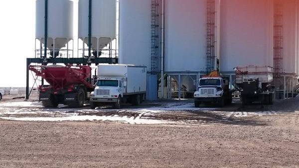

    Yes, my cargo van...
    And my other "vans"
    ... as usual you know nothing about trucks, you can't even tell them apart from vans ;). Now back to more circle jerking around Tacoma ABS software glitches.
