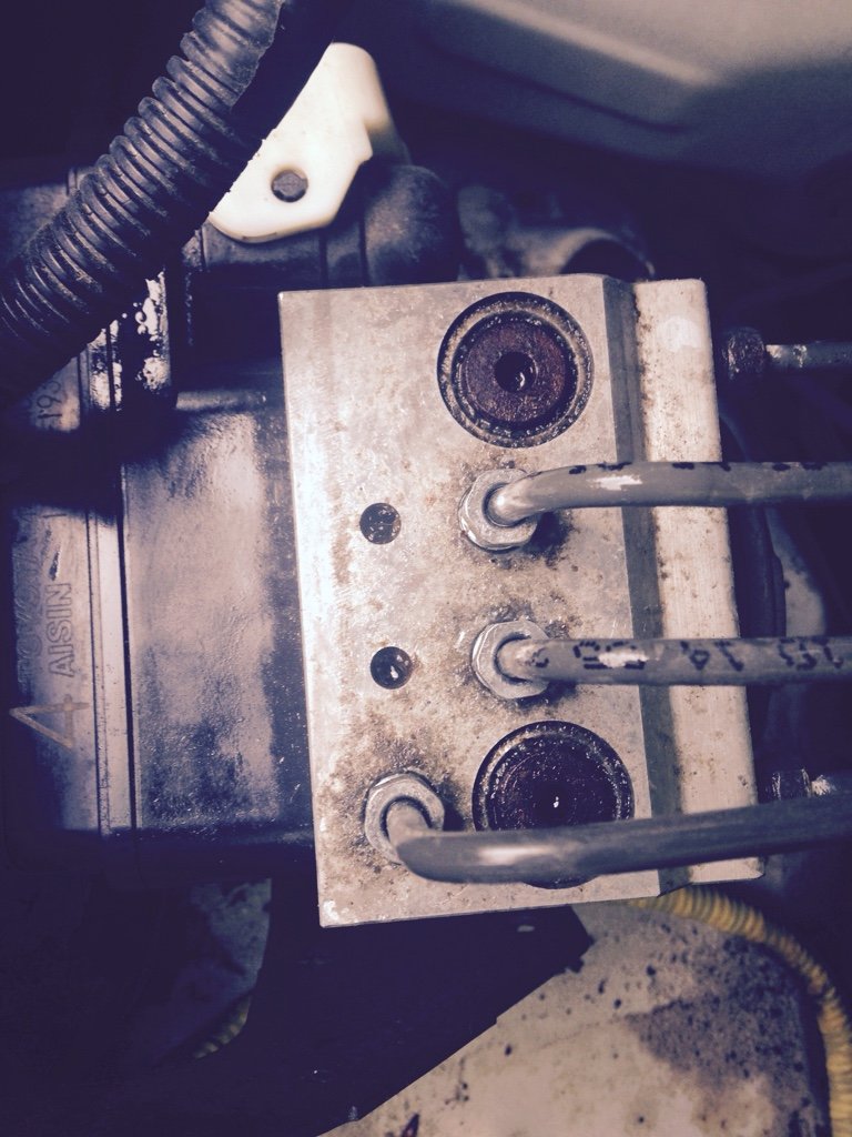

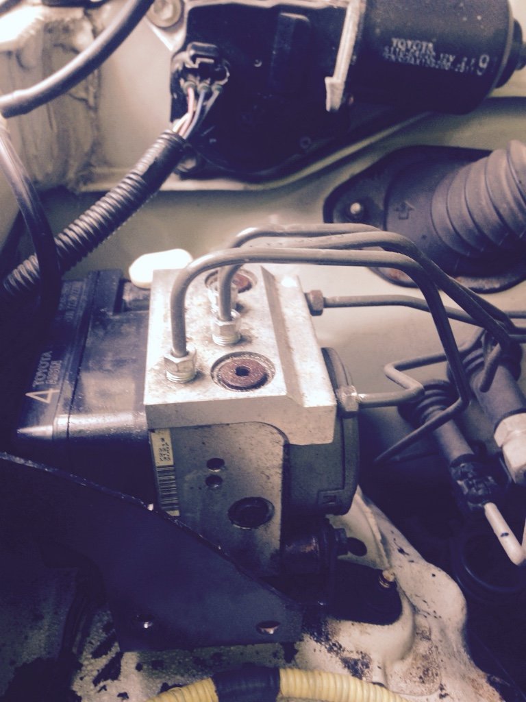

    512dde4fb8c5abe5783865613e63784f_547cf633ddffbe1a3405d65da8932eb7192476df.jpg211b737b529611cb2fc5d99d40767cfc_7b6bf8ec4b310dfecaf3c68aef2f3eede6f422f4.jpg
    Hopefully the pics attach right to this. The leak is from the top of the unit...not sure exactly where as I can't be out looking to see where the fluid is coming from and pressing the brakes at same time.

    You might try removing the lines and remove the abs manifold from the pump and check / replace "O" rings then re install and tighten all fittings also check for TSB my 13 was replaced under TSB.
