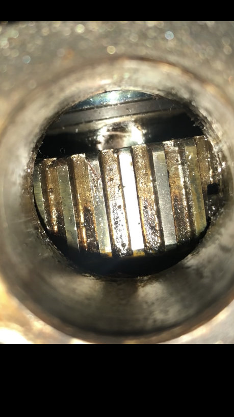

    Upon further investigation, the toothed wheel seems to be centered the same on both sides of the axle. That being said, it is positioned slightly towards the the inside, away from the wheel. 5265D717-07F8-4529-8DA3-266D1F632638.jpg

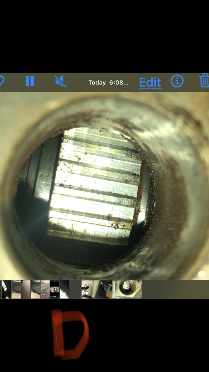

    CAD5E5C3-2E3A-4EBA-9F5D-D84CAD1D05DE.jpg This is the drivers side.

    That Tone Ring is close enough to center I’ve seen them further off than that and still work fine. plus replacing the seal would not cause the tone ring to move on the axle.
    To move the tone ring would require putting the axle shaft in a press
    The tone Ring does look a bit dirty I’m surprised they didn’t clean it off to get the gear oil off that being said a dirty Tone ring shouldn’t cause this issue.

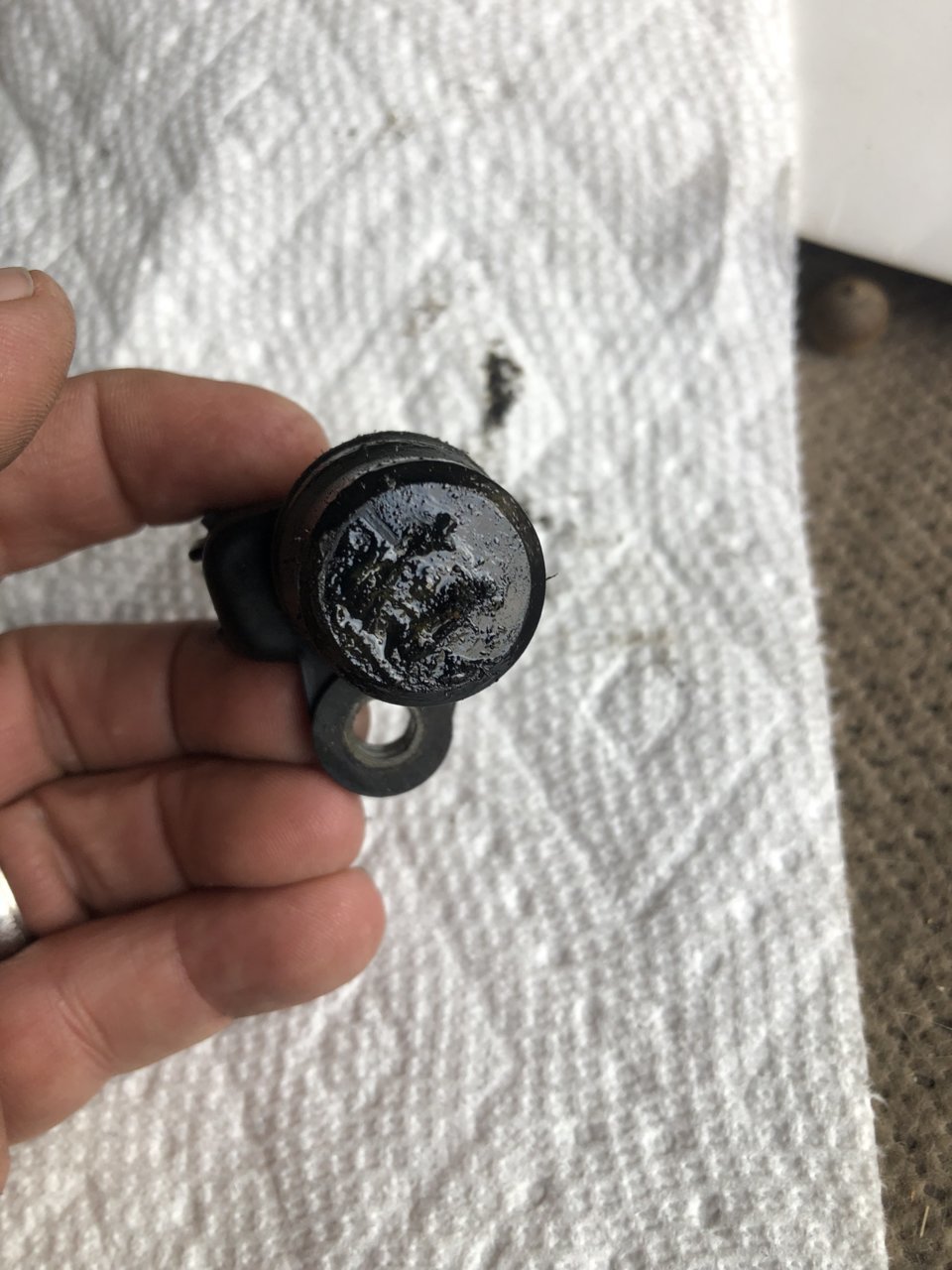

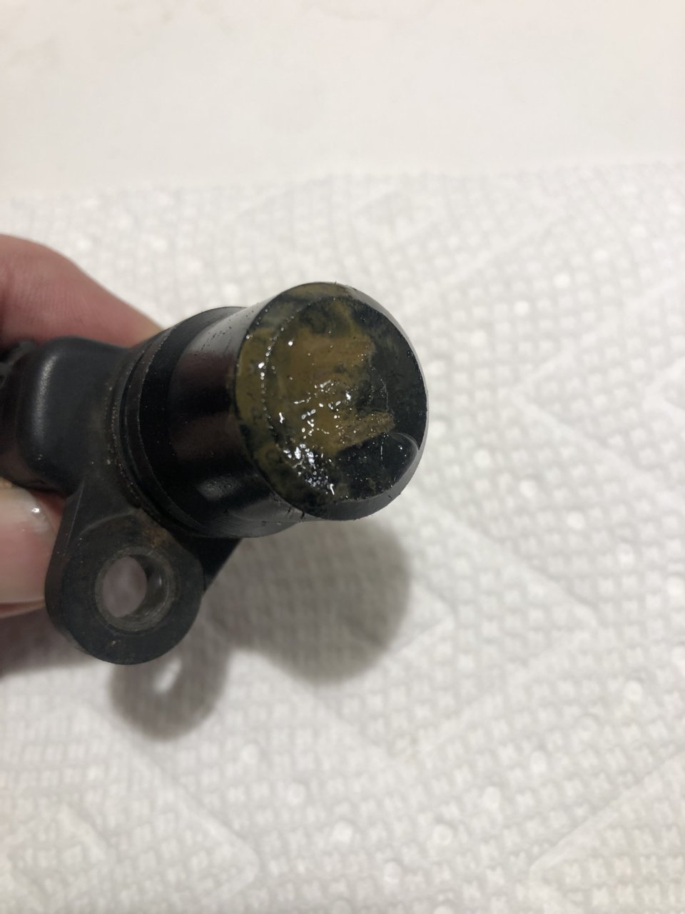

    Gotta update on the situation. I replaced the sensor with a Delphi unit from rock auto( thanks 1schoir)and went for a short test drive. Problem seems to be solved. A little more time will tell. My concern is this, when I removed the old sensor, it looked wet with water and some milky oil. Could water be getting to the area where the gear ring is? 2E0B6EC1-3694-48DA-885A-385D28E08A81.jpgAny help would be greatly appreciated.

    When was the last time you changed the rear diff gear oil?

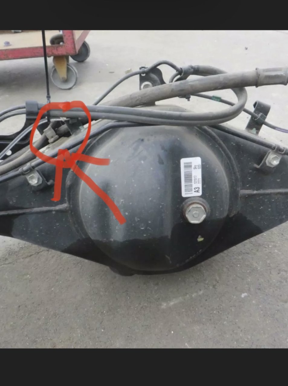

    The diff has a vent on it, which water can get into if it's failed. They usually clog though and lead to the axle seals blowing out and letting the gear oil get to the tone ring. Sounds like you're due to for some new axle seals at a minimum. The axle seals are actually a pretty DIY friendly job.

    Well, it was actually the leaking passenger side getting replaced that started this whole journey. I guess next thing on the list is checking the vent tube. I’ve been meaning to get around to changing the diff/transfer case fluid for a little while.

    Pull the drum off on the side that looked wet see if any gear oil has made its way past the seals and through the bearing.
    Might need a seal on that side also.
    Check the axle vent make sure the top part spins freely if it’s stuck or plugged it could cause the axle to over pressure and leak past the seals.
