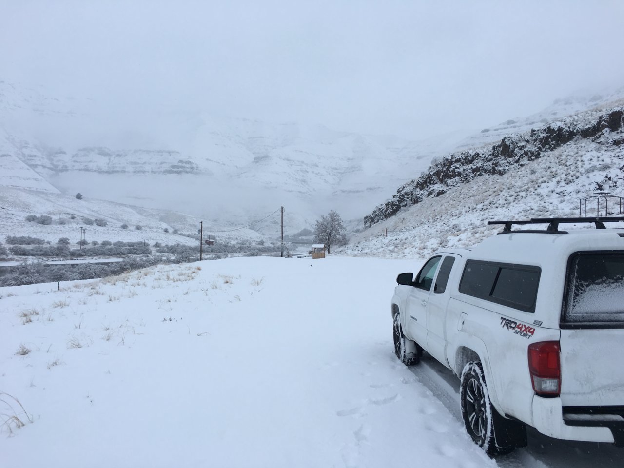

    Driving into town in cold snowy conditions when the dashboard lit up. ABS system failure, check brakes but no check engine light. To make matters worse, 2WD-4WD mode change failure. Took it to the dealership. After 2-1/2 hrs of diagnosing the various sensors, they said it was the sensor on the differential and it would take 3-4 weeks to get one in. It's pretty disturbing to find out that if a sensor, (or the wire harness) fails, one can lose the use of 4WD. It makes me miss my old 1990 Toyota pickup with manual hubs.
    My question: does anyone know of a way to over-ride the programming to allow me to use 4WD while waiting for the replacement sensor? IMG_1181.jpg
