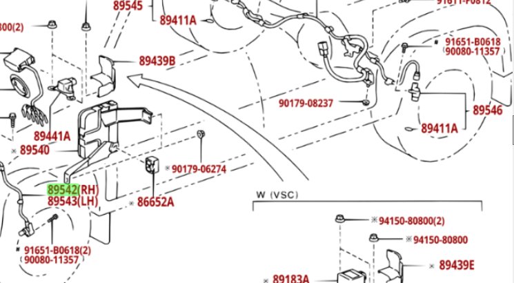

    90080-11357 is what you need. It's the same for the front or sensor.

    I work at dealer and that's just snip of a picture from my pars catalog.

    If your part number is the same as the Rear ABS Sensor on a 2003 PreRunner DCab TRD 3.4l 4ATM...then it is a 90080-11357 (most current supersession) M6-1.0×20mm ≥Grade 8 Hex Head (10mm Hex Head) bolt with a flat washer and split lock washer. I recently twisted one when torquing to 60in•lbf (FSM calls for 71in•lbf).
