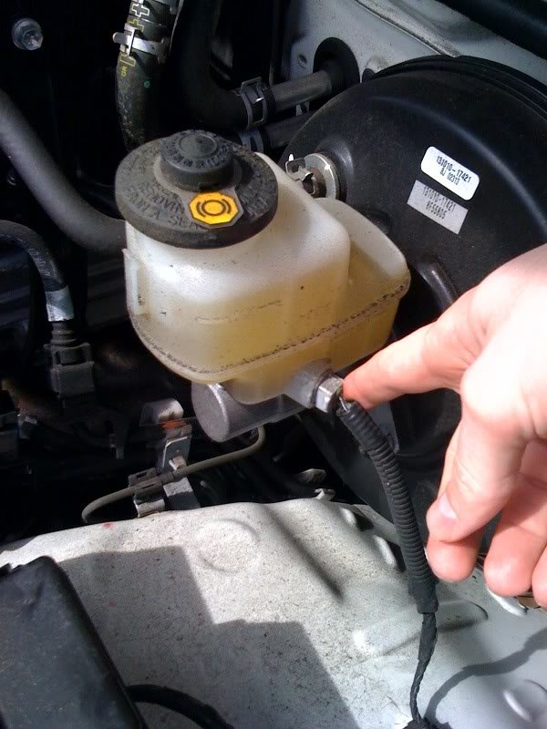

    Try pulling the vsc/abs/trac plug from your master cyl and turn the truck on. You should have all the light turned on. Then shut your truck off and plug it back it. If nothing is wrong then your truck will have all the lights off again. If the sensor is messed up or something is wrong they will stay on. Then your going to want to have the numbers 0'd out.
    As far as getting it fixed, if your abs is out just be aware that your running without abs and may be only just one tire that is the issue. This could cause somesafety problems so I would be cautious. And when you do a lift you have to do alignment anyways so get it done.

    The vsc/abs/trac plug I'm looking for is the plug/wires that run into each breaking system correct?

    Pull this and start truck

    It should then look like this

    Turn truck off. plug back in. Start truck. Should look like this

    I dont quite have the same set up as you pictured, but I unplugged the wire shown and tried it. (break reservoir) No luck unfortunately
