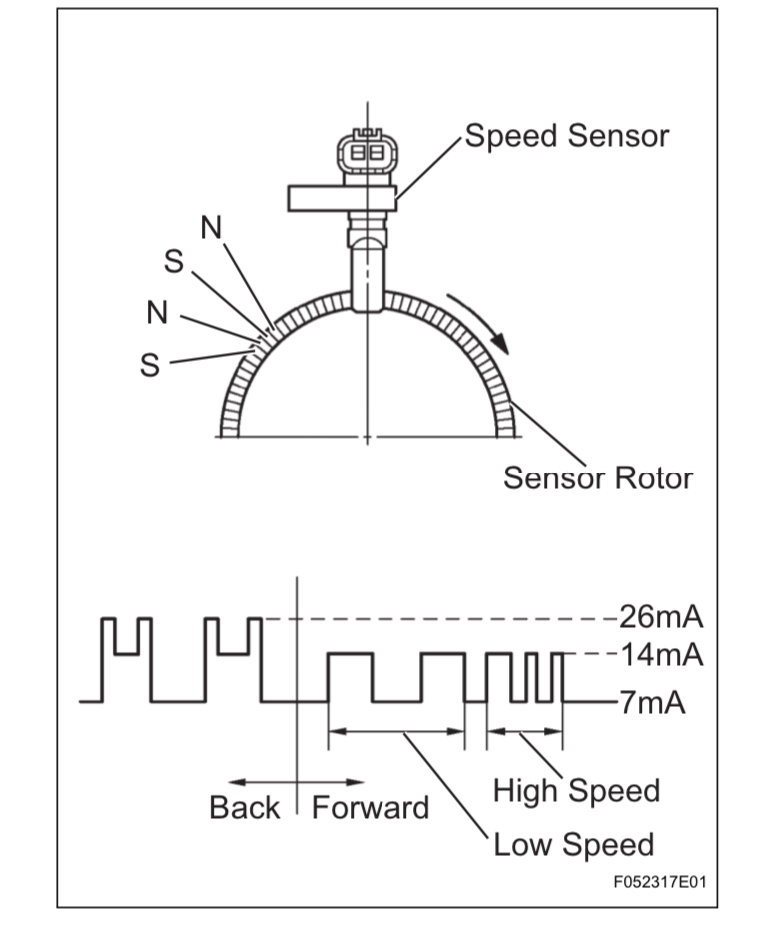

    They aren’t test. That’s the criteria for making the ABS Light come on for the Speed Sensor.
    I was just kidding about testing #8
    If my understanding is correct, if you go 62mph or faster in reverse, the light will come on.
    That’s why is said, who’s going to “test” it and find out?
    Lol, not me.

    The sensors are side sensitive ( Drivers & Passenger sides ) and if you install a right side sensor on the left side the polarity will be reversed. That makes the system see that wheel is turning backwards the same holds true for the bearings.

    I wonder how one would even go about diagnosing something like that, I'm pretty sure the speed values in scan data don't differentiate forward and reverse and looking at it with a scope would only show that the signal is present.

    You 2 are smarter than me.
    But it looks like the m/a 26 vs 14?
    I might be wrong? You can correct me. I love learning this stuff.B1F10DE2-271E-47ED-A14A-F5EFE742A064.jpg

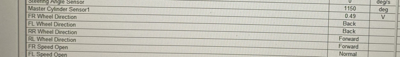

    Yep they do, straight from tech stream on my truck. Long story short, my custom spindles have the mounting orientation swapped and I just went through this last week.

    Well that's handy, I've never seen that on other makes they just show speed in MPH and/or RPM not direction.

    I think it has a lot to do with the advanced traction control (ATrac)and off roading. It’s able to detect roll back and brake/traction control accordingly.
