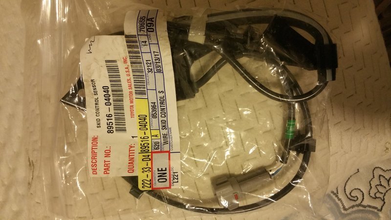

    I just went through this headache. Replaced two LF sensors, only to find the harness was ripped up higher. I actually have a spare harness....
    This is what you need

    How much do you want for it?

    I did this as well, but I ended up splicing open the harness I stretched and found where the wires were disconnected. Solder them back up and it fixed my problem.
