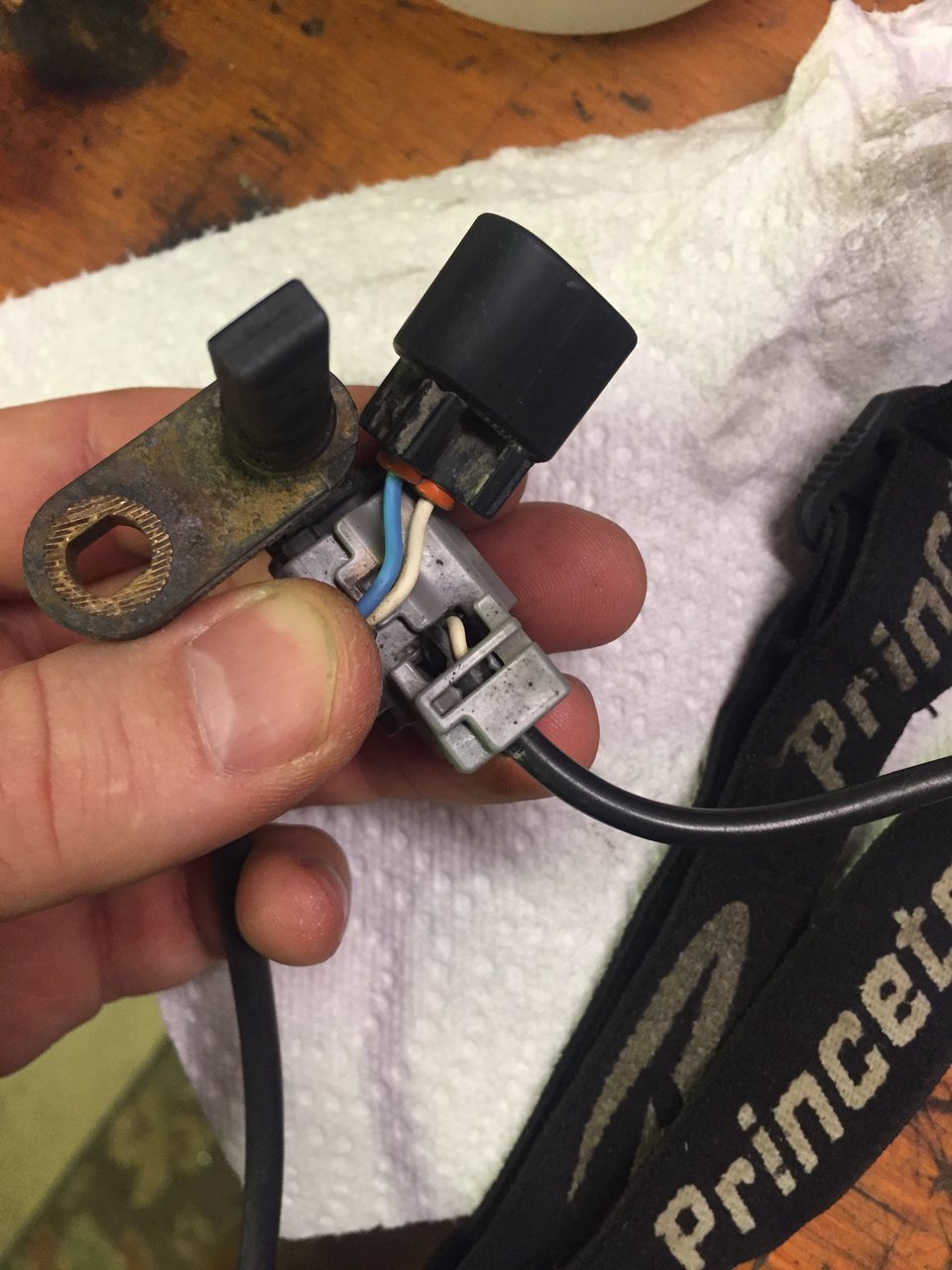

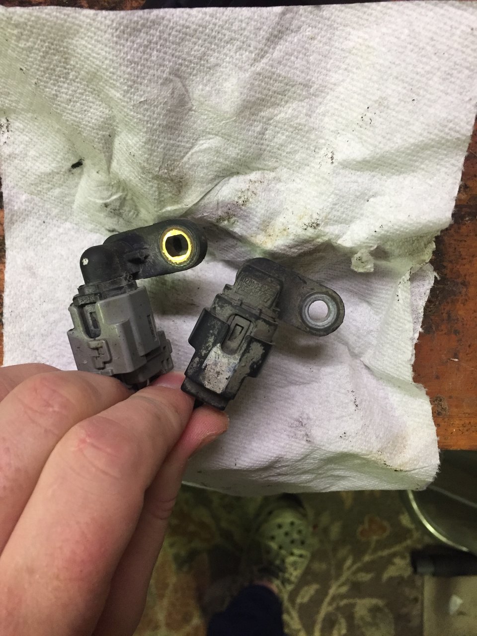

    I need to replace the rear ABS harness on my truck. I went to my local wrecking yard and they only had a Tundra rear axle I could pull the harness from. The main harnes plug on the frame was comparable. I noticed the ABS sensors were slightly different.
    Will this work or did I waste 20$

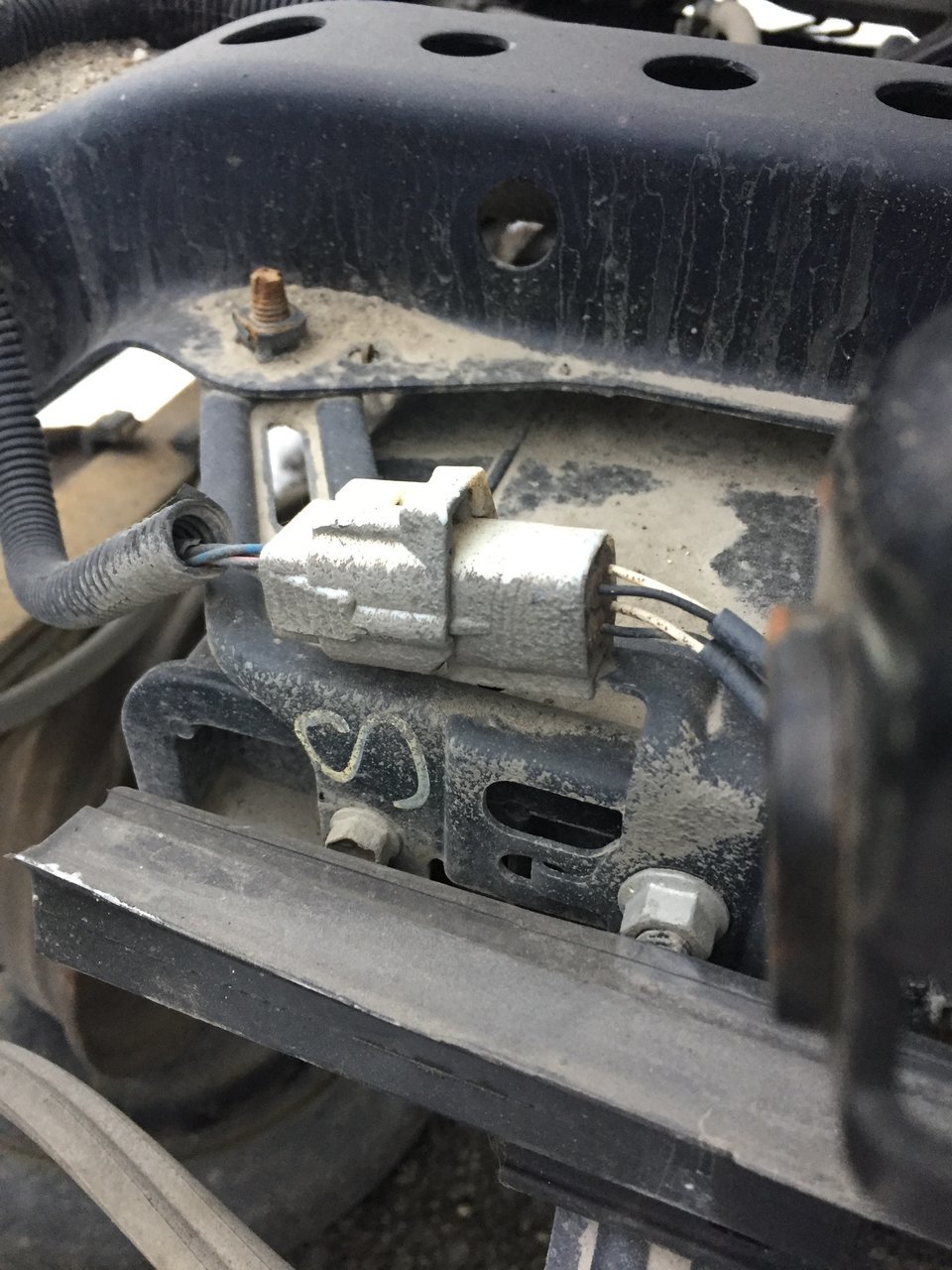

    Frame plug that is interchangeable:
    Grey plugs are tundra black is tacoma

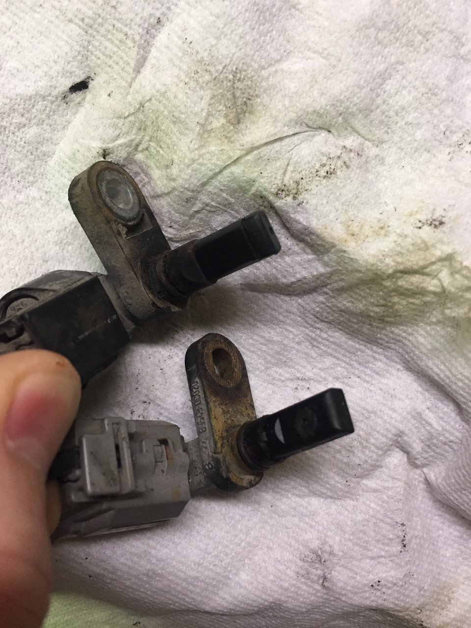

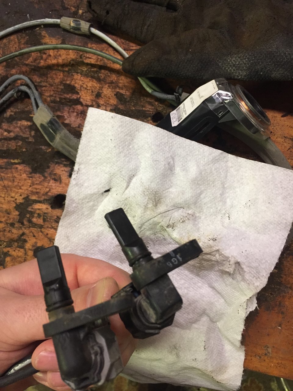

    The differences I can tell:
    - tundra plug is grey square and the Tacoma plug is black oval
    - the mounting hole on the tundra is oblonged and the Tacoma hole is circular
    - the bottom face of the tundra sensor has a circle on it and the Tacoma sensor has a notch out of the tip

    you need to ensure the ohms are the same and the tundra abs sensors activate at the same rate as the tacoma.
    need to find service manuals for that or hope someone here has done this.
    since the tundra.4runner,tacoma share some of the same platform, and 99% of the sensors are interchangeable, I would say you are good.
    Personally, I would do my testing before I threw them in.

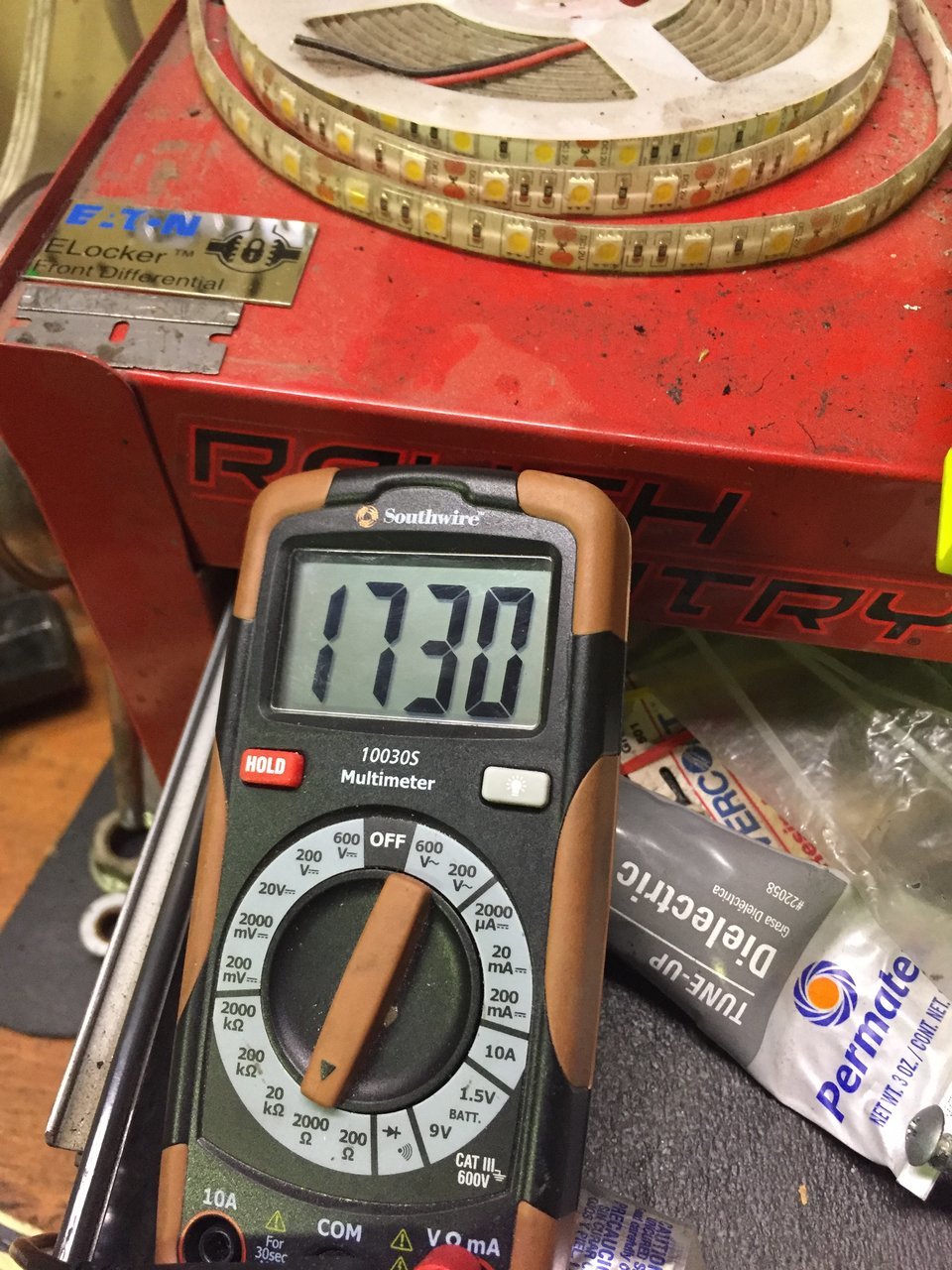

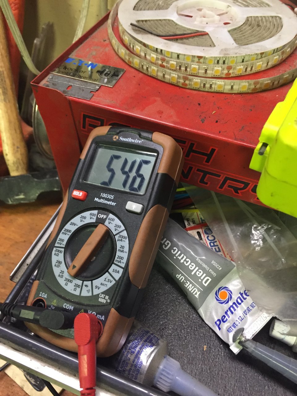

    Here are the numbers I got. Wayyyyy different
    Tacoma resistance:
    Tundra resistance:

    which means the sensors operate under a different signal. The Tundra has bigger brakes and a bigger sensor ring. which would make sense that the numbers are different.
    I don't think it will work. just for shits and giggles you could install them and see if it all works.....the ABS light will stay on if it is still not working.
