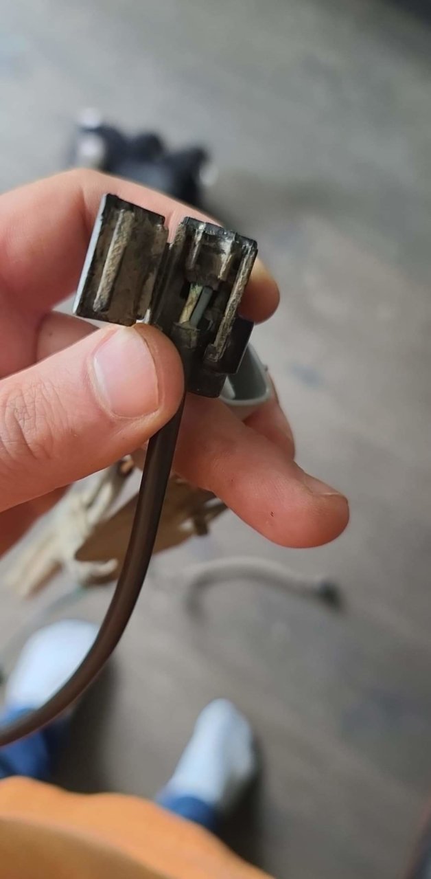

    So I pulled out the RR ABS sensor, which looked fine, but I just blindly ordered one thinking this would fix the issue. The Chinese knock offs on ebay are like $14, or you can buy the OEM which is over $200, I went with China here. When it arrived, the sensor looked -identical- to what I pulled out of my truck. Swapping them did nothing to relieve the error codes or turning off all my dash lights.
    So this was a lesson learned: make sure if you buy a part that the part you are replacing is actually the problem! From this point, I wanted to make sure the ABS sensor was really the issue, so I swapped the RR and RL ABS sensors (I didn't screw them in) and ran the codes: it was still the RR error codes. So the ABS sensors are likely fine I assumed, and it must be either something to do with the toning ring on the RR side, or the wiring harness. The wiring harness looked great but that may not mean anything. I borrowed a continuity meter from work, and unhooked the wiring harness from the two rear ABS sensors and where the harness connects to the main harness (located above the spare tire). Checking the continuity of each of the 4 wires: one had no continuity and it was on the RR side..

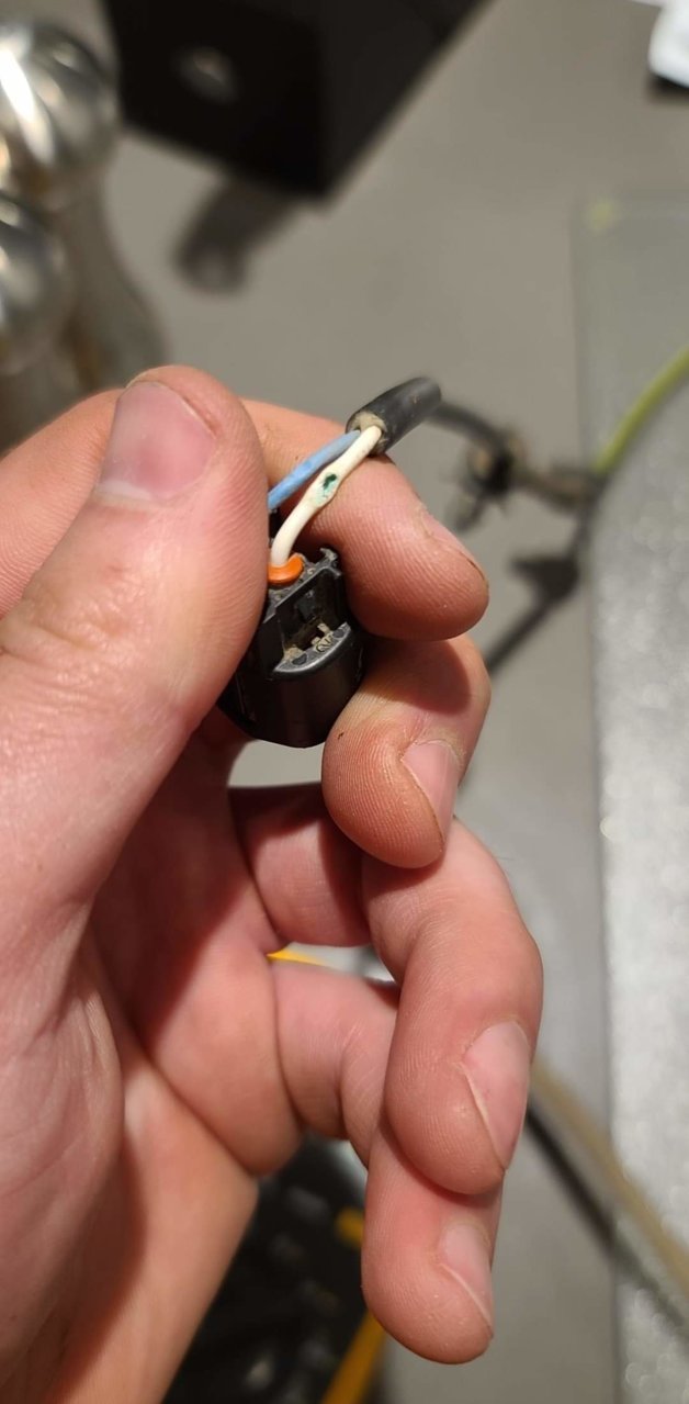

    I took the wiring harness completely off for closer inspection and everything looked great. But I did put in new leafs 2 years ago and maybe I stretched the line out and the failure point would likely be inside the ABS sensor connector. So I took the connector apart carefully and....
    Right where it bends around the plastic on the inside, the insulation wore through and the wire was replaced with green copper oxide. There was dirt packed all inside this connector, so mild vibration would have done this in over time. I double checked and this was the wire that had no continuity.
    This is beyond my ability to fix, I'm no electrician and the wear is in a weird spot, so I am now ordering a new wiring harness.
