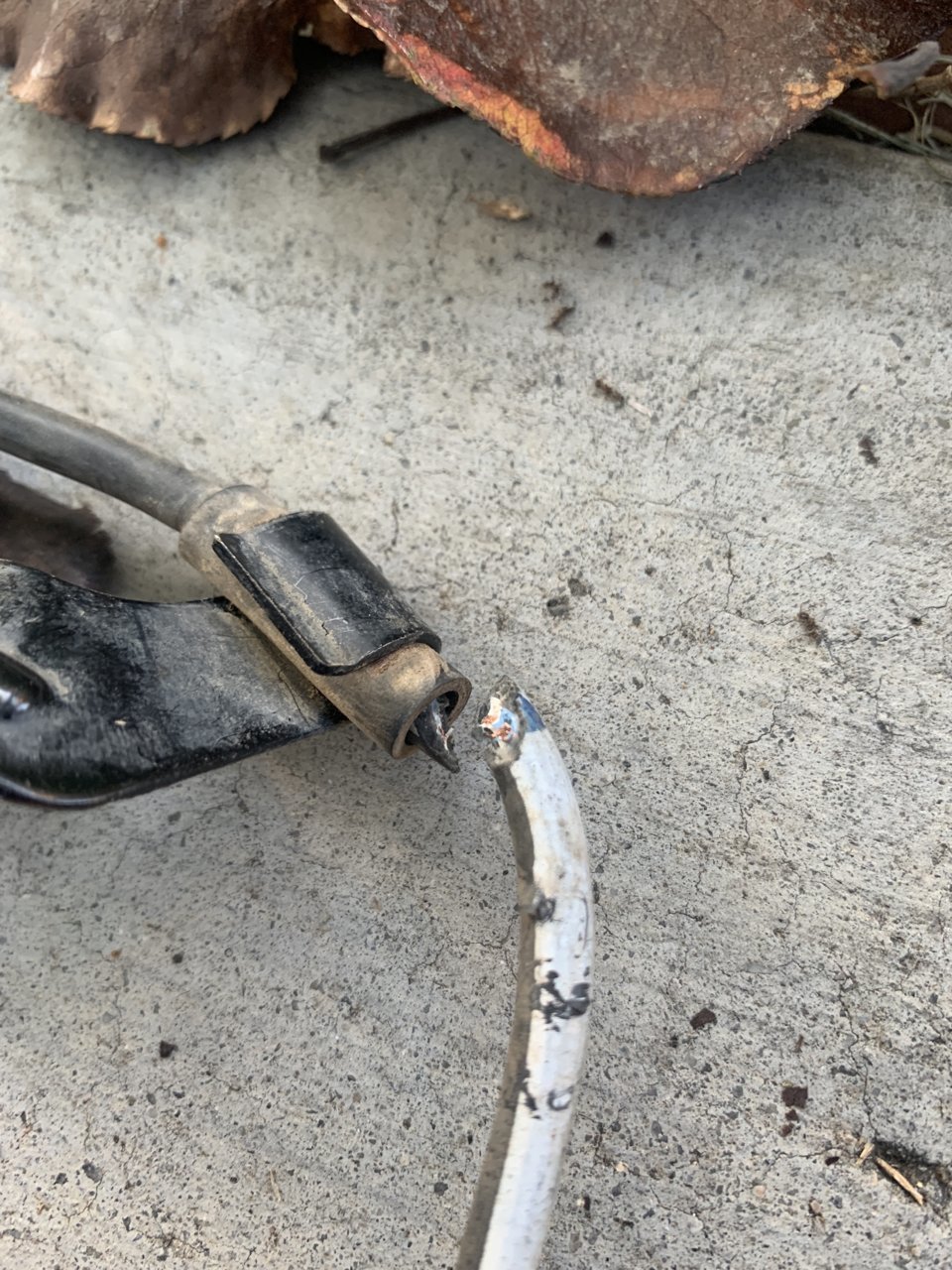

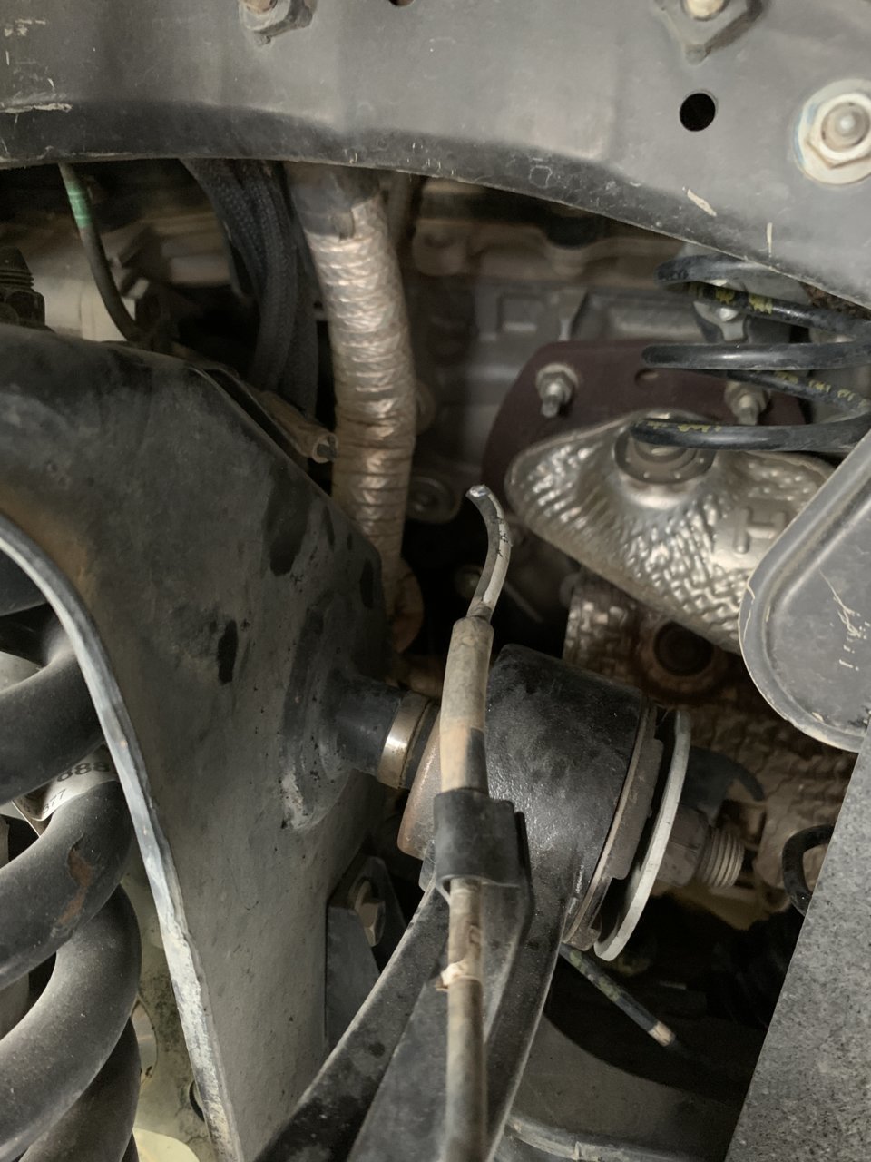

    My truck was sitting for about seven days since I last drove it. No issues before hand. When I started the truck my vehicle collision system traction control and ABS lights were on. The only thing I installed while the truck was not being driven was a rear DIff skid so I thought that might be what did it. But then I found the driver side front ABS line severed either from overextension, cut, or rodents. Let me know what you guys think...
    keep in mind I wasn’t off roading at all and the truck was parked.

    That’d be rodents. He was sitting on your UCA having a chew.

    Hahahaha I honestly thought of that when I first came out to it. The uca makes a great little platform especially the flat SPC UCAs

    Rodents
