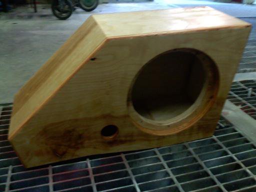

    You can build a sealed or ported box "tacoma box style" with 1/2 birch ply and be stronger than 3/4 mdf.
    Also with how the box is structured you will not need any bracing with under 1000wrms
    As for the vented pole, yes give it a little room and it should be ok.
    With the proper designed box, minor seat mod you can easily fit a sub with under 6.5 inches of mounting depth.
    The passenger side however will not have enough airspace for you to port any sub over a 8inch optimally, and a 10 semi optimal but would still suffice

    Yeah we use the 12 ply baltic birch on all our big builds as some of the baffles are 8 layers + thick and the side walls are 4+ so you can imagine the weight of using 1 inch mdf. Its stiffer, stronger and more resistance to flex than mdf and so much lighter

    Both actually work just fine and doesnt have any big difference that will be noted in a tacoma type setup. Birch ply is not like regular plywood, and you can look for shop grade as well to reduce the cost as its only a 1 side finish
