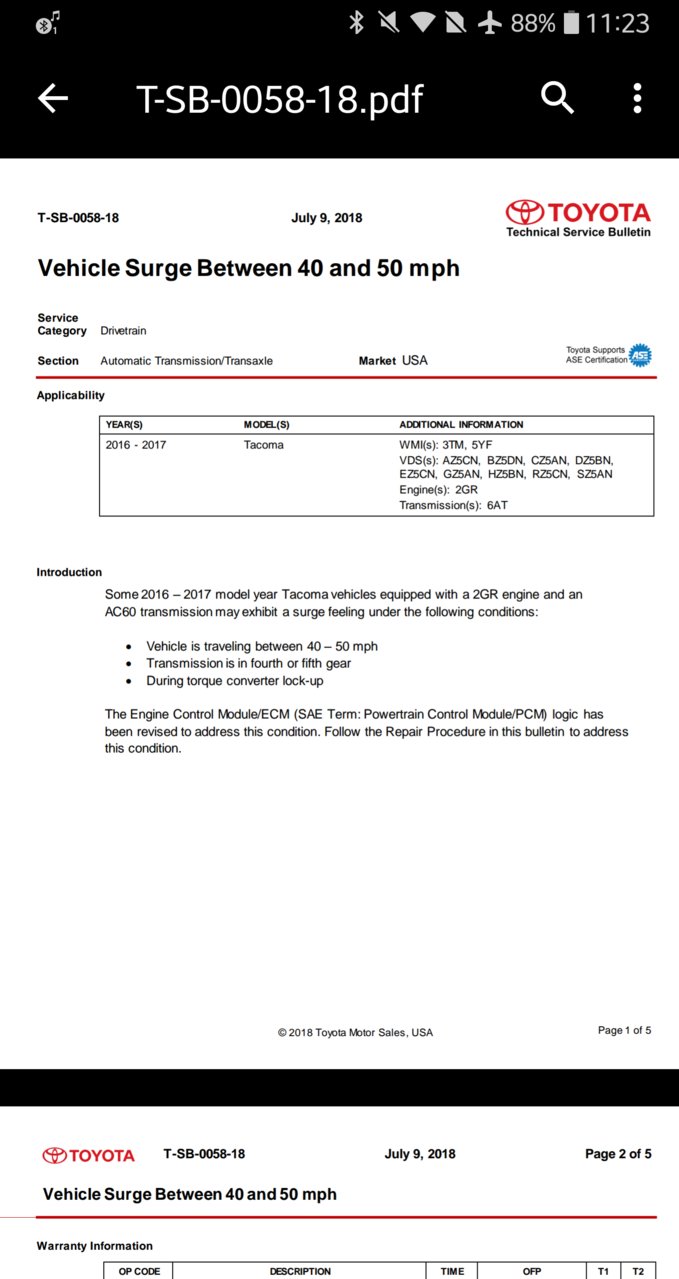

    Capture+_2018-07-12-08-52-23.jpg Found this. Anyone able to confirm this?

    there is a new one: 9 Jul 2018........Vehicle Surge Between 40 and 50 mph.....T-SB-0058-18

    Which model years is this for?

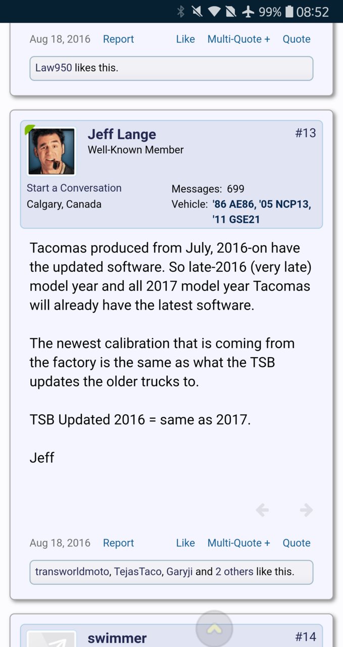

    I have a 17 that I bought in November. Took it in last month for service and requested a check regarding the TSB. Tech listed on paperwork a check of the ecu shows the truck already has the software update.

    2016-2017
