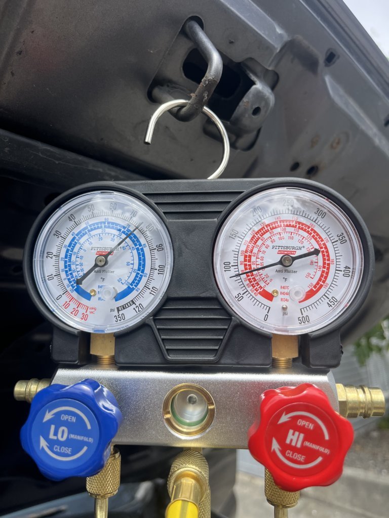

    Is it possible I have low refrigerant due to no use for 1.5 years? Would that disallow the clutch to work and prevent the compressor from working?

    Refrigerant has leaked out thus the compressor not turning on, would need to hook up gauges to confirm this.
