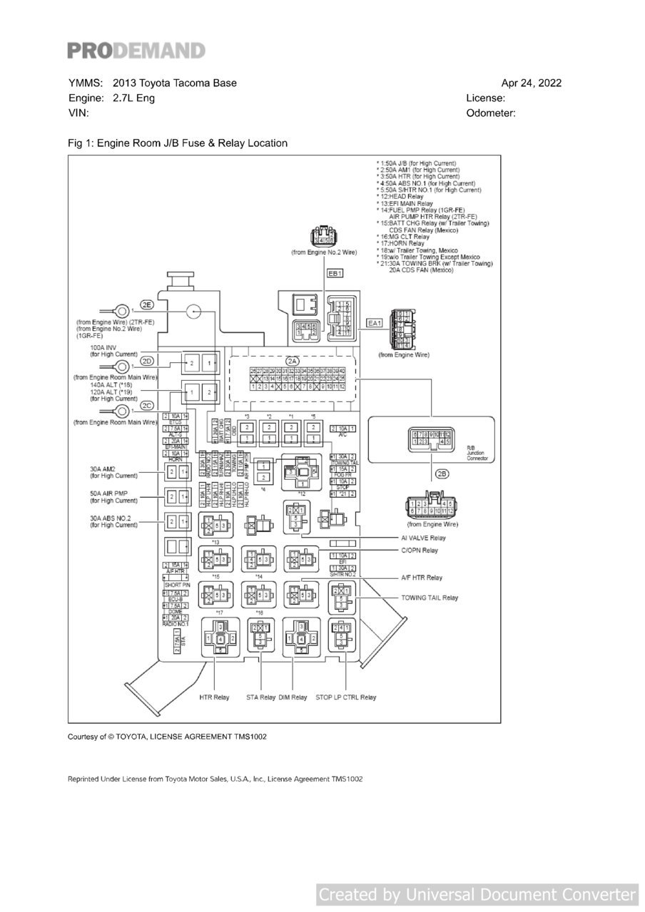

    I think think i checked the correct fuse. Can you help me identify the correct fuse ?
    what else can it be ? What else should I look at ?
    thanks in advance

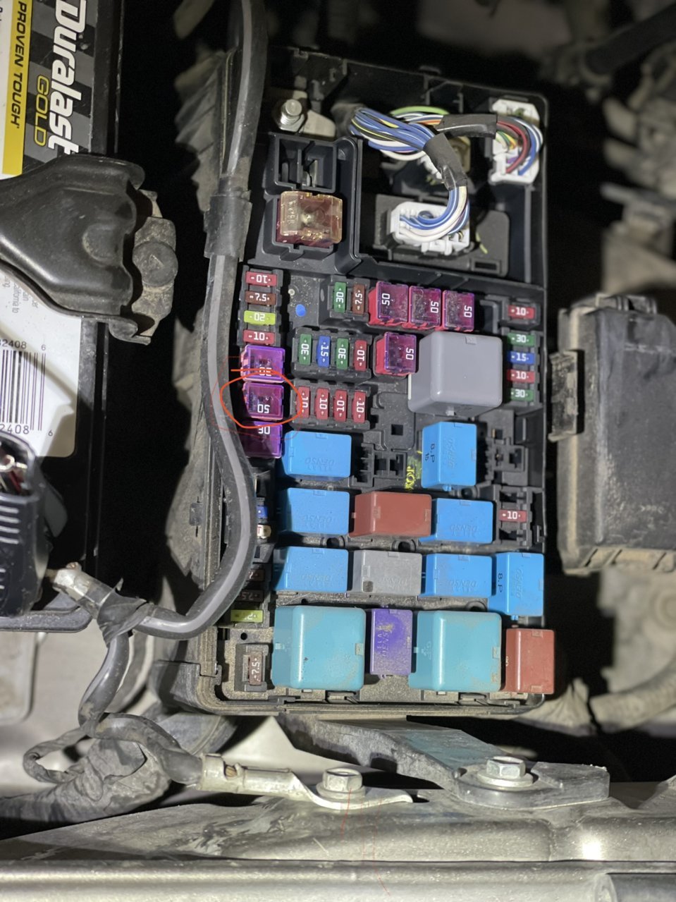

    my fuse box looks a little different. see picture.
    can you point out which 50a fuse ?
    also they dont just pop out. Is there a trick to getting them out ?
    i pulled on a couple of them with needle nose pliers and they lift up a little. I see little clips on the sides but I can’t imagine how to get my fat fingers around them to undo the clips.

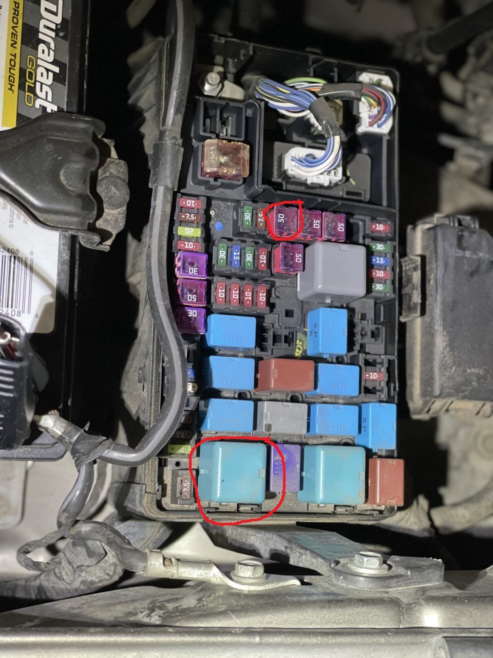

    Should be the 2 I circled assuming you have a 13 like your profile says.

    I circled the fuse I believe is the right one. mis that right?

    That one is for the Secondary Air Injection Pump.
    You should be able to visually see if the fuse is blown or not.
    If the fuse is good then you will need to go to the blower motor, you can give it a couple taps and see if it takes off. If it does you need a blower, if it doesn't then you will need to see if your missing power or ground at the motor.

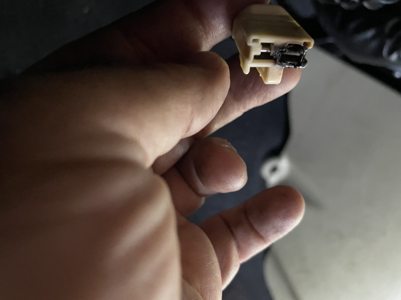

    how do you check the relay? I busted the housing trying to pull it
    but I went to the blower motor and tapped it and got nothing.
    One of the wires going to the blower motor was partially stripped. When I looked closer and pulled the connection it looks like it burned at some point.
    Where do I go from here ?

    Yea that's pretty common for the connector to melt, you will need to replace the connector and blower motor to fix it properly. I have used two spade terminals wrapped in heat shrink in place of a connector to fix them but it's not ideal.
