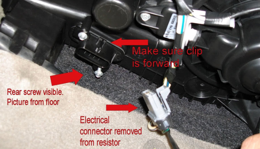

    You may have a blower motor resistor issue if you bang on the blower motor and it starts working. Common 2nd gen issue. Resistor connector is located just to the left of the blower motor connector. Removing the resistor and blowing the dirt off the resistor with a spray can of air often resolved the issue for me on several gen2 tacomas.
    See pic below from 2nd gen posting.

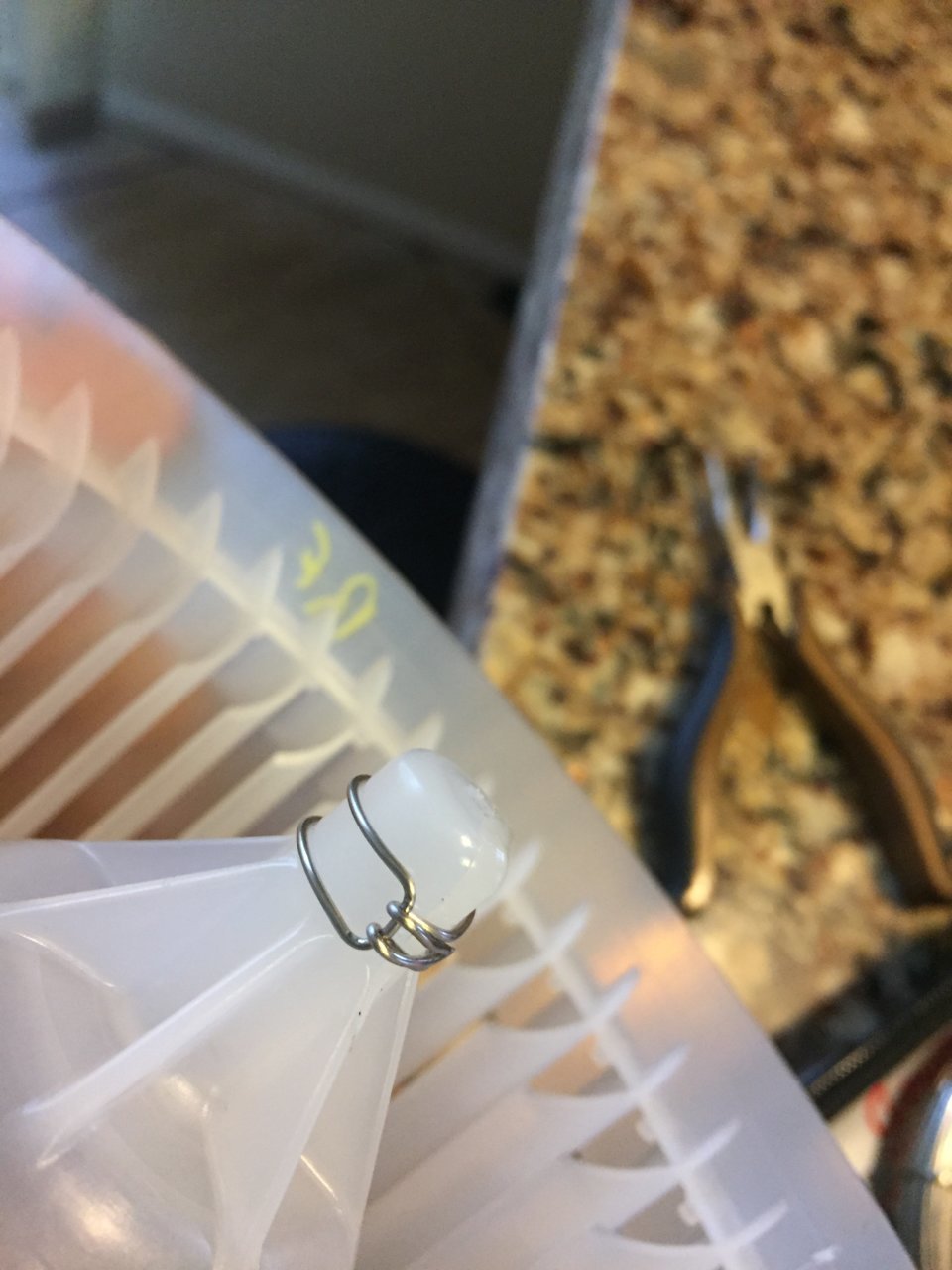

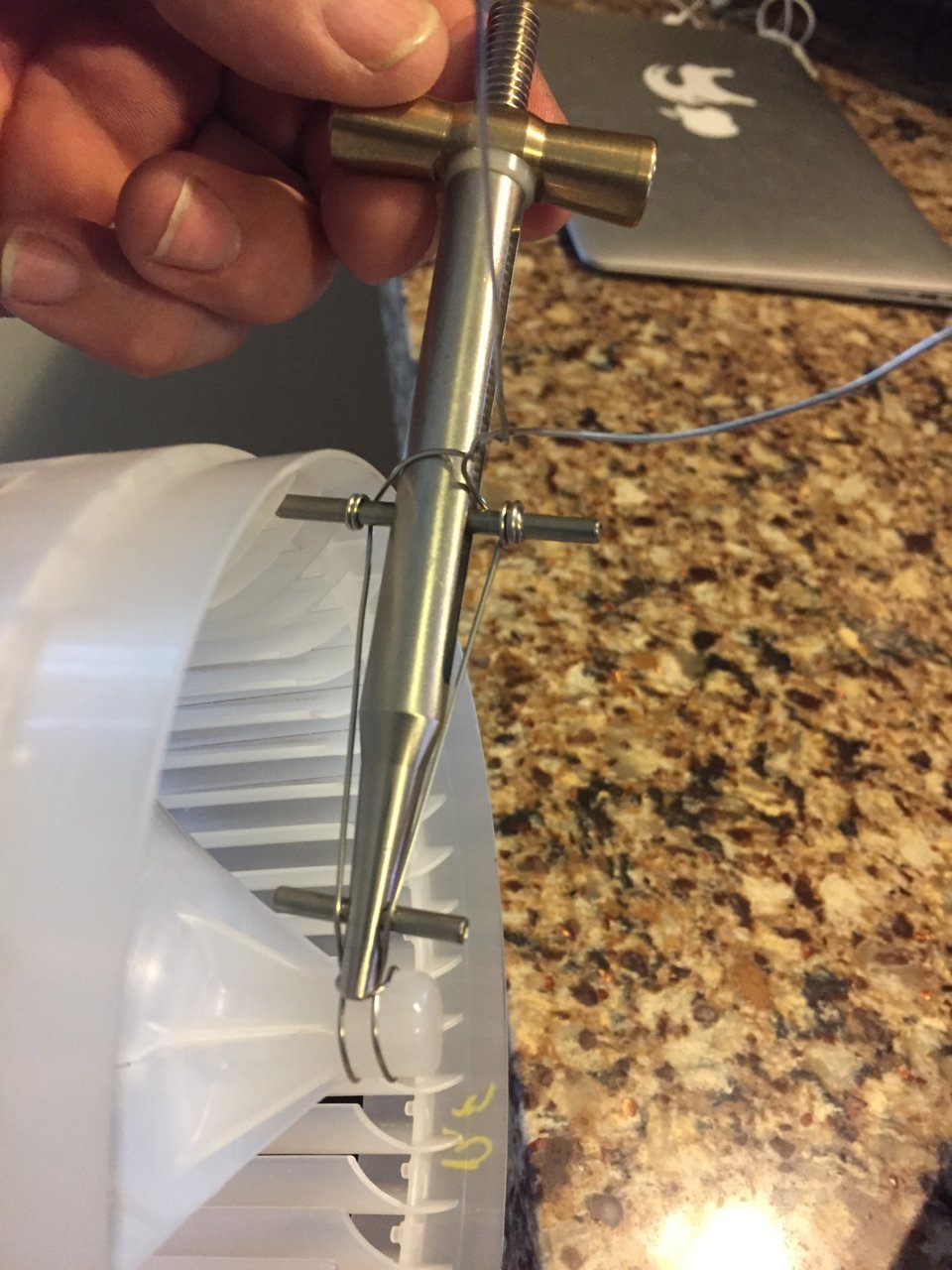

    Mine just went out, not even 10K miles on my '16 but I figured it was going to happen to me like everyone else. Thanks to this forum I knew immediately what it was and just shut off the blower. Looking for parts now from the most expeditious/least expensive source. $193 at Toyota. Seems like quite a lot for a piece of plastic. Yes it's under warranty but the trouble to take it in, drop off, get ride home, wait 2-3 days for them to "diagnose," then a few more to fix, and then figure out a ride back to the place is just too much trouble to be worth getting this done under warranty. While coming up with a new one, I may just use my Clamptite to put a circlage wire tightly around the stem where it broke and use it like that, then as a spare once I get the new part. Pictures, maybe, if I can upload them.

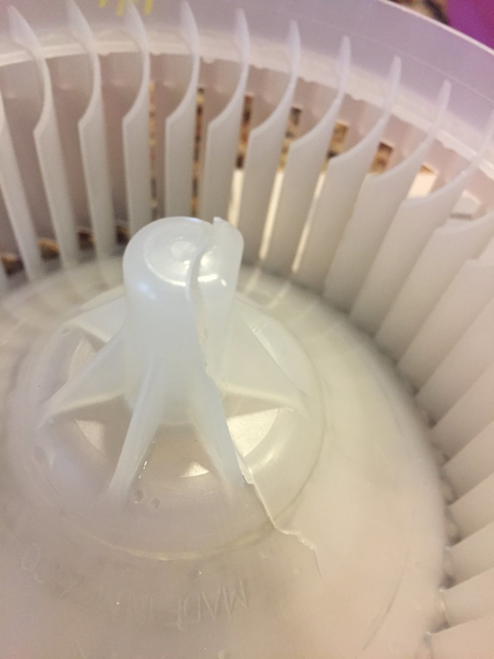

    So I figured out that the price of the unit included the entire fan/motor assembly. Now that's ridiculous! being required to purchase the entire fan motor/squirrel cage fan as a complete assembly. I do have surplus vehicles, I may just get Toyota to replace this under warranty just out of spite. Bastards!!
    I can easily pop the circlage wires off the stem even though they are practically embedded into the plastic, but if it works for a pretty long time until it is more convenient to take it in, then I suppose I will. Really this is simply just wrong on Toyota's part.
