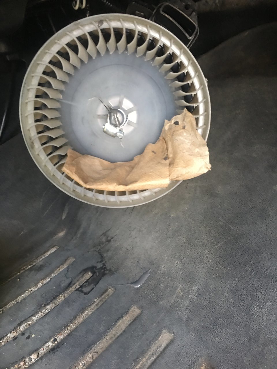

    DF4CA73D-5DEA-45F9-B4CD-94D6C6BDD36D.jpg F21ACF18-9E98-4E1C-8839-C113BE7BE336.jpg Way to go toyota.

    TJstreets--how long ago was this repair done, how has it held up? Looks like some JB cold weld in there as well.
    I do have small hose clamps, just didn't want to use one as it seems it would throw it out of balance more than my Clamptite wire would.
    If I do end up with a new one, or some sort of aftermarket replacement plastic fan, I would like to fashion some form of a reinforcing sleeve, like part of the an appropriately sized bullet casing, or plumbing sleeve from a compression fitting--I used this in the past to repair a dial on an Oster toaster oven that would otherwise have gone into the rubbish. It lasted years until the timer fried.
    I'm certain these are made from the wrong type plastic for the application, and lack appropriate reinforcement. My cage was made in Mexico. Not sure where others are finding theirs were made. It isn't all that difficult to have made these with the type reinforcement I have described. Many other components made from plastic that slip onto a shaft w a flat side to it are made with a metal reinforcement clip: HVAC knobs in Jeep TJ for example. In searching for parts, it seems the '16-'17 have the same part number, but different from other Tacoma models: 87103-04050 Is anyone coming up with other verifiable information/part numbers or interchangeability?

    I just did it I’ll let ya know how it holds up ain’t anyone got time for this BS. I truly expect more from Toyota.
  12. Jul 18, 2018 at 6:49 PM
    #172
    Tjstreets
    Tjstreets Member
    Jan 28, 2017
    #208925
    17
    2017 Quick sand Tacoma TRD
    Lift, bigger shoes, topper
    My thoughts are fairly light weight close to the center should minimize the out of balance if it is too bad I can always clip a fan blade or two to balance it

    clamp not really likely to unbalance it too awful much, it is on the central axis rather on the periphery. I'm going to let mine run for a while w the clamptite wire fix, and consider a lot of other options. One of course being letting them put a new one in at their expense at Toyota even though it tends to inconvenience me.

    I have not seen a Clamptite in decades and your picture reminded me of its handiness. This is a perfect fix. Everyone needs one of these and a spool of wire in their toolbox.
