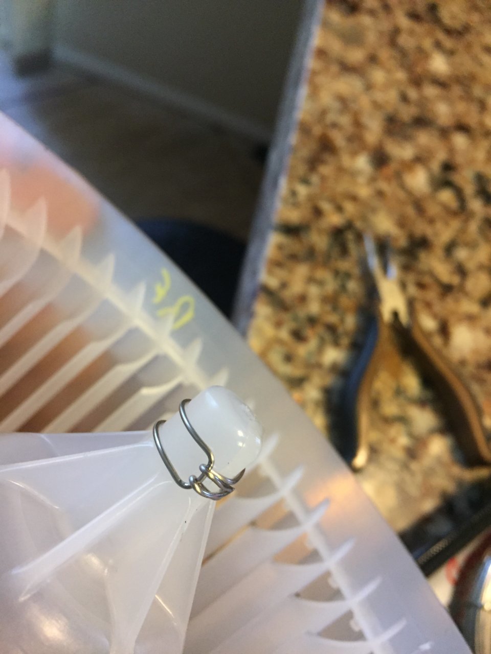

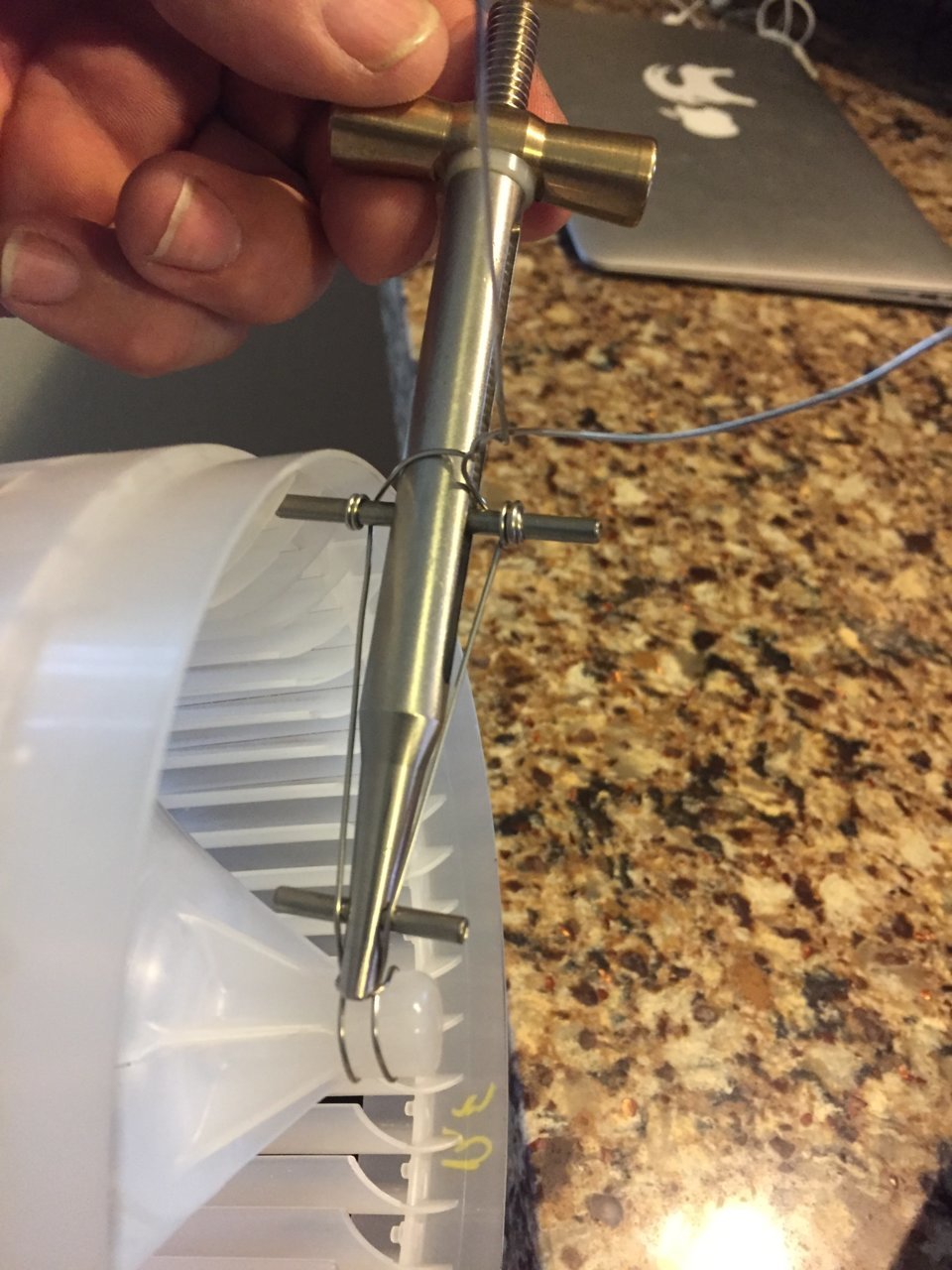

    Good job on the temp repair. It's also good that Toyota has launched a Service Campaign on the faulty fan now, so I'm expecting letters to get sent out to owners. Otherwise, take yours in to at least get on the list. The Service campaign covers vehicles made since Early June of '16 to late August '17 but specifies that it is for vehicles w manual HVAC controls, not for auto HVAC controls, though I am sure that there are auto HVAC owners who have experienced failures. So long as you're inside warranty parameters you should be covered on a repair, but of course no one can be certain they have been upgraded as the old and upgraded fan has the same identical part number.
    For those who end up having to do a fix on their own for whatever reasons, you can also tighten a small hose clamp on or a wire, but other threads have demonstrated that the crack starts at the base of the plastic fan part and moves upwards, rather than starting at the tip and working down towards the motor. Other options:
    It would be better to get a wire around the base though, where the gussets are, but this worked for me until I got mine replaced--before the safety campaign, so I'm sure I'll be going back in for the upgraded part.
