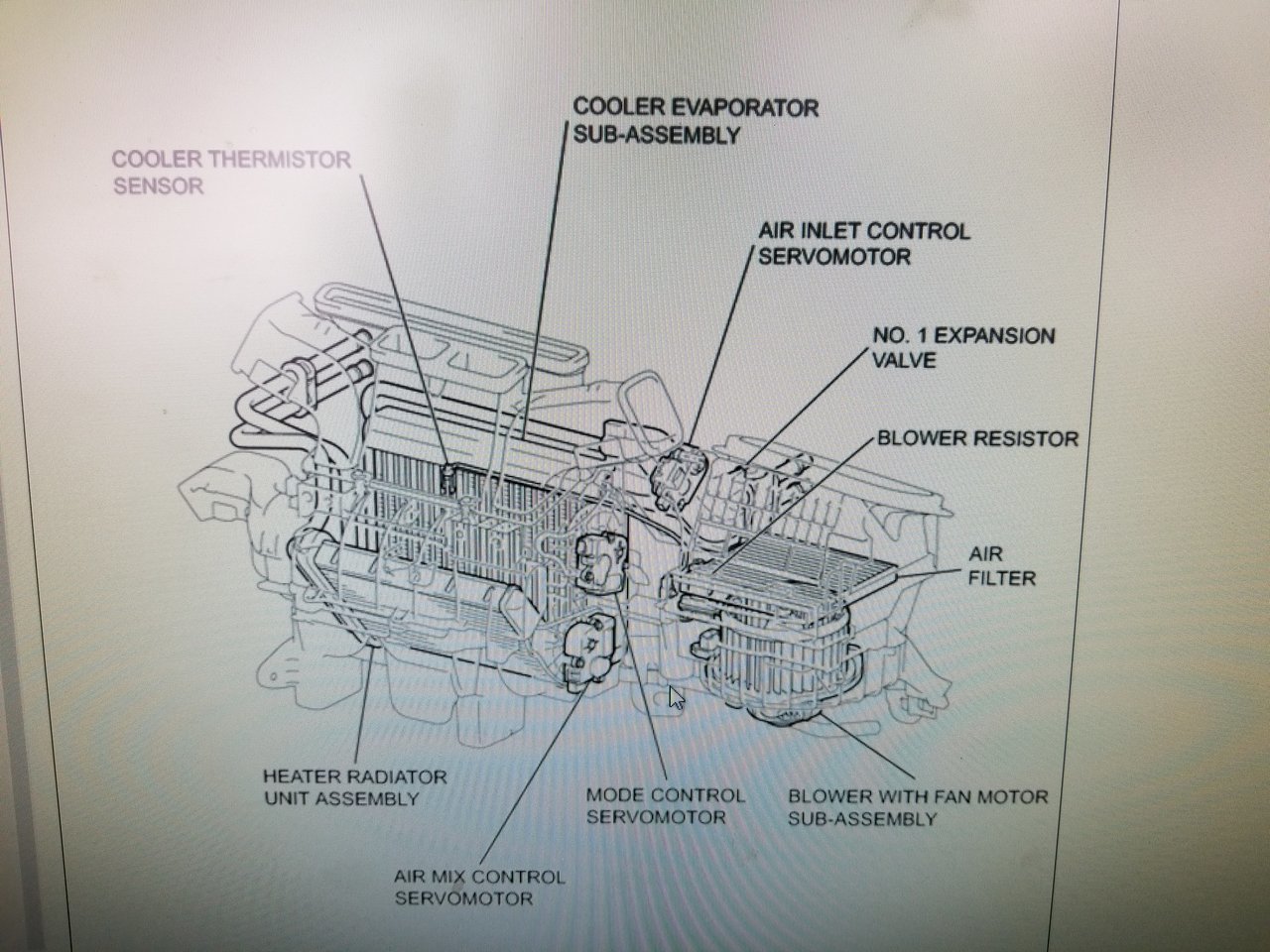

    The clicking noise is the recirculation actuator motor binding up. Common problem with Lexus/Toyota. To confirm condition. Remove the black cover below the glovebox. Press the recirculation button and look for the actuator that's twitching.

    Which black cover are you referring to? I currently have the blower motor removed at the moment. But yeah before that when it would click I could see the air filter twitching it was so rough.

    It's the air inlet control servo motor between the blower housing and cooler evaporator assembly.
