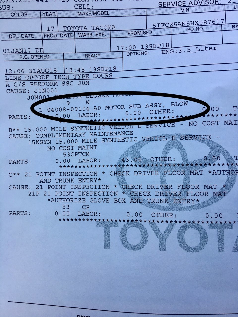

    #200
    mcharfauros
    mcharfauros IG: mcharfauros
    Apr 21, 2017
    #216893
    4,255
    MO
    2017 Black TRD OR DC
    Dumb Truck Thangs
    Just got it changed today.
