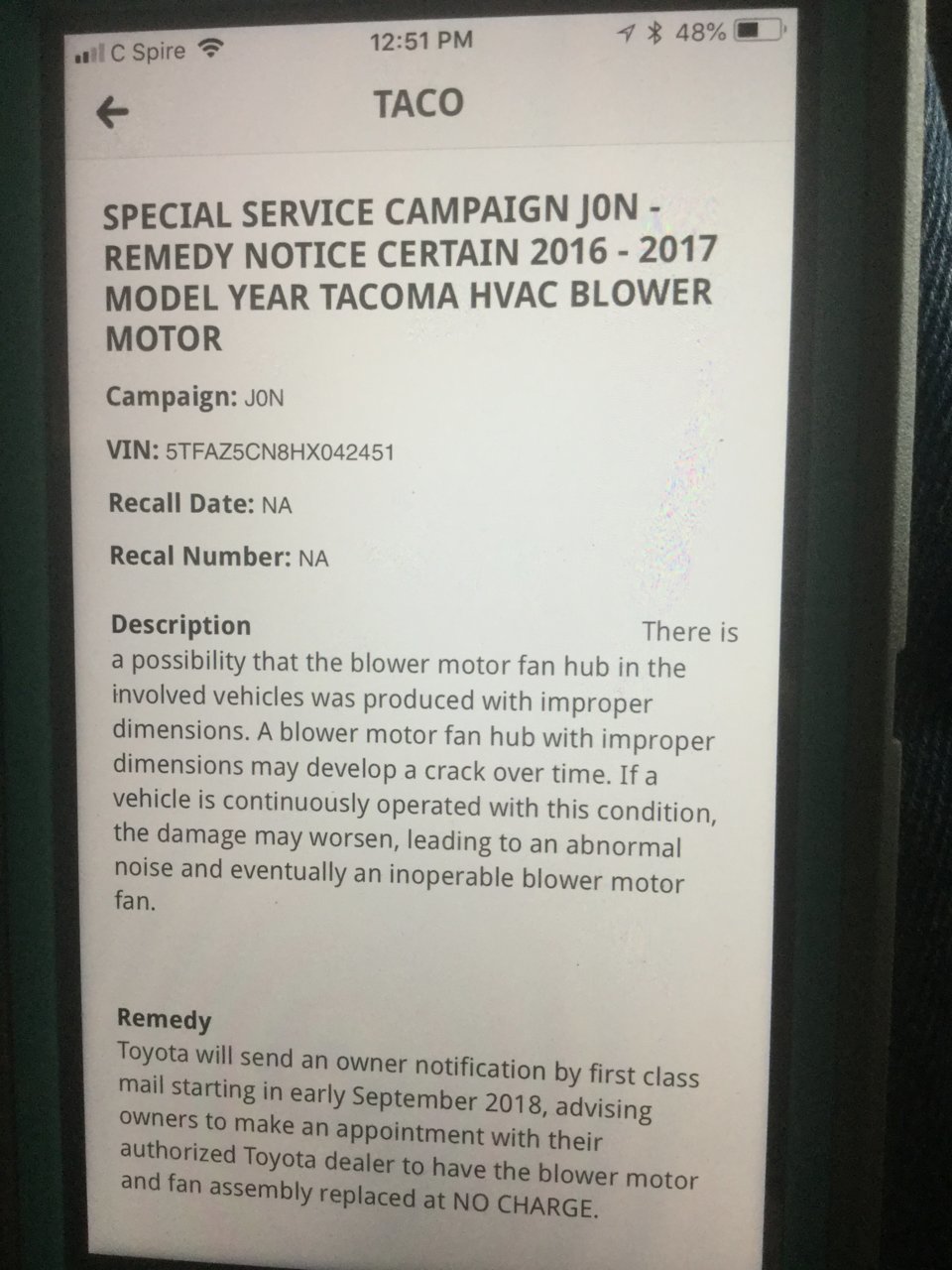

    Make sure you got the new one or it will go out again, apparently. Someone a few posts up posted a pic of the model number for the new one.
  11. Sep 22, 2018 at 10:57 AM
    #231
    Bobmeel
    Bobmeel Bobmeel
    Jun 25, 2017
    #222341
    15
    Bobby
    Petal Ms
    2017 gray tocoma trd sport
    Here it is
