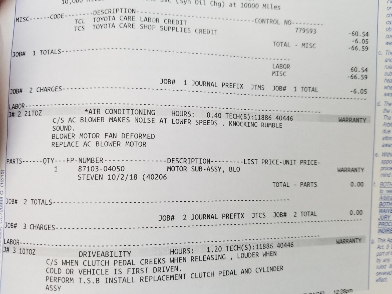

    Weird thing is my 2017 VIN was not covered in this recall. They still changed it under warranty.
    My blower got very noisy and weaker. I thought it had split at the hub, but it was fine. No cracks even. Happened at 10500 miles. It sounded like the fan was wobbling, even though visually it looked fine. The part says MADE IN CHINA. Not sure is that matters. The blower in my 1985 corolla still works fine lol.

    Well @Burro09 quite likely it was replaced w the same, defective original part. Unless you happen to know otherwise......
    Post up a photo of the service paperwork, and we can tell you one way or the other.

    2017 Tacoma TRD Pro Cement MT
    The had plenty of blowers in stock apparently. The new blowers seem to have a big yellow paint mark underneath. Idk if this is the new p/n. Its quiet for now20181105_173248.jpg
